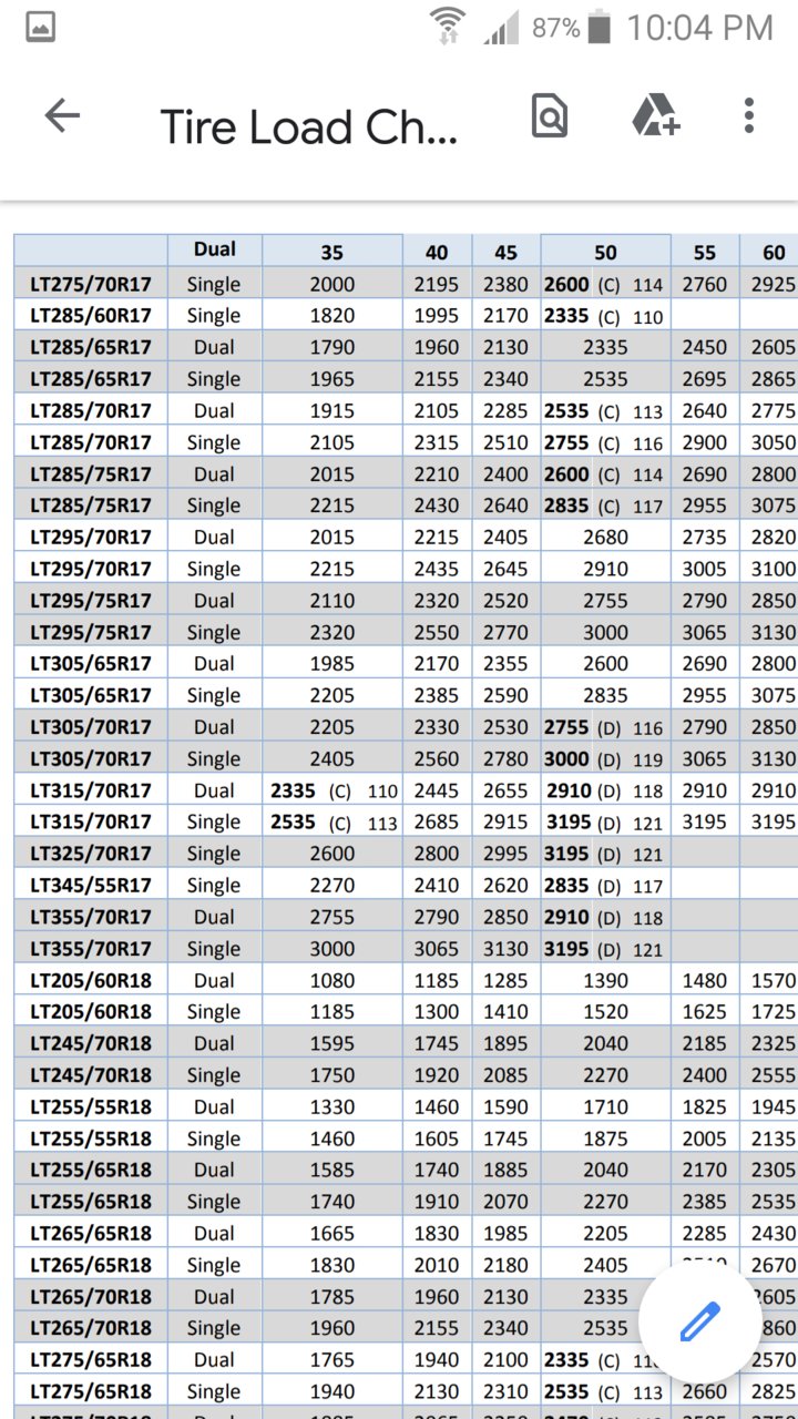

    You are correct; 35 psi is the minimum inflation pressure for LT-metric tires as recommended by the tire mfg/industry standard.
    A LT275/70/17 is right at the edge, as our trucks have an inflated load requirement of 1,954 lbs from LT-metric tires.
    I personally, feel comfortable calculating down to 30 psi by extrapolating a psi value based on the difference between 35 and 40 psi. In the chart below, we see that difference is 5psi=195lbs or 1psi=39lbs. 2,000lbs@35psi - 39lbs=1,961lbs@34psi. My personal recommendation would be 34 psi for a LT275/70/17.
    Let's take a look at a size that is a little 'overkill'; a LT285/75/16. In the chart we see 35psi gives an inflated capacity of 2,130lbs; 176lbs more than the 1,954lbs requirement. The 35-40 psi difference is 210lbs for 5psi, or 42lbs per 1psi. So it has an extrapolated load inflation of 1,962lbs @ 31 psi.
    As I said, this is what I personally feel comfortable doing and recommend caution if using the 'extrapolated method'. This is because the charts are non-linear; it won't always have the same value per psi. In the LT285/75/16 chart, we see:
    35-40psi=210lbs or 1psi=42lbs
    40-45psi=200lbs or 1psi=40lbs
    45-50psi=215lbs or 1psi=43lbs
    50-55psi=170lbs or 1psi=34lbs
    ...and so on.
    In either example, it is nowhere near the "1,000lbs of overkill per tire" as you alluded to. It would have to be a size that is ridiculously voluminous for that to occur at 35psi; like a LT345/70/16.

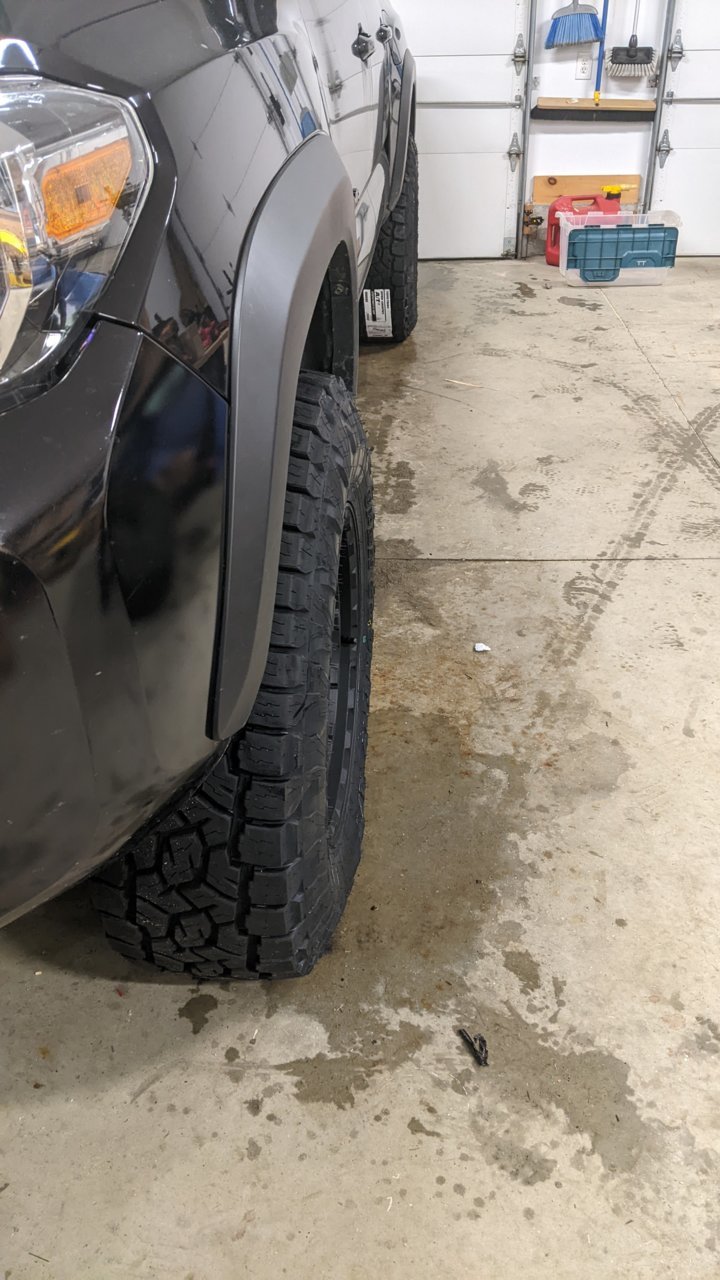

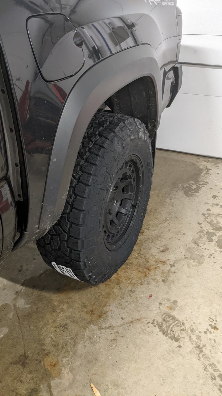

  15. Apr 29, 2022 at 7:48 AM
    #1555
    Sleddog0311
    Sleddog0311 Active Member
    Aug 8, 2021
    #373540
    41
    Black 2020 DCSB TRD OR
    Barricade HD rear bumper, Cali-raised smoked rear LED lights, Black Rhino (Chamber) black 17x8.5, 0 offset, 4.75 backspace wheels, Toyo Open County AT III 275x70R17
    Not the greatest but here ya go!
