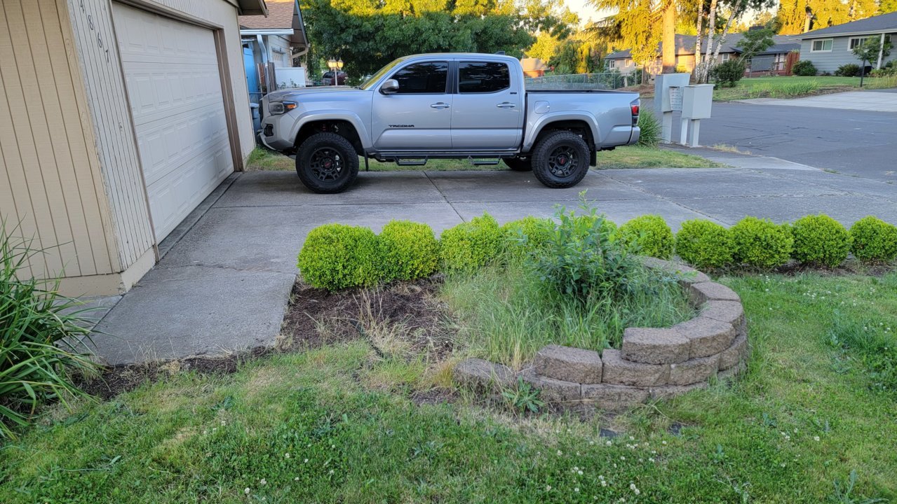

    275/70/17 KO2
    Method 305 NV Double black - 0 offset
    Stock - No lift (slight rub)
    Will be installing Eibach stage 2 with 1in rear block soon.
    Update:
    With the eibach lift and 1in rear block.

    how did u get 3 inches with 5100 set to 0?

    are you on the top perch, 3"?
