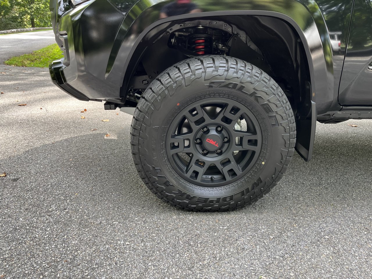

    I’m running 265 / 70 / 17 Falken Wildpeaks at3w on my stock / no lift 2022 TRD off road. You think I will rub if I jump into 275 70 17 Falkens on stock?

    It depends a lot on your wheel width and offset. What wheels do you have?

    it probably will a little bit -nothing serious .... guy online(youtube) did it to his taco and 4runner with 275 k02s -same wheels "sema" trd 4runner wheels ... he said 4runner didn't rub but the taco did slightly ... he said there was some minor cutting .... just make sure to do alignment and fix the caster .... my research show most likely you will be fine .... u will lose the mud-flaps

    I run the TRD pro Sema Wheels with 275-70-17 Falken wp at3w and they do not rub at all. But I also have a TRD lift kit which I don't think actually changes anything, just makes it look better. Also use oem mud flaps
    If ur running stock +25mm offset wheels, yes you will rub

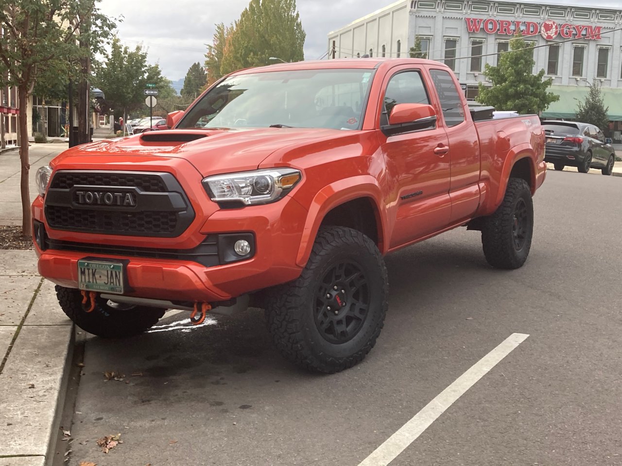

    Just had RRW RR2-V’s in 17x8.5 +0 with 275/70R17 Nitto Ridge Grapplers installed today. I have the Eibach Pro struts installed in the front set at 1”. So far I’m super happy with the setup, no rubbing at full lock in forward or reverse even into the driveway. I’ll grab some better pictures later on.
