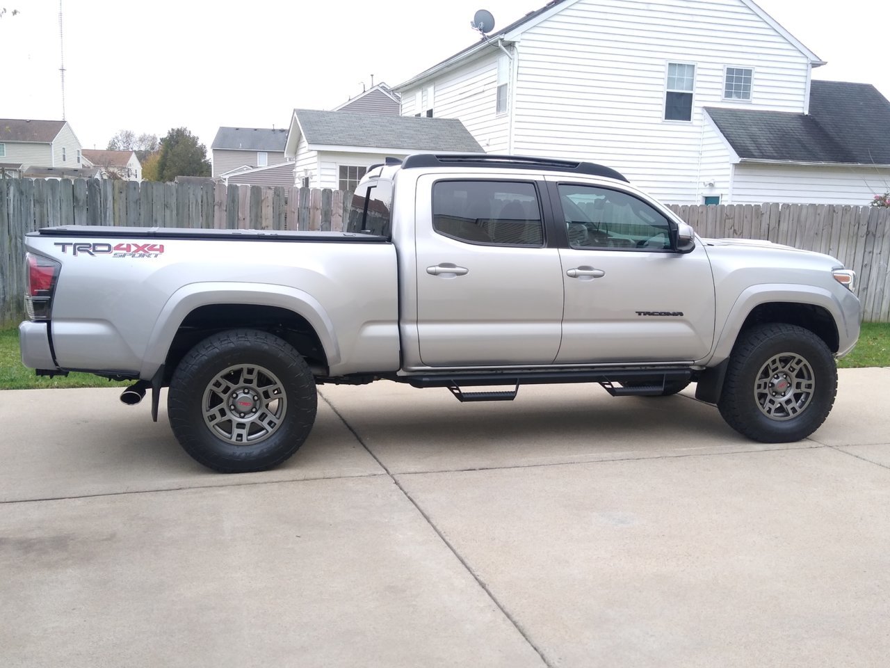

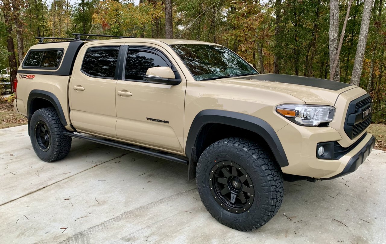

    For those on the fence of 275 / 285, because the weight and load ratings of most options in each size, take a look at the Maxxis Razr A/T.
    https://www.tacomaworld.com/threads/maxxis-razr-at-in-e-and-sl.687907/
    No 275 option, but they do offer a P rated 285. Strength wise it’ll fit the bill for 98% of Tacoma owners, they weigh a confirmed ~45lbs, and they run a tad small for a 285.
    All said, here they are on my Taco with mudflaps that’s running 2nd Gen Pro suspension (essentially Taco tuned non-adjustable Bilstien 6112/5160) and a 3leaf AAL. Netting ~1” lift up front.
    *disclaimer* I do have a mild CMC. This was done prior to these tires and I do not think it would be mandatory for full cycle on my rig. I do get some minor fender rubbing when really cycling hard on the suspension. Nothing that I care about or encounter daily.

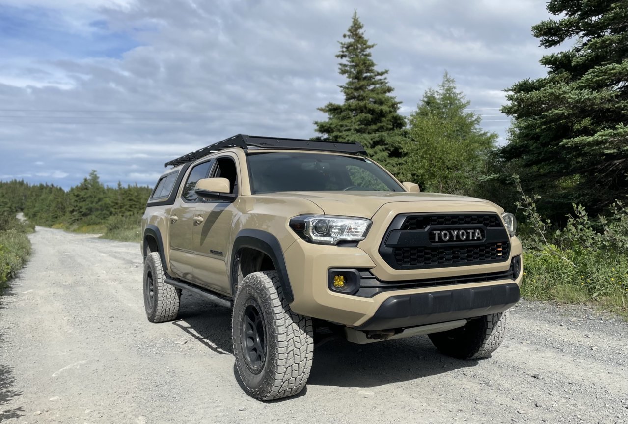

    128
    Newfoundland Canada
    14 DCSB TRD Sport 6SPD MGM
    N-fab w/ IPF 968, TRD cat back, 285 & 265 duratracs, pro comp 7036. leer xl

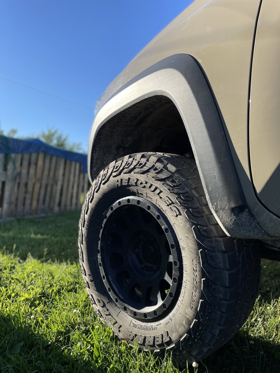

    The Hercules X-venture is a great option as well @ 49.1lbs 275/70-17

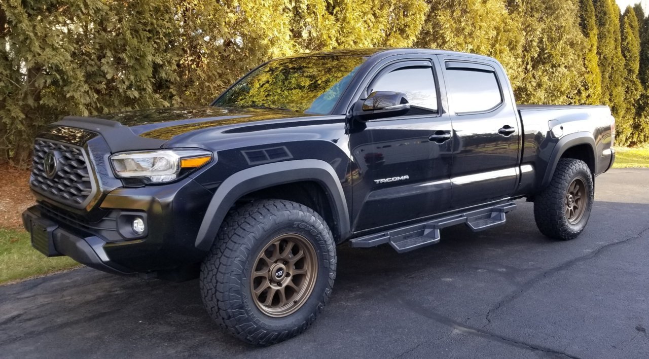

    Los Angeles
    2022 7545E
    I’ll need to get better pics.

    FN Wheels Five Star
    Diameter: 17"
    Width: 8.5"
    Offset: -6mm
    Backspacing: 4.5"
    PCD: 6x139.7
    Load rating: 955KG (2,100lbs+ per wheel)
    Weight: 22lbs
    Color: Light Gunmetal
    Falken Wildpeaks AT3W 275/70 17 C
    Bilstein 6112 combo / 5160 w/ 2” block
    bjoew[QUOTED] likes this.

  17. Dec 14, 2022 at 10:54 AM
    #1637
    venezian
    venezian Well-Known Member
    Dec 8, 2015
    #171740
    1,138
    Los Angeles
    2022 7545E
    No, they don't rub, but any bigger and they would likely rub on the front so you'd have to cut the bottom "wing" off the front bumper or use a heat gun to push the plastic liner away.
    I have a demello bumper that I need to install so I’m not worried about the occasional rub wheeling out of a target parking lot.
    I can’t really say too much to the comfort. I was very methodical with my choices. The wheels I got were lighter than OE, but the tires are heavier. So it’s almost a wash with regard to weight.
    as for butt dyno, yes I feel the difference between the GY tires and the Falkens, but that’s expected and I’m very happy with the ride.
    for the suspension, IMO is the best money you can spend for an upgrade. The ride is just as good considering the increased height. I always prefer the soft but firm ride if that makes sense.
    Since I don’t plan on adding weight to the back, I went with blocks. AAL would make the rear too stiff for my liking. I also like the OE rake so I went with 2” blocks.
    I still struggle with the math on the offsets and BS lol. -38 seems excessive.
    If I’m right, you’re -10 ones should be nearly identical to my setup and I would guess the 285s will definitely rub unless you cut the bumper.
    Overall, I’m very happy with the setup, ride and looks.
