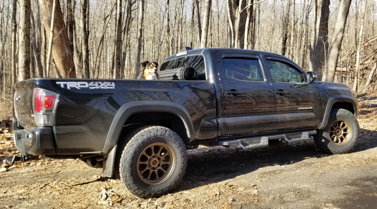

    Decided to swap the VTX center cap metal stickers for these with the TRD logo.
    First impression on the 275/70R17 Toyos are that they are louder than the stock OR Goodyear kevlar tires on the road, and they make a sort of mid to high pitch noise on the highway. I'm running them at about 35 psi, and I'm still going to experiment at slightly lower and also higher air pressure ranges to see the effect on ride quality.

    With the 275/70R17 tires and stock height (no lift), you will likely need to remove the front mud flaps, take a heat gun to the plastic fender wells behind the front tires, and trim and shift the fender well forward in front of the tires. I still get minor rubbing, so I will probably be pulling the liner back to hammer over the pinch welds when we get some better weather here - that will allow me to push the fender liner further back using the heat gun. Also note, the Falken Wildpeaks in that size are 32.4" diameter, while the BFG K02 and Toyo are 32.2" diameter, so fitting the Falkens without the lift might take more work. I'd be curious to hear reports on how much road noise the BFG K02s make in comparison to the Toyos.

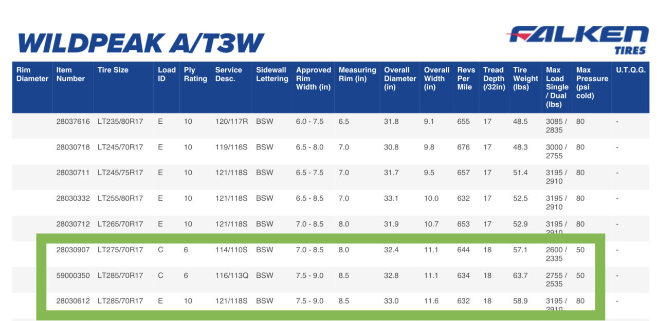

    I’ve been trying to understand why the 275/70r17 Falken Wildpeaks are as heavy as they are, at 57.1lb, for a load C rating.
    The 285/70r17, in load C, are actually 4.8lbs heavier than the same size in 10 ply load E. How can that be? My tire knowledge is limited so please help me out on what I’m missing here.

    Look at the spec for the actual sizes. I know for the 275/70R17 the Falkens were 32.4" versus most other brands being 32.2". There's probably other factors that affect the weight as well. The 7 lb difference between the Falkens and the Toyos was the reason I went with the Toyos and some of the lightest weight 17" wheels I could find. Look at other brands if weight is a concern for you.

    I noticed that too. That’s why I went with 255/80/17 wildpeaks E rated at 52 pounds.
    Must be the materials they use.

    It makes sense that different brands will be lighter or heavier due to construction, materials, etc. What I don’t understand is how the E rated 285s, vs. the C, are larger in diameter, wider, have more plys, and are nearly 5 lbs lighter. There must be more going on in Falken’s load C construction that is also present in the 275/70.
    I’ve reached out to Falken for some more detailed info, but you know how that goes.

    From Falken regarding the C Load 285/70r17 A/T3W weighing more than the E:
    I asked for a little more info on the performance characteristics of the C Load Wildpeaks:

    Interesting.
    Still don’t understand why C 285s weigh more than E.
    And how an E rated tire will “provide more traction” Hmmmmm
