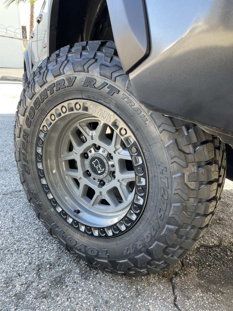

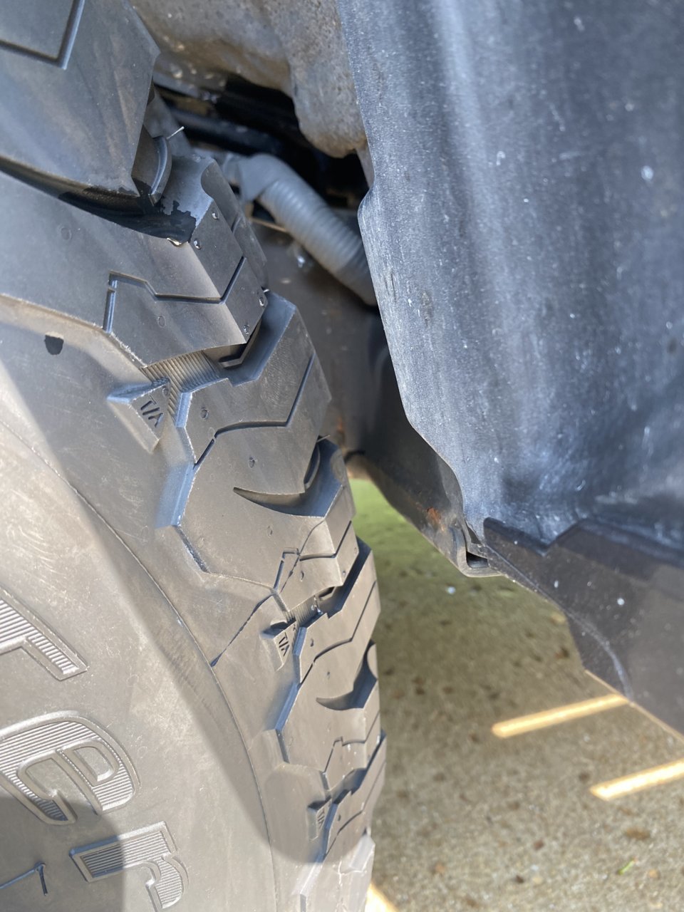

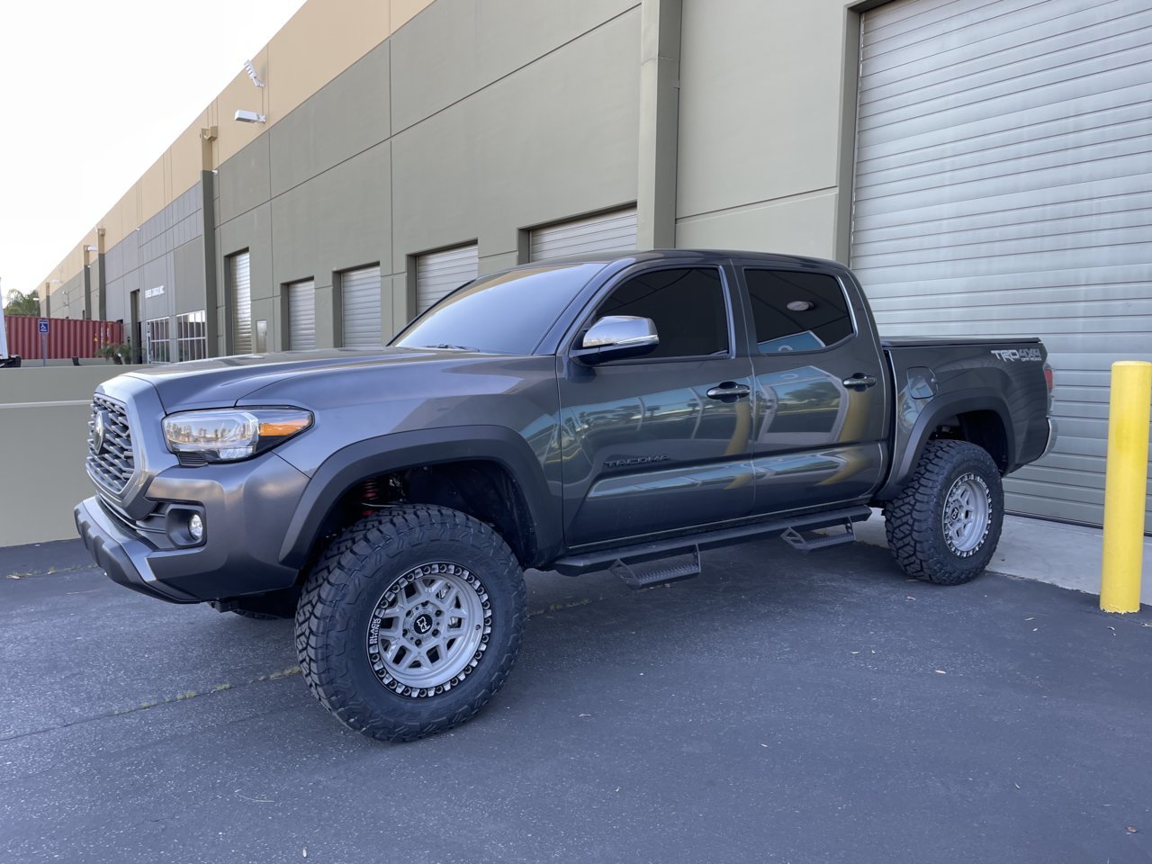

    45B62481-8B0F-425E-8007-2C70DA3AA1F1.jpg 6C4C9783-543F-4193-8769-16501DCB2ACA.jpg 7BB16FC9-AB81-4F5A-96A5-216657E9F023.jpg 45B62481-8B0F-425E-8007-2C70DA3AA1F1.jpg 275/70/17 Toyo RT Trail’s wheels are 17x9 0 offset. 2” TRD lift. Absolutely zero trimming or rubbing at all in full lock. Big bumps etc. Tires are for sale! Have receipt. Just installed on 3-25-23. Wanna go 285’s. 200 miles on them as of 3-26-23 located in Torrance, CA

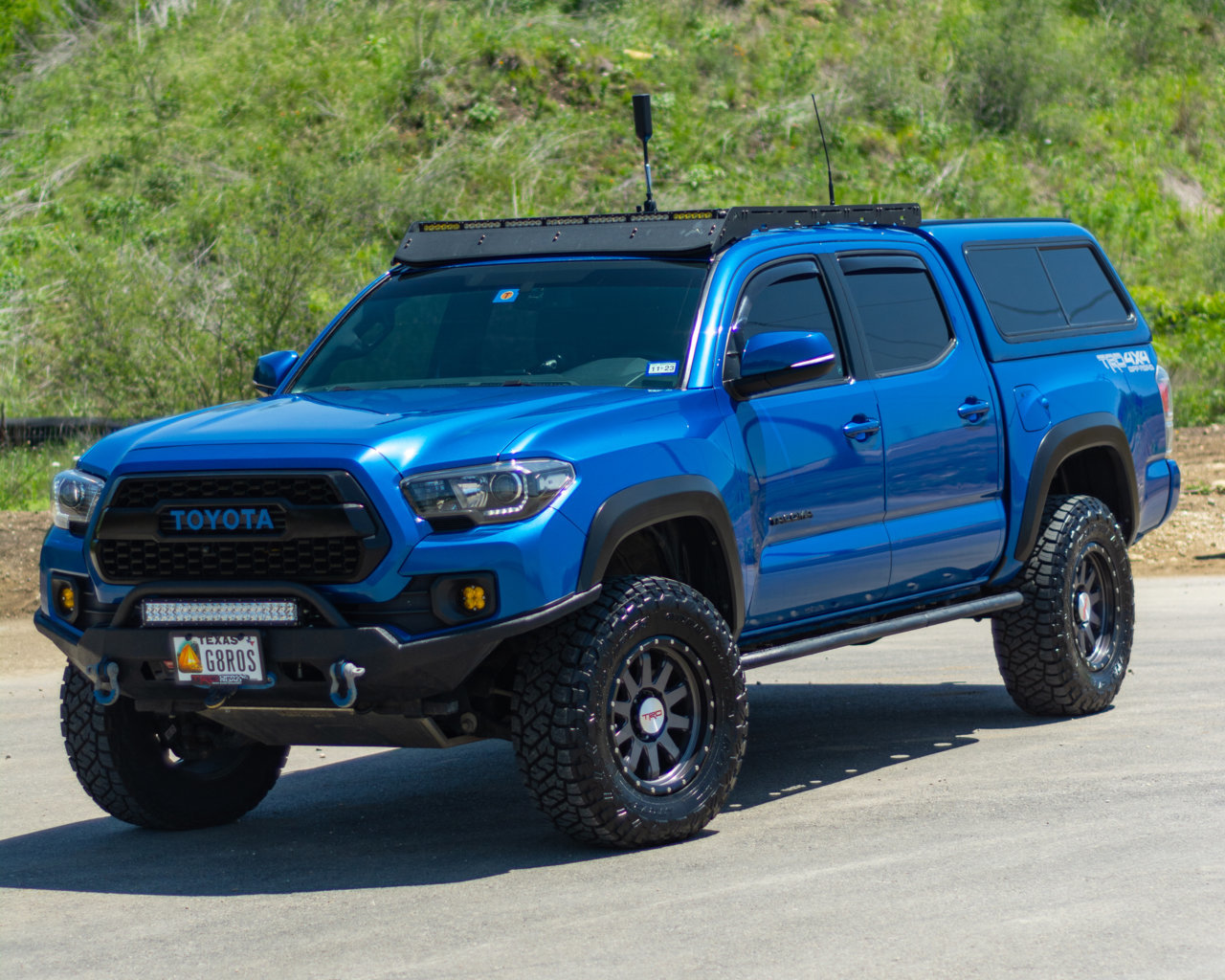

    Cleaned her up this week, pretty satisfied with the 275s even though they look less aggressive than the 285 STT Pros. MPGs are slightly up and noise levels are down though, so mission accomplished.

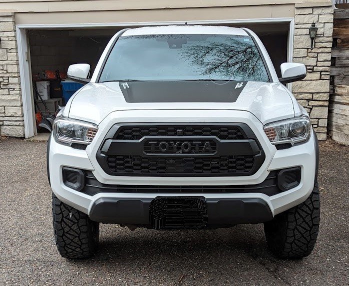

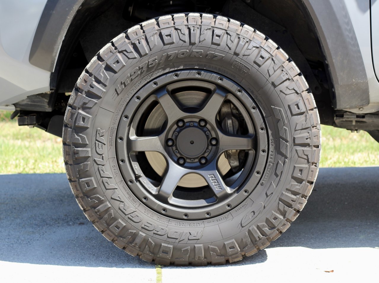

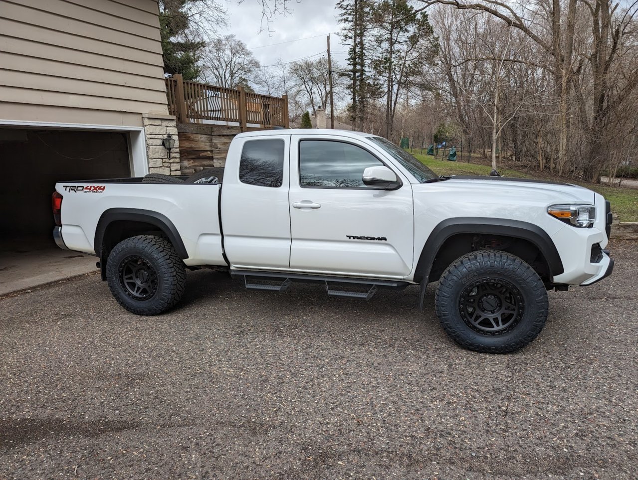

    Just got home from Discount Tire where I got Nitto Ridge Grapplers in 275/70/70 on my Method 312 Double Black rims. Only thing else done to the truck is a TRD lift kit for now. Was tempted to go 285 to get C load Ridge Grapplers but between limited height in my garage and the risk of having to do a CMC I did the 275s

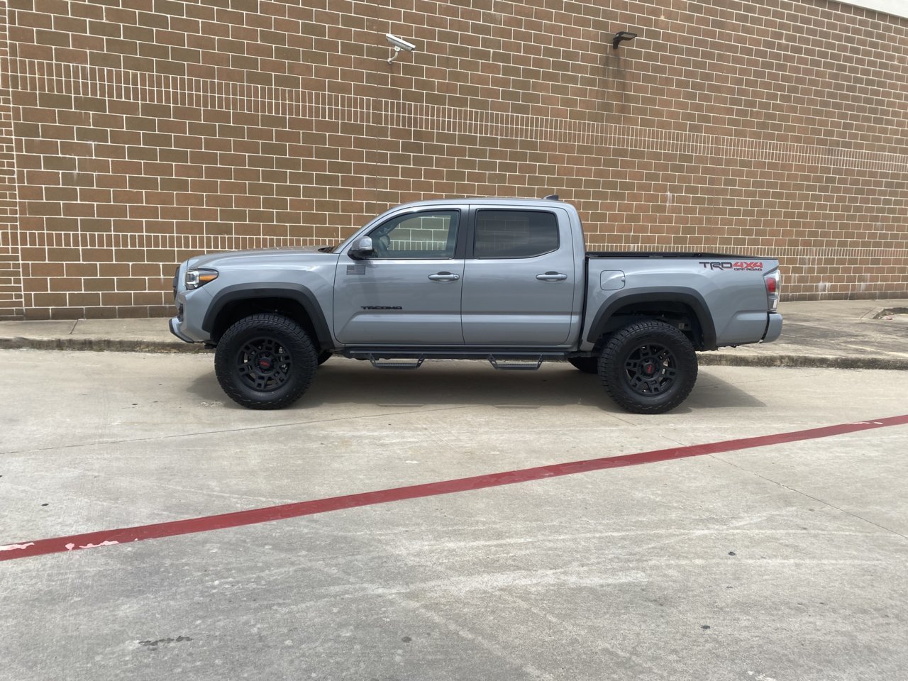

    Falken Wildpeaks 275/70/17

    How much has the acceleration changed with those tires? Is your ECU tuned?

    Definitely more sluggish overall and a longer lag to get going compared to stock. After a couple of weeks I got the OTT tune and it was a game changer. Acceleration was back (if not better), shift points were corrected, lag was almost completely gone and got about +1 mpgs back. Highly recommend the OTT tune

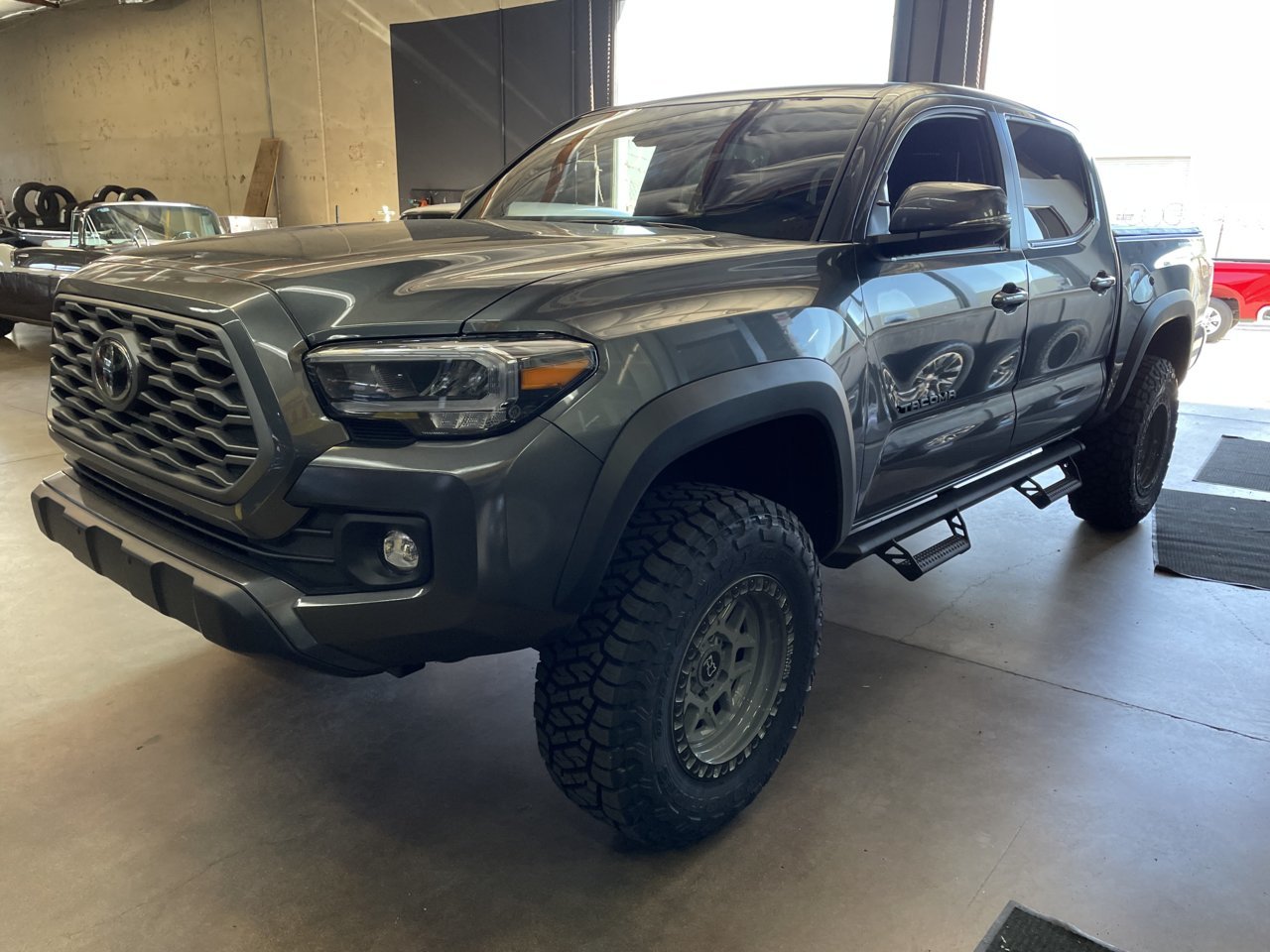

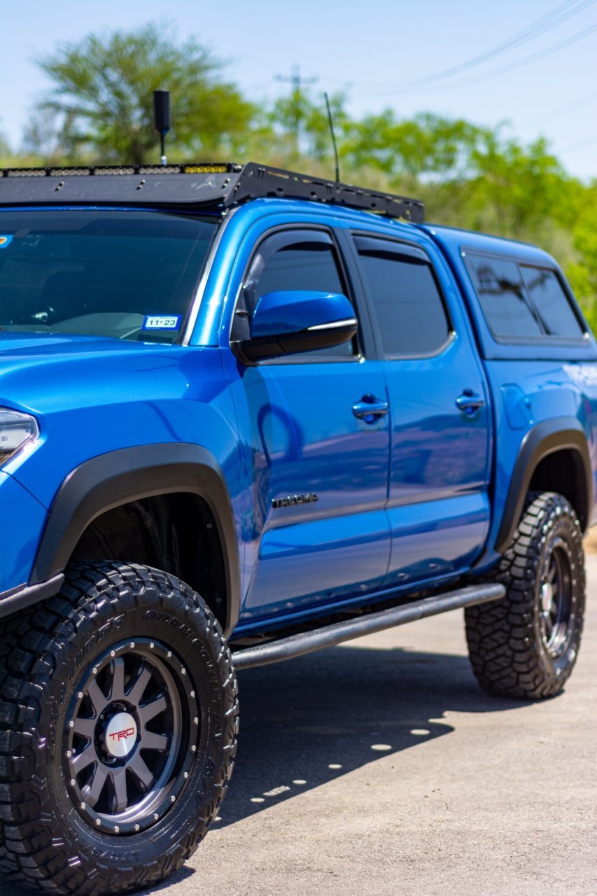

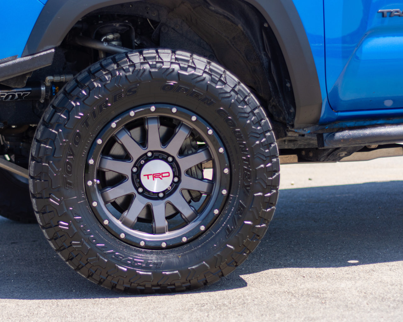

    275/70-17 Toyo Open Country RT Trails
    Came out awesome, plenty of clearance weight was only 3lbs more per tire than 265/70s but quite a bit lighter than 285s. These were running close to 32.5 mounted. Fox 2.5 DSCs Rxt leaf pack option 1

    whats the offset on your wheels?
    no rub? I know 285’s uca clearance is an issue keeping stock wheels. How does this compare?

    On those wheels they were -6 offset and 275's. I have different wheels at -25 offset, 285's and a CMC with wescott front and stage 1 deavers leafs. It only rubbed on front plastic and never the uca.

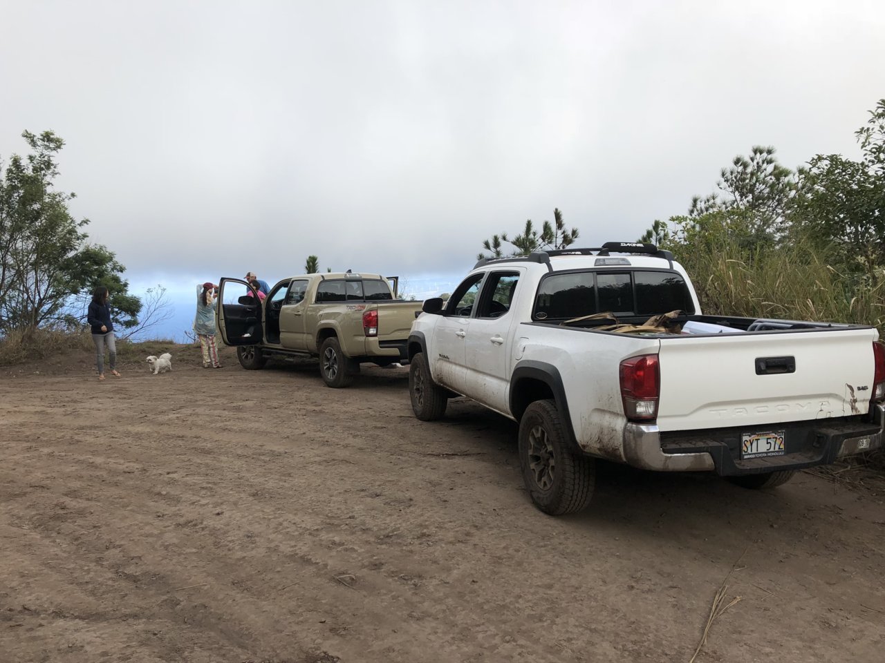

    Aloha all - so finally ready to change out stock tires/wheels with 25k miles on my metallic 2019 Mahalo's posters, this thread been helpful. Wildpeaks 275 70r17 seem to be a wise choice. DEFINITELY installing BILSTEIN LEVELING Kit. This my second OR, and over the stock wheels. SCS F5 MATTE BLACK gets the nod. Hope to posting some pics soon. Sharing a local destination Peacock Flats Waianae Mtn Range

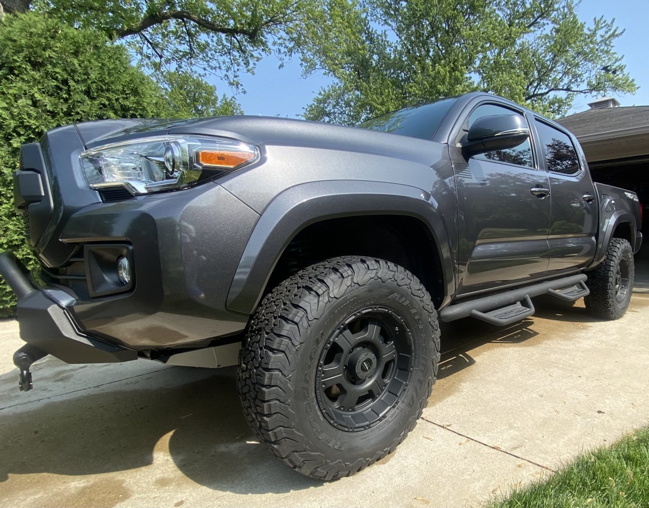

    Couldn’t justify in my head to put a 63lb tire on. So I stepped up to 285 KO’s @ 51lbs LR-C. I had a good alignement, No CMC needed, only trimmed the front plastic.

    Falken lists the 275 70r17 @ 57lbs - but the tire weight is not a concern for me. BUT the question is - with no lift, how are you not hitting the well while off road... doesn't seem to have much travel clearance from what I can tell.

    Whoops, my Bad I do have a lift little over 2”. I measure 22.3/4 from ctr hub to bottom of fender
