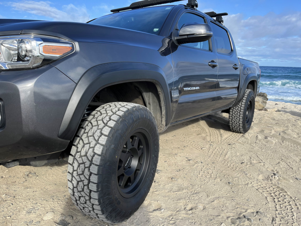

    Toyo Open Country AT3 275 70r17
    Method MR701 matte black
    Bilstein 5100 all around. Eibach front coils.
    Very pleased with the results. Props to Mod Industries Kalihi
    IMG_2200.jpg Toyo Open Country AT3 275 70r17

    The perfect size IMO if you no like exceeding 2" and still getting good ground clearance ... I have 5100's and Eibach coils and I'm level with no rubs. Tires are 1.5 inches higher and only .5 in wider from my stock 265 70r16 . Excellent off road ride.. kine look

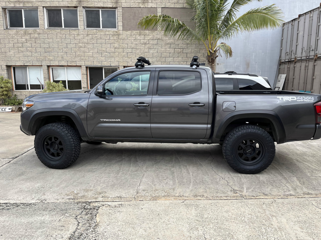

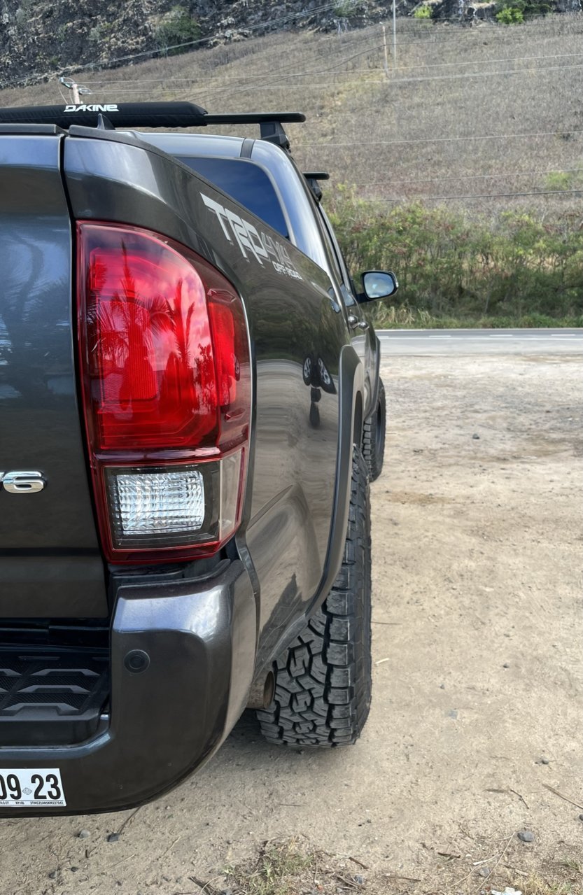

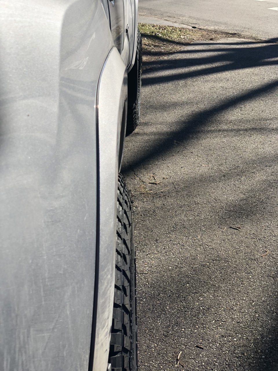

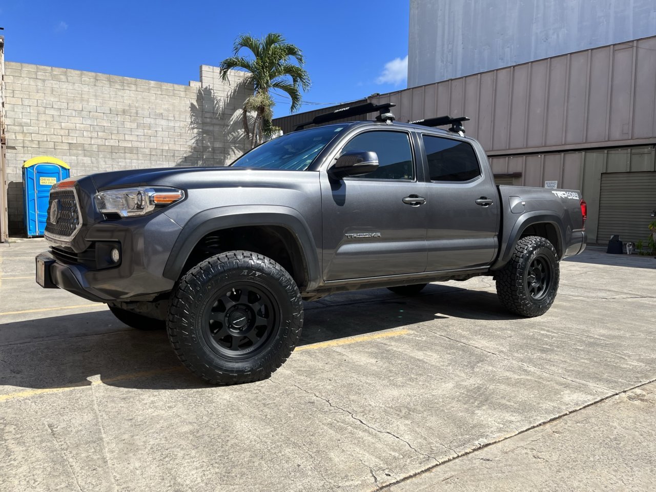

    I'll add a few more comments from my original reply. I was really torn between the 275 and going 285. With work from home my truck no longer a daily driver so I was willing to sacrifice things like mileage for bigger tires but it had to make sense. Ultimately I landed on 275 mostly to avoid CMC and in researching tires there was a big weight difference between the 275 and 285 I was looking at.
    I wish I took pics at the shop. Someone had a set of the same toyo open country rt trail but in 285/70-17 ready to put on their T4r. We put them side by side with my 275/70-17 RT Trails was less than .5 inch height between the two closer to .25 .3 inch and the 285 was just a hair wider. The big kicker was it came in 6lbs per tire heavier. So it was a big weight sacrifice for minimal gain in height and width. That pretty much left me without regret for not going 285.
    I do think now there are a few more options in the 275 tire size like the open country at3 and rt trail it's a great option to look at over 285/70-17. Still get almost all the benefit of bigger tire but at a weight savings along with possibly avoiding a cmc depending on your wheel offset uca choice and alignment.
    Few more pics. Still adding some weight and lift is still pretty new and settling a bit. Trans skid and sliders will help settle it a bit more then same for the gfc next year
    20230716_192006.jpg 20230617_124227.jpg 20230717_144226.jpg 20230618_081350.jpg

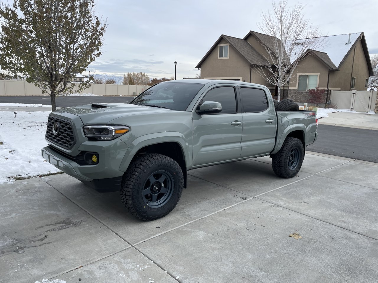

    ‘23 DCSB TRD Off-Road 4x4

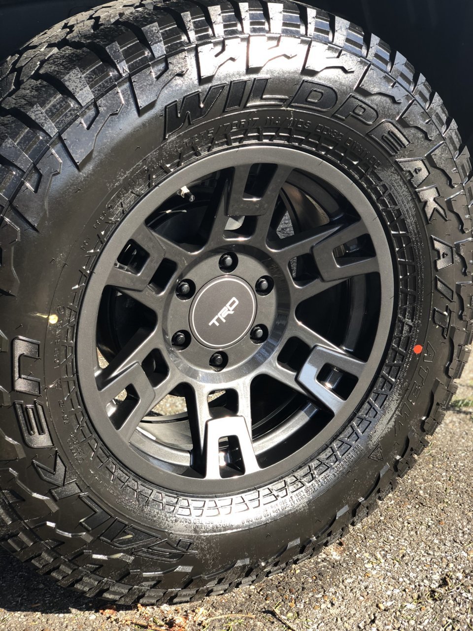

    Stoked I went with the 275/70r17s courtesy of this thread a few months back. Zero rubbing issues for me with the 4Runner Pro wheels and Falken’s.

    You nailed it - looks great.. what shocks and springs ?
  10. Aug 24, 2023 at 3:38 PM
    #1730
    2023TRDOffroad
    2023TRDOffroad Well-Known Member
    Jan 26, 2023
    #416450
    87
    California
    Thanks man! I got the TRD lift when I bought it for $2k installed. Wanted the pro grill anyways, 3 year warranty was nice, and honestly I just didn’t want the hours of research to find the better (and cheaper) option. Real happy with it though! Smooth on road and nice on the dirt roads I take it on for camping/hiking in the National Forests nearby.

    A lot will have to do with your choice in wheels. If you get ones with a lot of negative offset (poke), you will likely rub. The 4Runner wheels that I have don’t rub with 275’s, but they are pretty much flush with the body and only 7” wide.

    I’m not sure. I hear the 0 offset are a good option. I think the 4Runner SEMA wheels I run are +15mm, so a little more tucked in that zero offset, but not as tucked as the stock OffRoad wheels.
    You may end up with some very minor but manageable rubbing.
