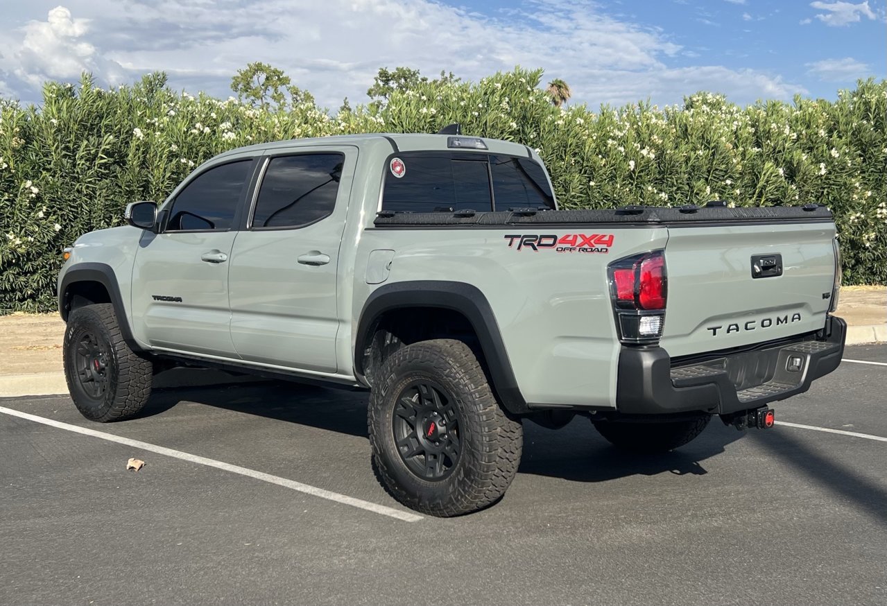

    What shell is that!?
    :hungry:

    Anyone know the brand of this shell?
    Edit: Google wizard camera search.
    Answered my own question.
    Brand = Snugtop GB Sport

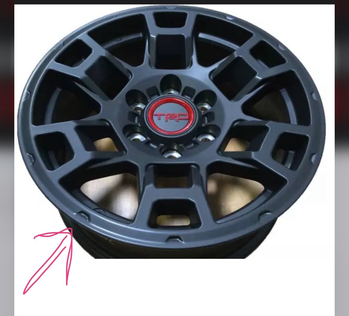

    I’m not sure what year the newest version of the 4Runner Pro wheel was introduced (2021?). They have the wrong bore diameter to fit over our Tacoma drums.
    They are easy to spot as they have little dimples around the outer edge and are more busy and square looking.
    You do not want these 4Runner Pro wheels (note dimples around outer edge):
    https://parts.markville.com/oem-par...jVx2512H8_NEDCiXlXNTrPBetQWHeT0kaAv9lEALw_wcB

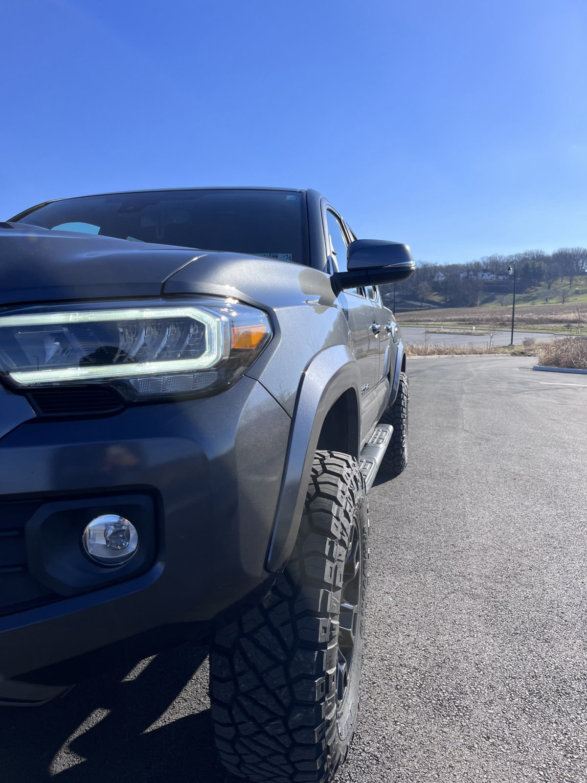

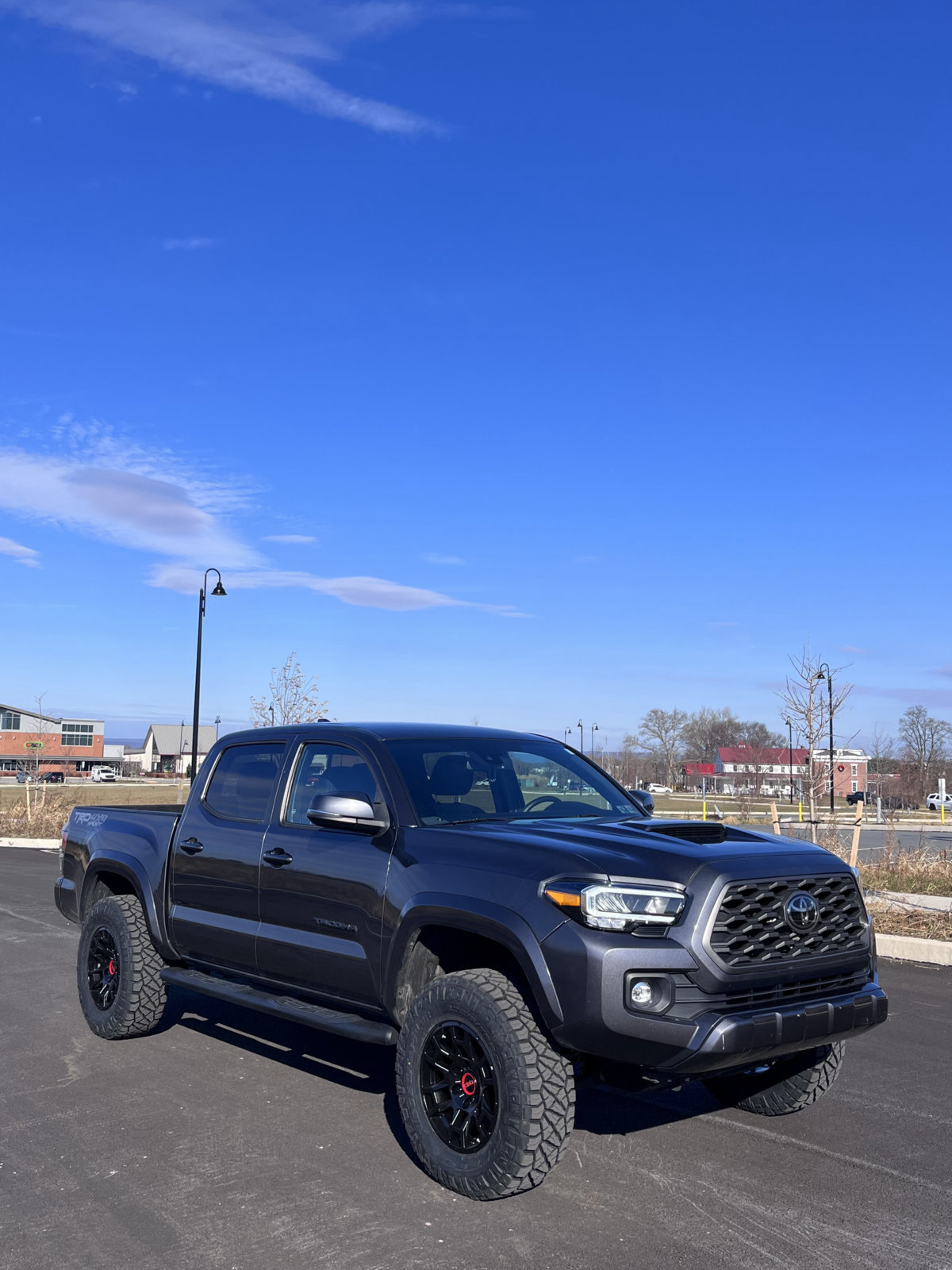

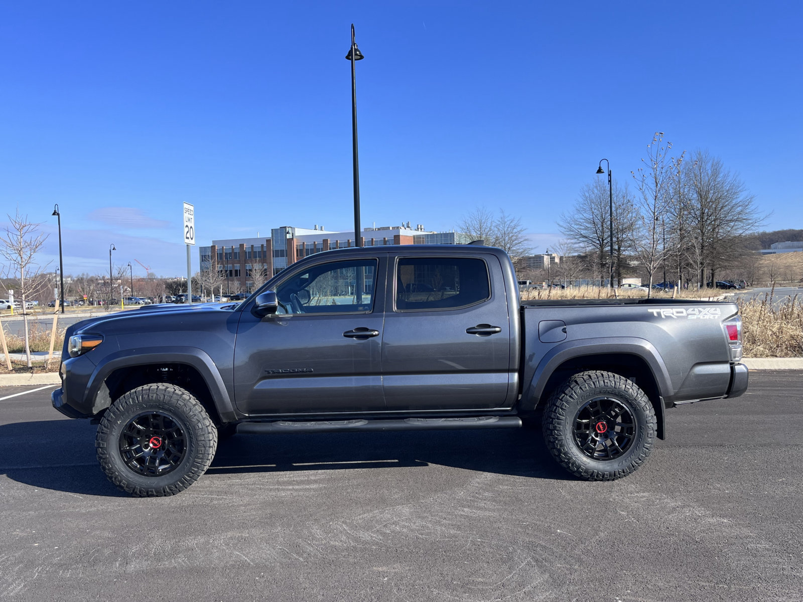

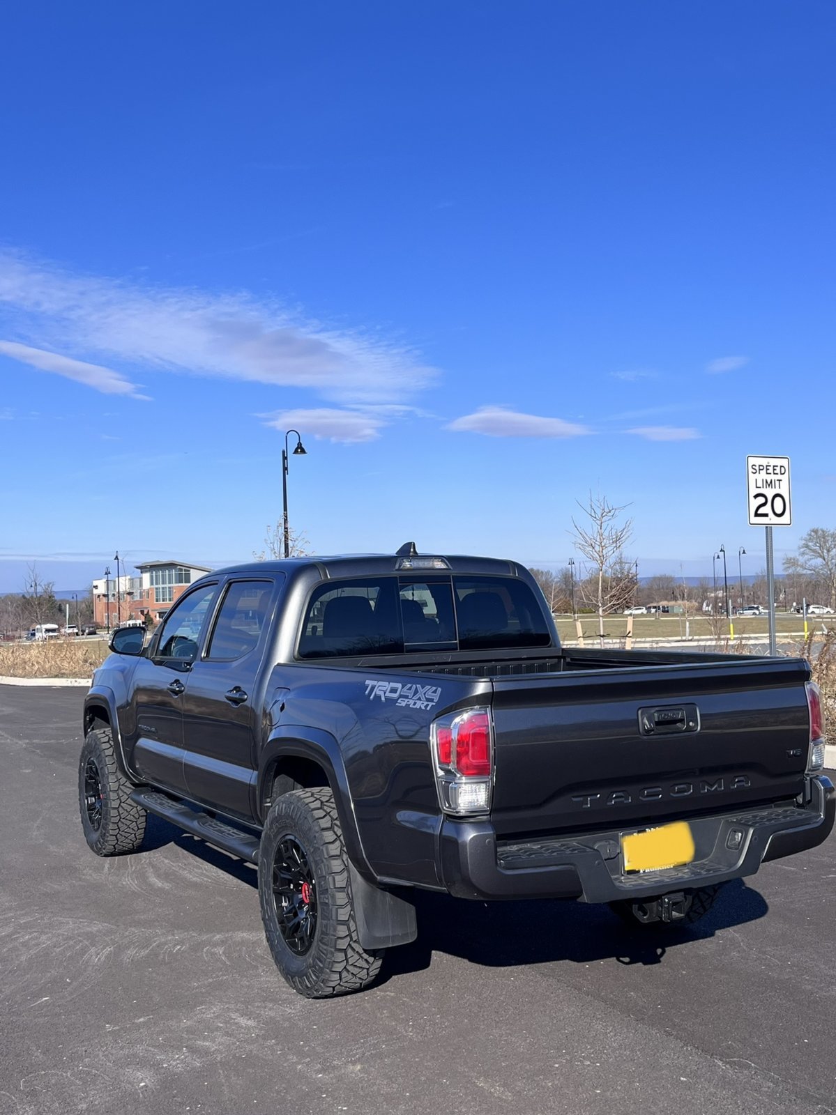

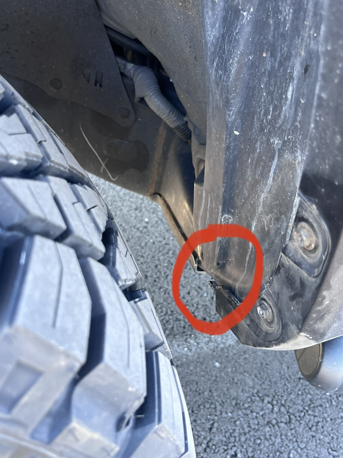

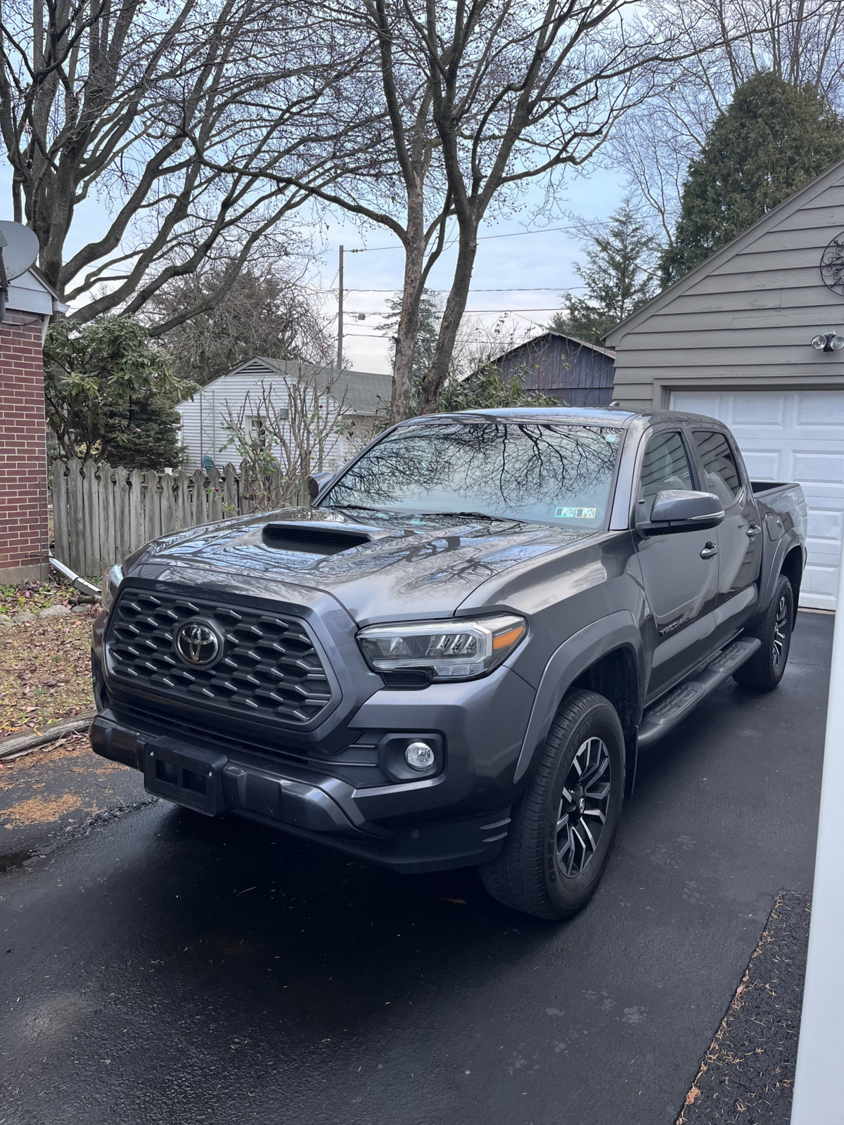

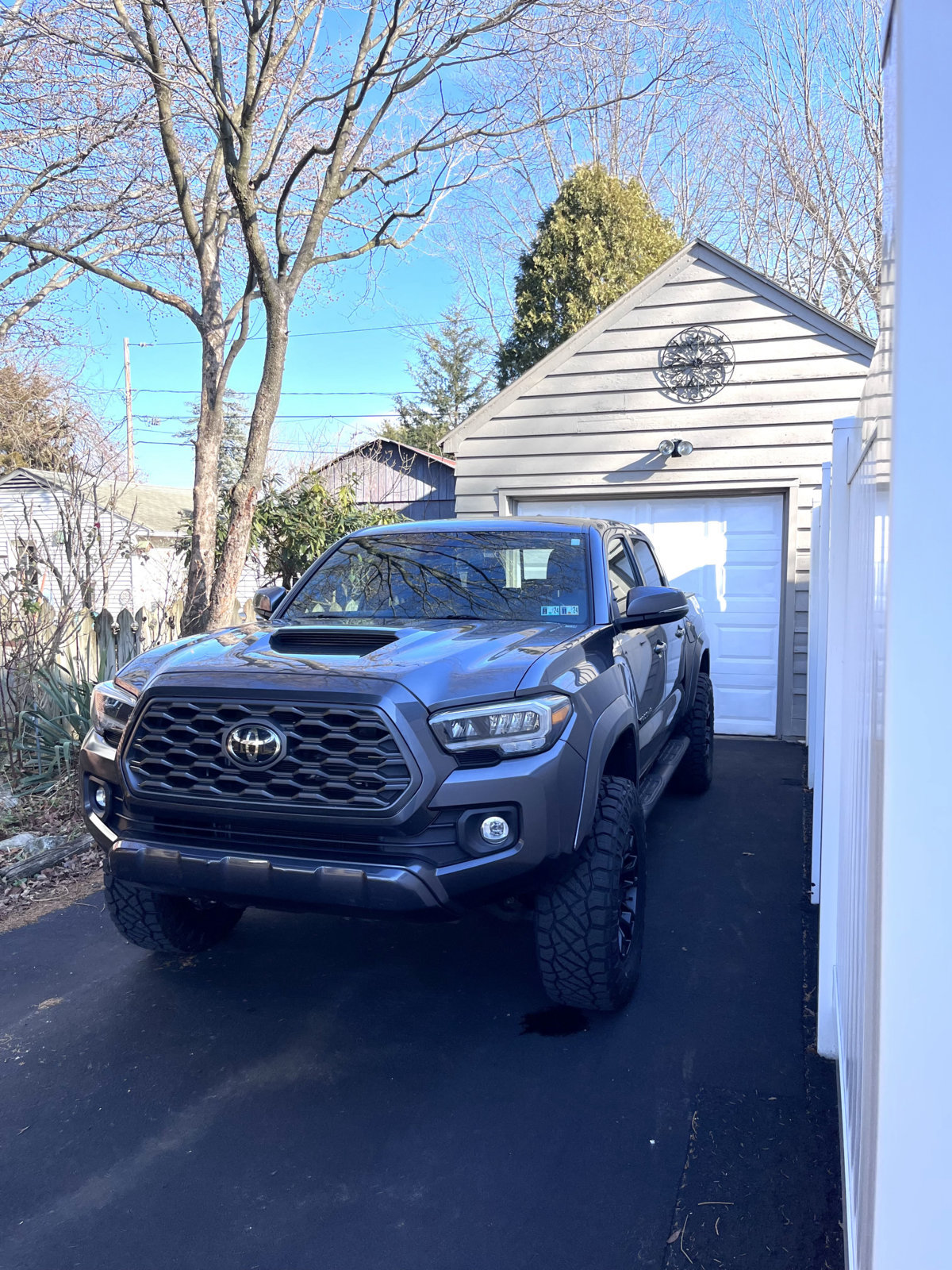

    I thought I would share these before/afters.
    '20 TRD Sport, 2" RC leveling kit in front, 1.25" Spidertrax spacers, '21 SEMA 4R 17x8" wheels, 275/70/r17 Nitto Ridge Grapplers.
    I removed the air dam and front mud flaps, there was minor rubbing that required minimal trimming at the indicated area in the front. No need for CMC.
    I'm very happy with this setup as this is my daily driver and will likely remain a pavement princess with occasional trips to the beach. I have not noticed a difference in MPG or handling.

    How many miles have you put on this setup since the install?
    What's the width of those wheels?
    I wonder if there wouldn't have been any rubbing without the spacers. I'm looking at getting this same tire size on a 2" Bilstein 5100 kit, but I want to go with the SEMA 17x7 +4 offset wheels that are ever so popular for these trucks.

    I edited the post to clarify that they are 17x8 with +5 offset.
    I only have a few hundred miles on this setup so far but keeping track of my gas mileage -- although it's a truck so not too concerned. I was able to mock up the wheels/tires on the truck in the shop with and without the spacers and, from what we could tell, I don't think there would have been any rubbing without the spacers (mud flaps/air dam were off at that point). I opted for the spacers simply for cosmetic reasons once I saw that installing them would only require one 1"x1" piece to be trimmed.

    Looks awesome! Great choices all around.
