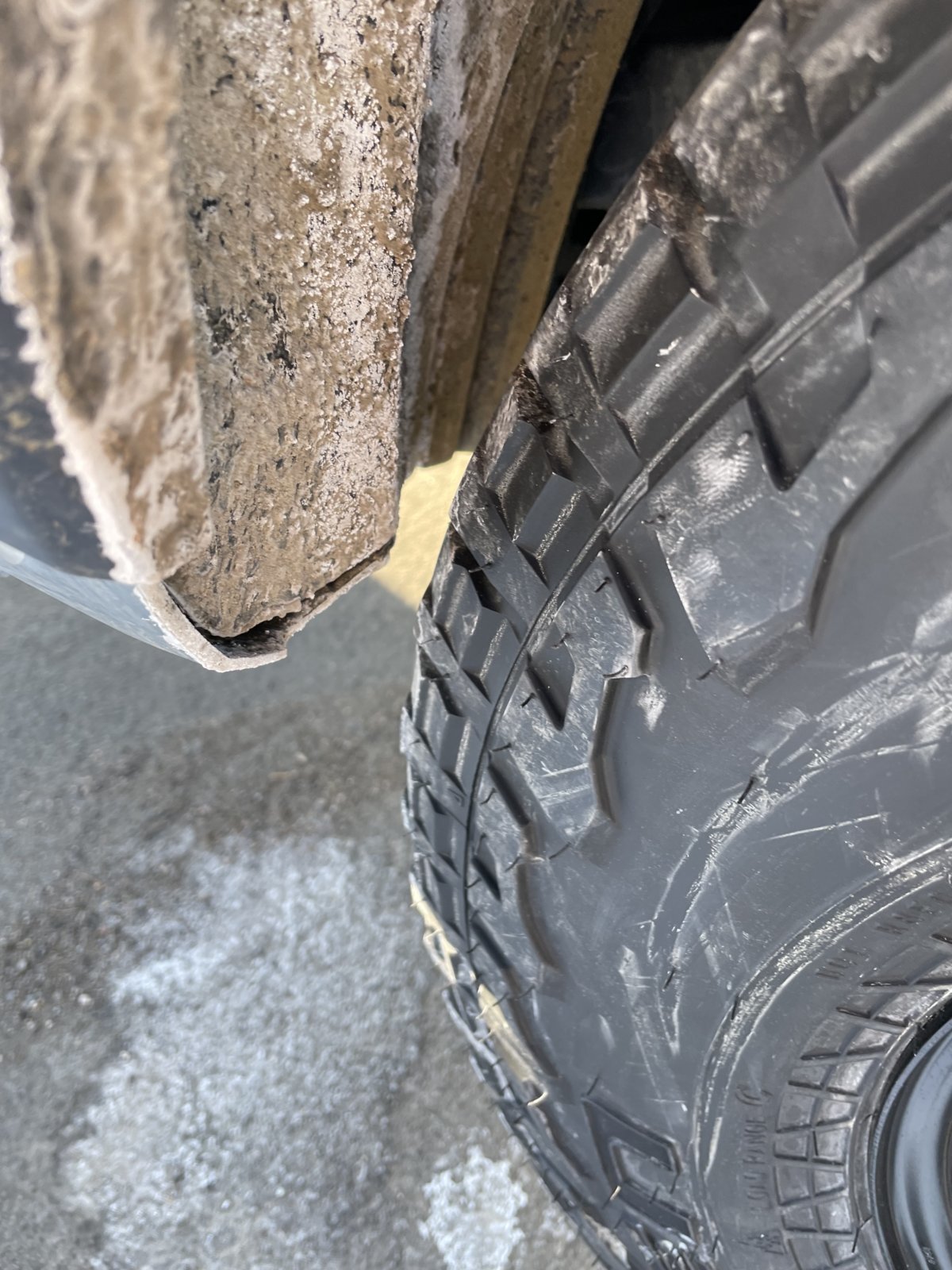

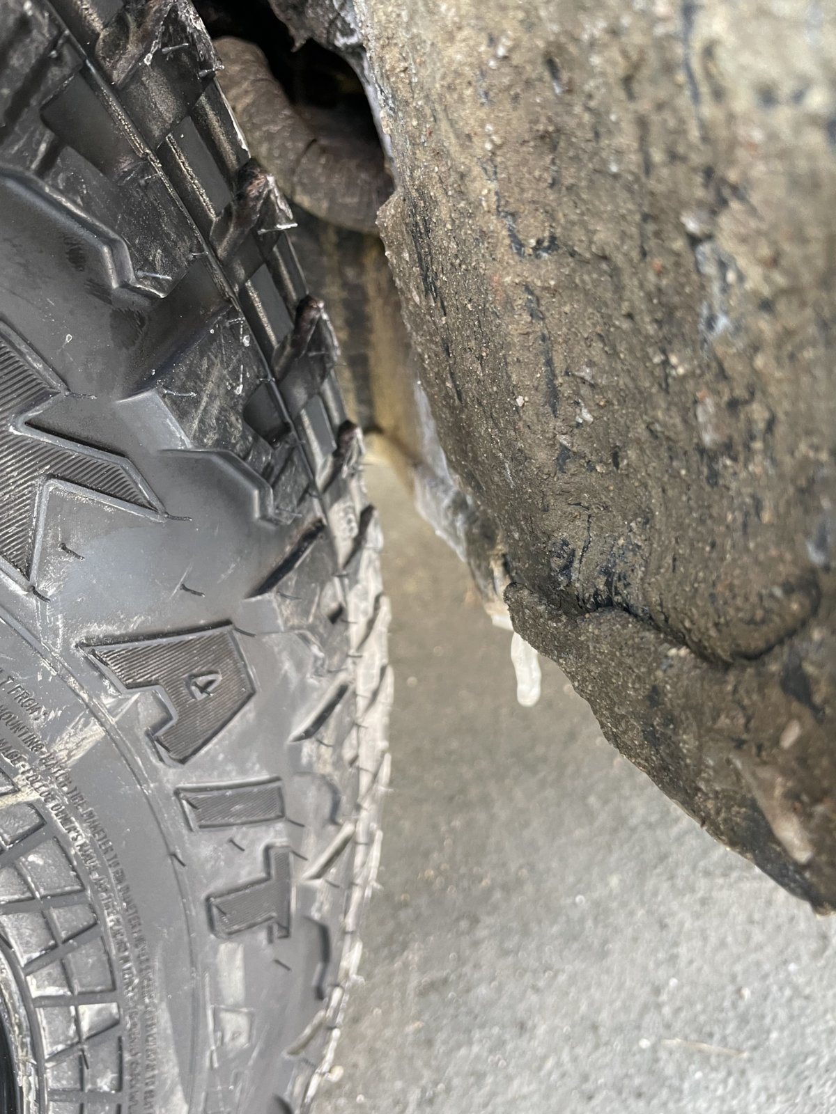

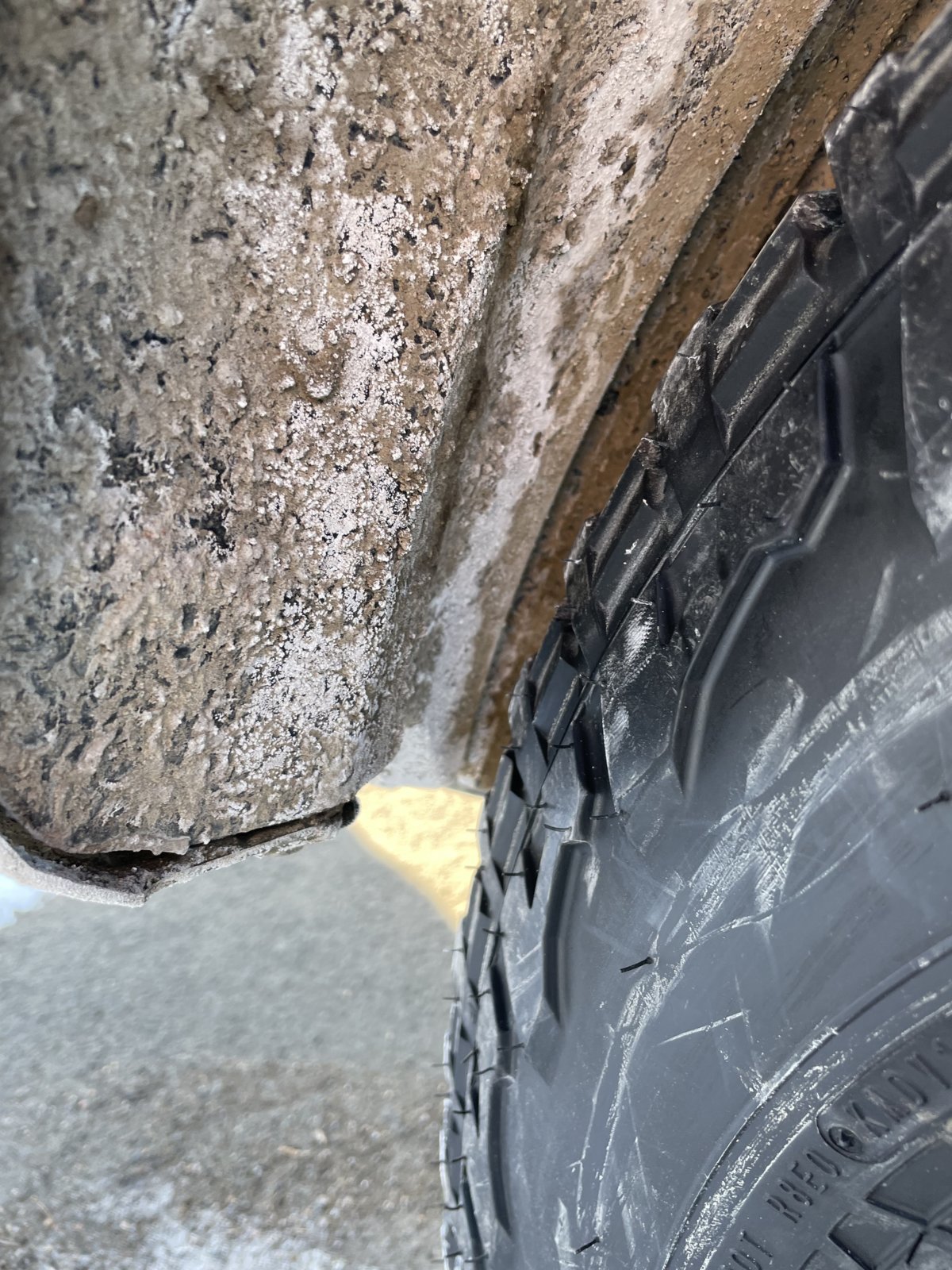

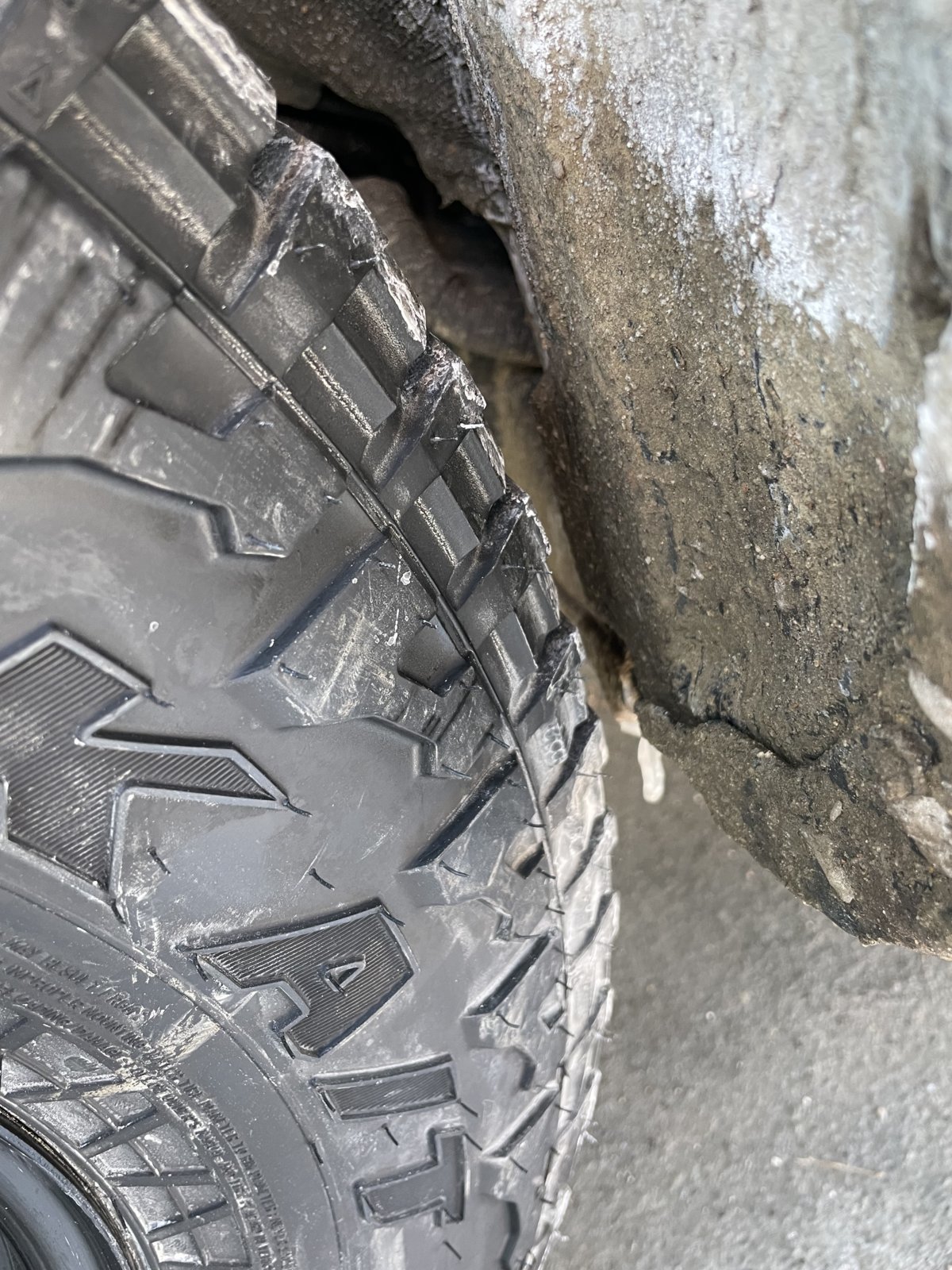

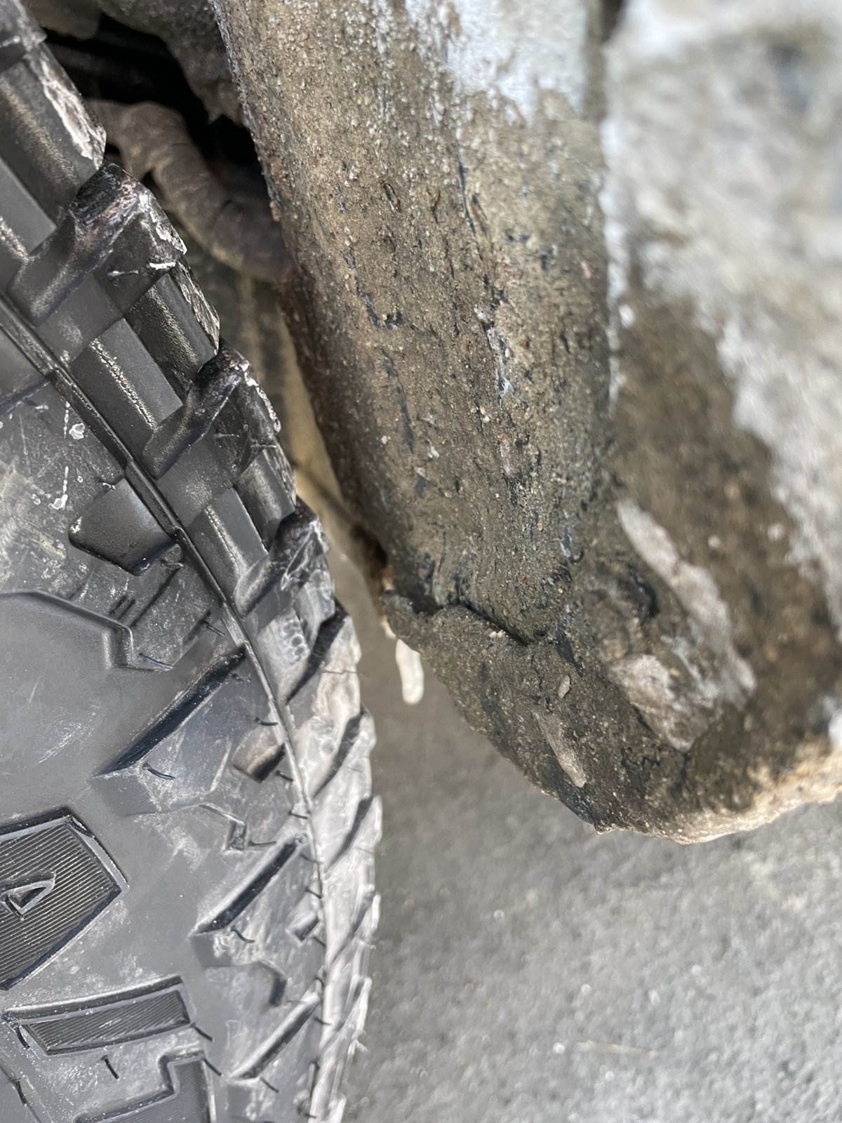

    For anyone interested, here is the clearance that I have with the slightly larger Wildpeak AT3Ws @ 32.4” on a completely stock TRD OR suspension with +15 mm offset wheels. The offset is the critical variable to prevent rubbing.

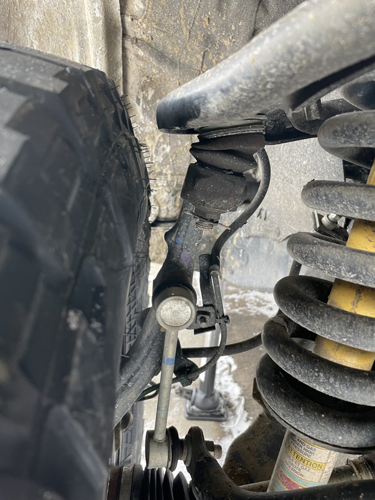

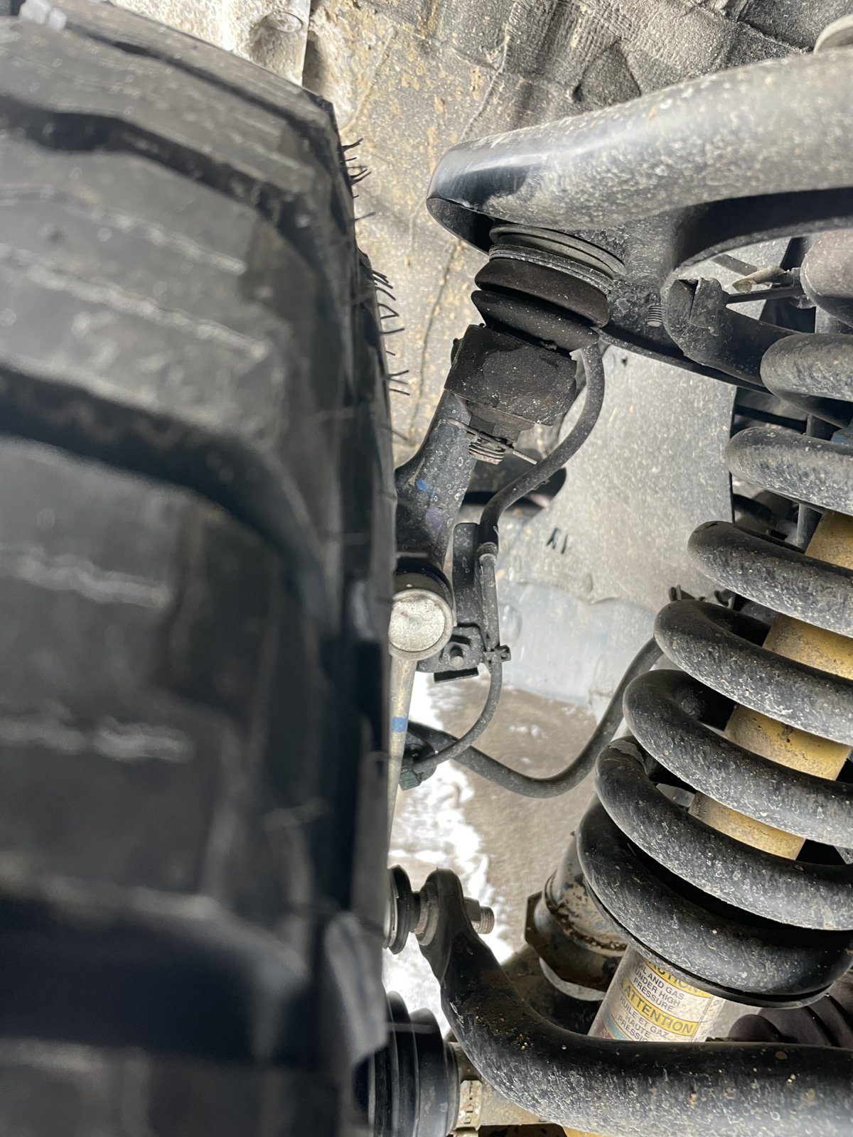

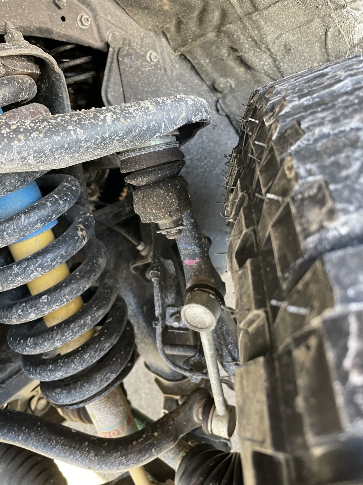

    I also checked the UCA clearance while articulating. The first picture is normal ride height with the UCA about horizontal. The second picture is with the truck jacked up to allow for full droop (with sway bar attached).
    (The clean spot on the UCA is from my glove, not tire rubbing.)

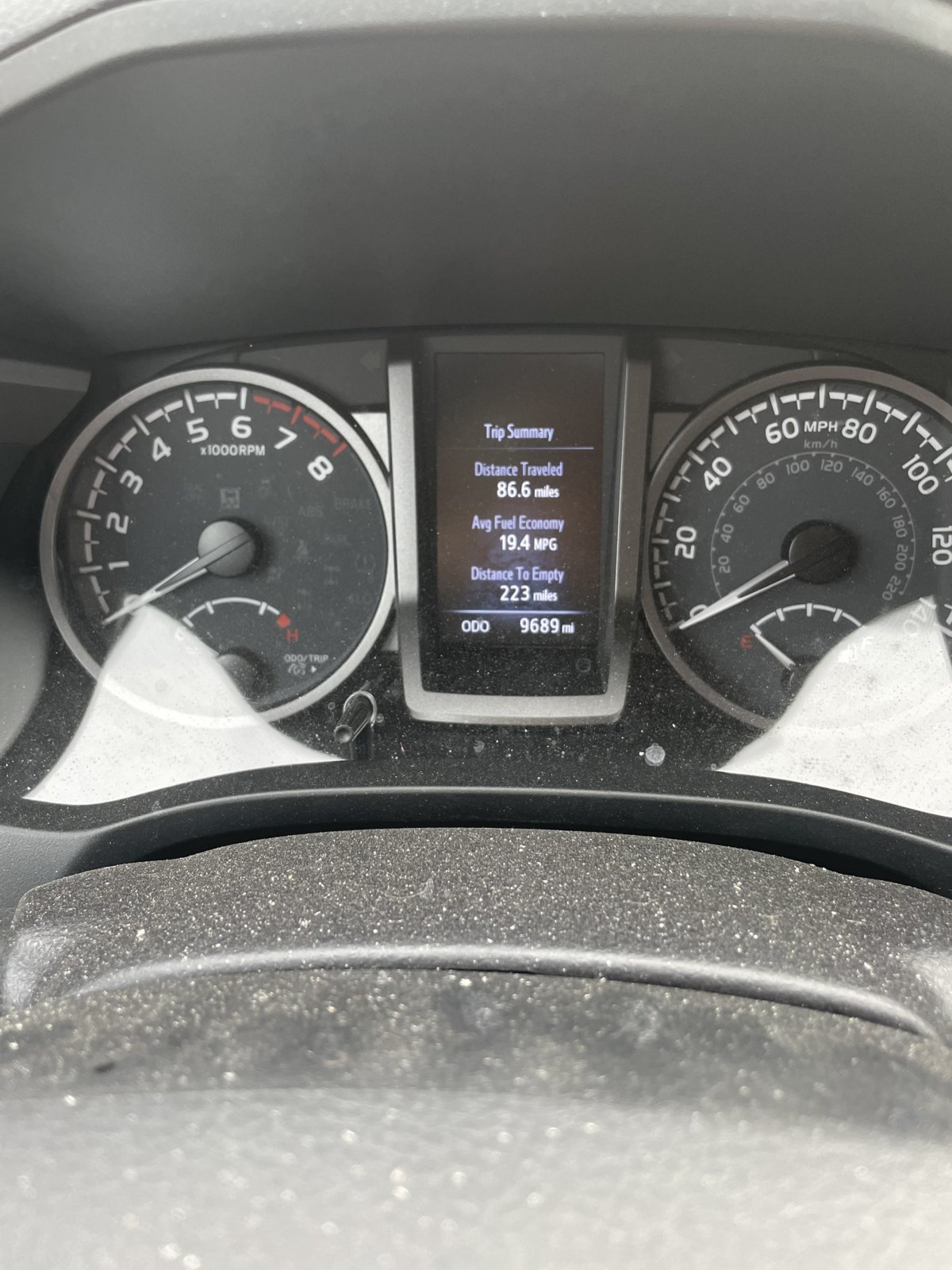

    I took a drive in the mountains today from Denver -> Golden Gate Canyon State Park -> Nederland -> Boulder -> Denver and managed to get 19.4 MPG on 275 Wildpeak AT3Ws. This was all mountain highway driving.

    Thats pretty good considering the added weight of the tire over the stock wheel/tire weight. I guess I wont worry so much about the details and trying to save 5-6 lbs per tire. I'm mostly driving in the Metro Atlanta area and average 18 or so city, with stock 265/65R17's on a 2" 5100 lift with the air dam removed. If I loose 2-3 mpgs I don't care, I just don't want to loose 6-8 mpgs by going E or C rated 275's. If that was the case, I'd most likely try to fit 285's in an SL load rating, which are lighter, but have less tread depth and don't look as aggressive on most brands, like the MT Baja Boss. I was seriously considering those tires in a 265/70R17 but i decided against that size because I feel in my head i'll always know I should have gone bigger. Then I was looking at those in the 285 Baja Boss along with the Cooper Rugged Trek, Open Country AT3 and RT Trail, and BFG Ko2's. I saw on a thread for the Baja Boss AT's that the sidewall on the SL rated tires looked very mild in comparison to the LT rated tires.
