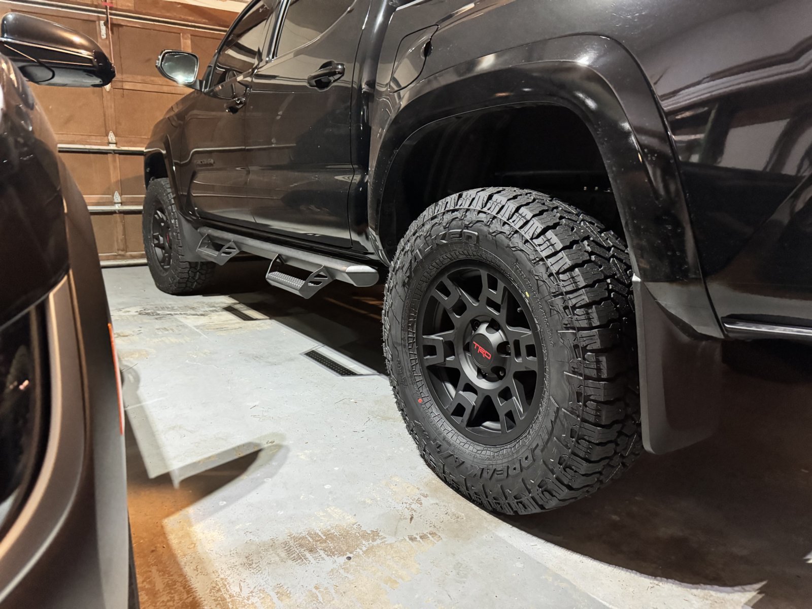

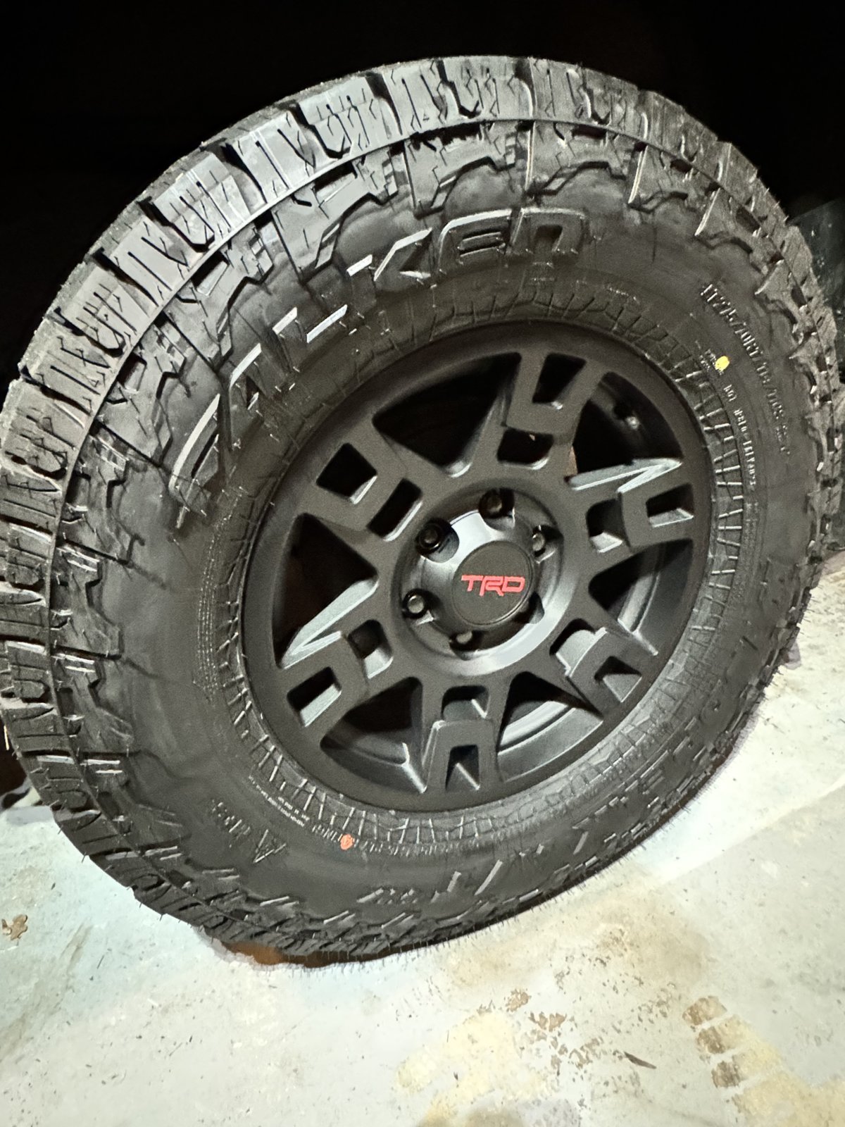

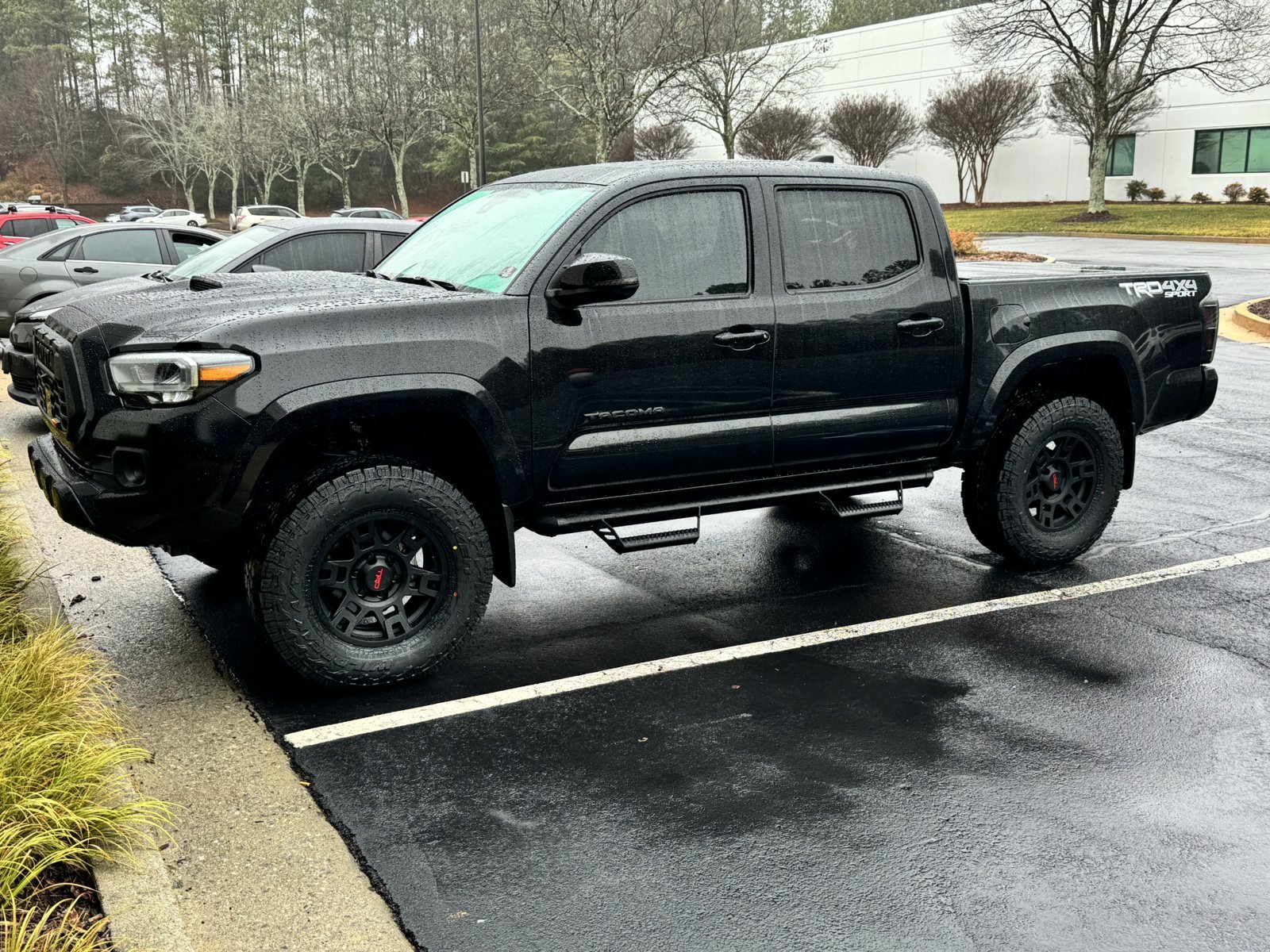

    Well I got the Wildpeak AT4’s installed yesterday and they look great. A TINY rub on the passenger mud flap when I’m making a hard right turn on to an uneven surface(turning in to my driveway) but I think I can fix it with a heat gun and having the alignment checked. I also noticed discount filled the tires to 40 psi so I plan on dropping that to about 35 later. Overall I’m prettt happy with how it turned out. Thanks to everyone here for their feedback and help in answering my questions. IMG_0160.jpgIMG_0168.jpg IMG_0146.jpg

    Thanks for posting!
    I was wondering how tires that size would look on my exact truck...and you have a Sport.

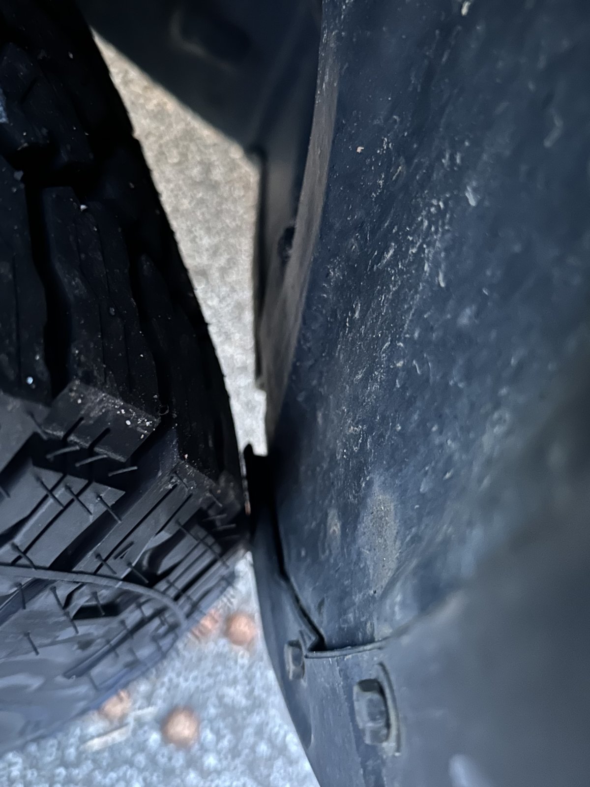

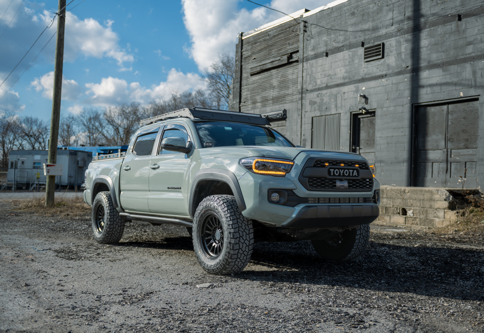

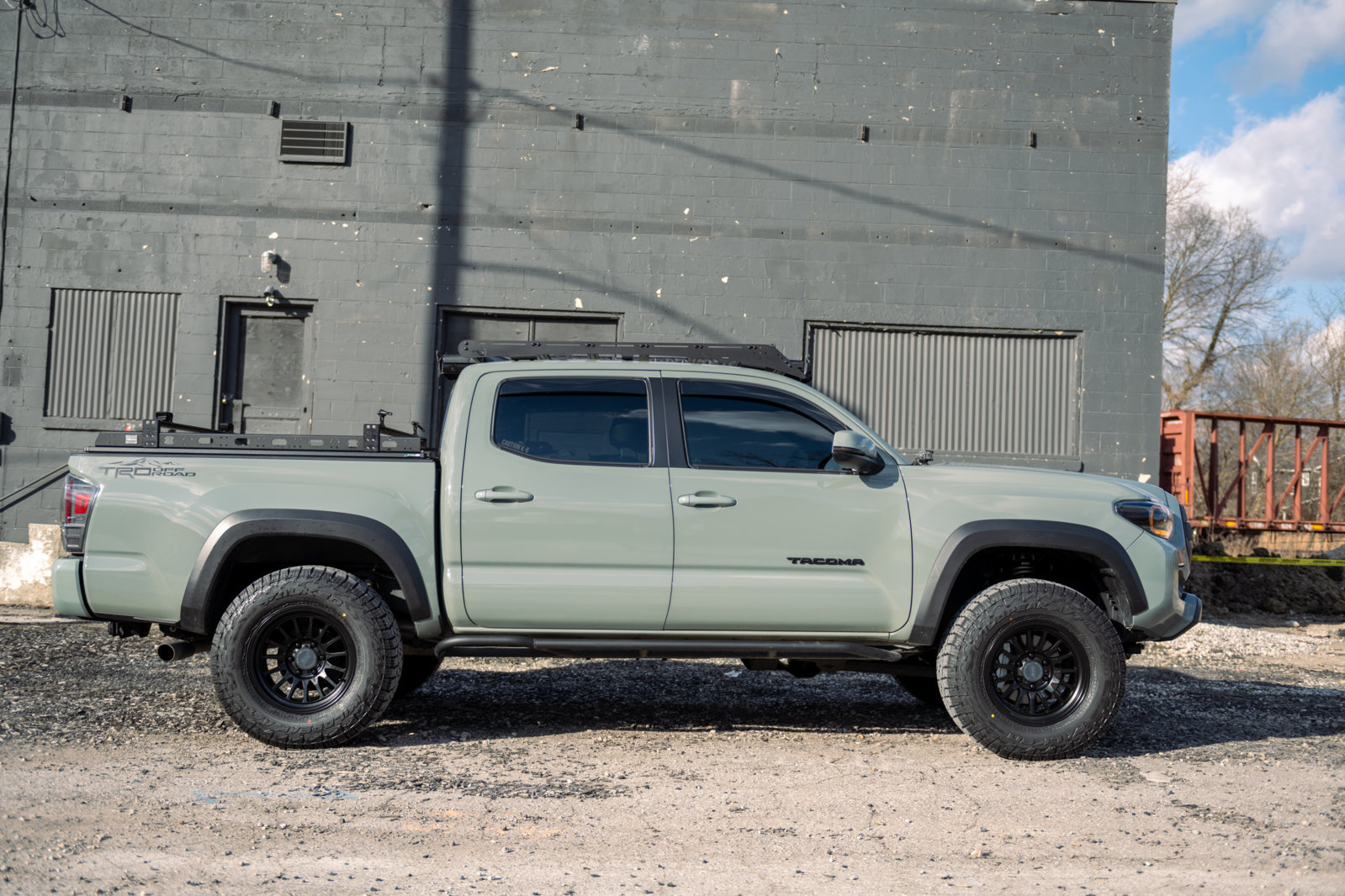

    Figured I'd add my experience here as well. Just got the AT4Ws installed yesterday, running a eibach stage 2 lift, about 1.5in front and a 1in block in the rear. Definitely had a few bumper plastics to cut, but my passenger cab mount looks like it took a few blips from the tire as well. I'll get them chopped if it continues to be a clearance issue, especially when flexing. I'm glad I didn't go all the way to 285s from stock. Otherwise I'm super happy with my setup.
    RRW RRS-7 Wheels 17x8.5 +0
    Falken AT4W 275/70/17 C load

    Looks great. I just put those same tires on SEMA Wheels with a 2"/1" lift and had a little rubbing on the mudflap, but the alignment shop was able to correct everything and I'm not rubbing at all. I suspect your rubbing issues are more due to the width of the wheel being 8.5" vs 7" for the SEMA Wheel. An alignment check might help a little bit, maybe they can push the wheel a little farther away from the cab mount, but you'll most likely have trimming to do anyways. Id rather trim plastic than cut the body mount. What PSI are you running your tires at? Discount Tire put mine at 40 psi which seems high to me, so I took it down to 37. I'm still thinking of going lower, but not sure.

    I think I can get away with them pushing it forward with an alignment but at this point, I sort of knew going bigger tires meant a CMC on the Tacoma. Sucks, but pay to play unfortunately.
    Funny enough discount tire also mounted and balanced mine and put mine at 40. I drove probably 15 or so miles this morning and it's definitely a lot of air but doesn't feel horribly stiff. I've read through most of this thread and most say 35 or so. I'll likely go down to that and see how they ride and then do a chalk test as well to see if that's a good PSI for dailying.

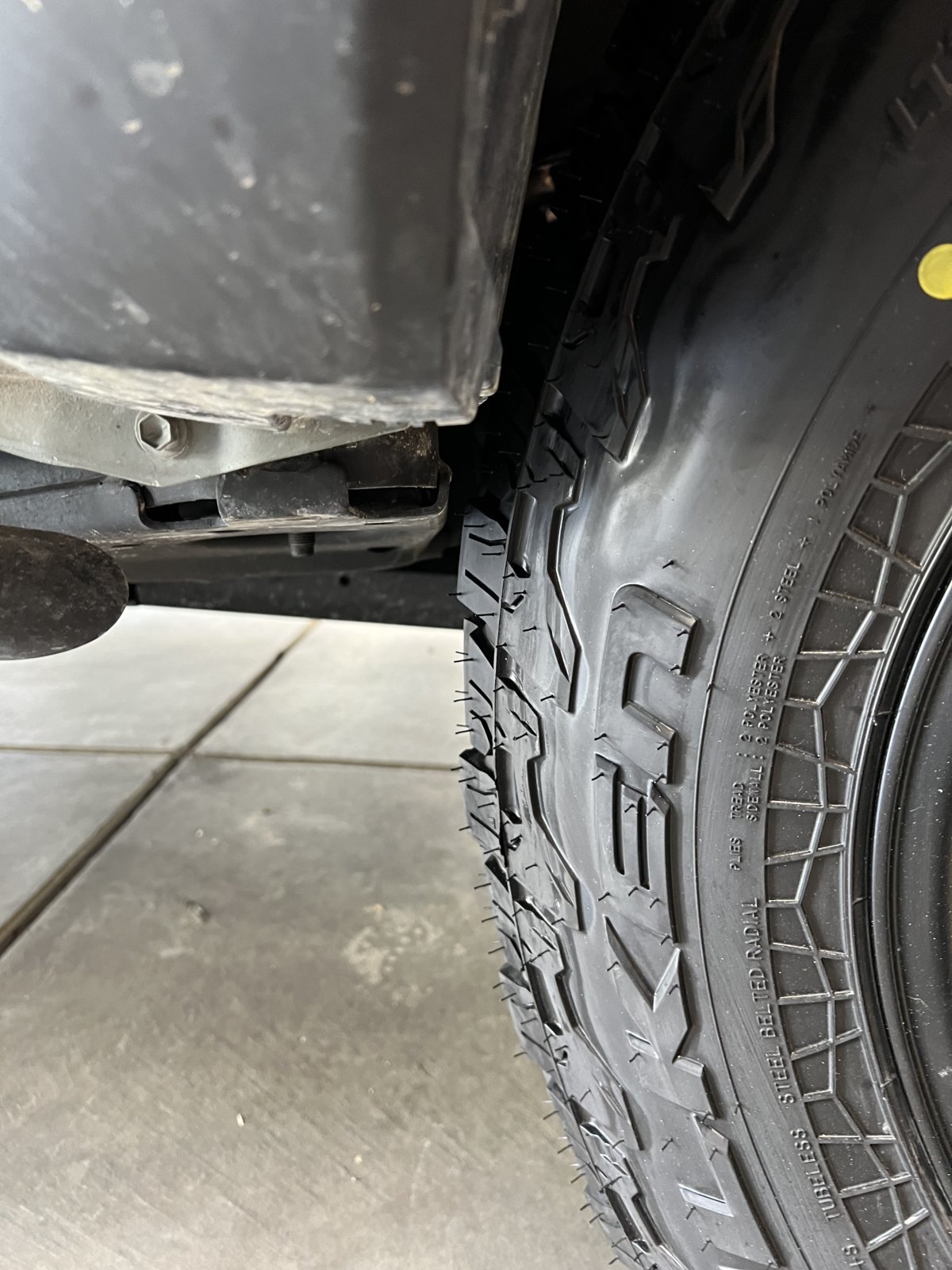

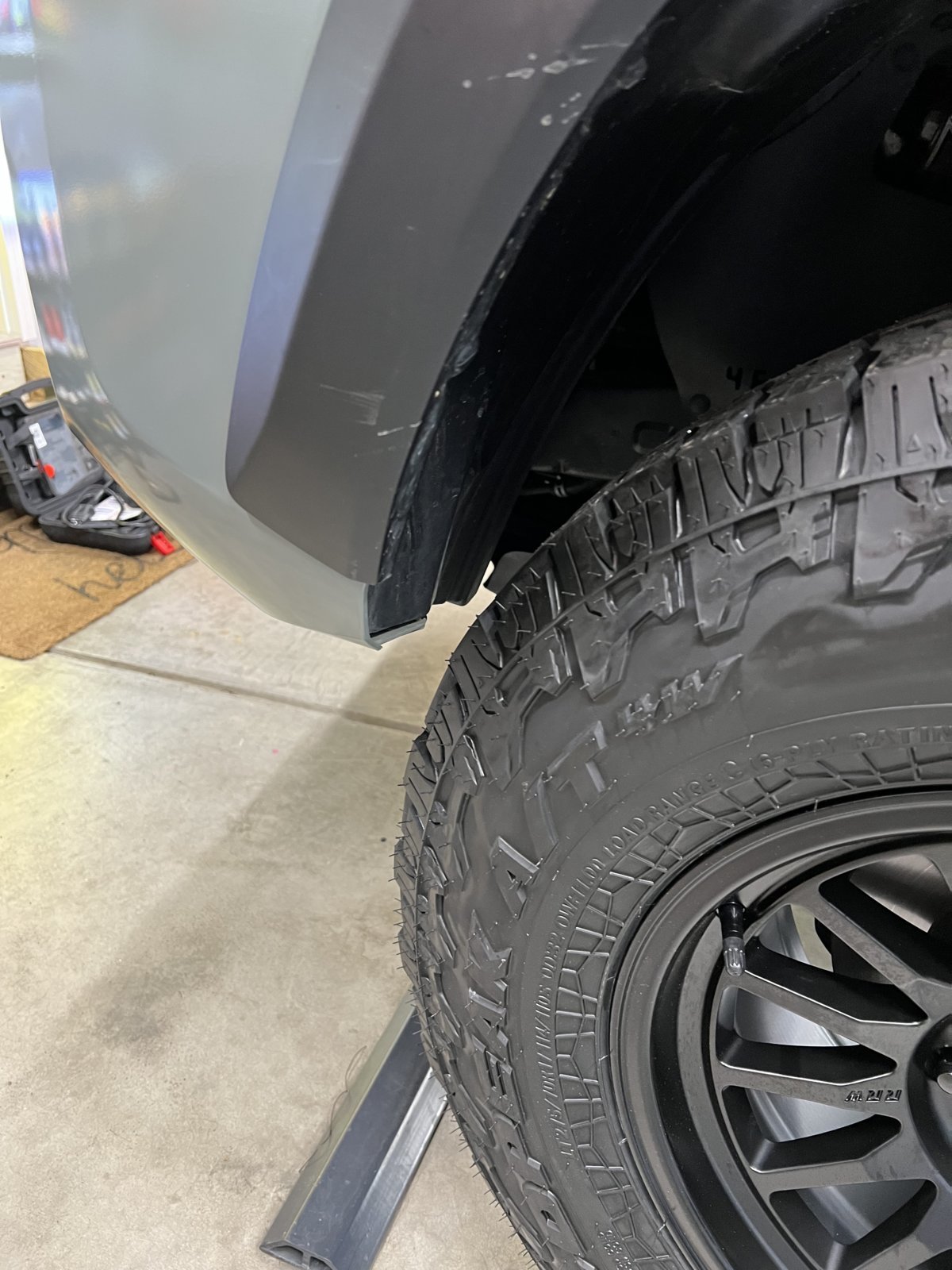

    Same lift, sitting at 2.5” and I’m getting rubbing right here. Is this where you trimmed as well?
    Wheels are at a zero offset, Method 316’s

    Yes, trimmed the fender flare and I had some cab mount rubbing on the passenger side so I just finished up doing a chop on both to prevent any other issues.IMG_0062.jpg IMG_0116.jpg IMG_0103.jpg IMG_0107.jpg

    i would have your alignment checked too. When I got my tires installed I rubbed the mud flaps. I’m on a 2” 5100 lift. When I made a right turn on to a driveway or something like that I would scrub a tiny bit. I went to a good alignment shop and they were able to change the alignment well within specs, but move the tire forward in the wheel well.
