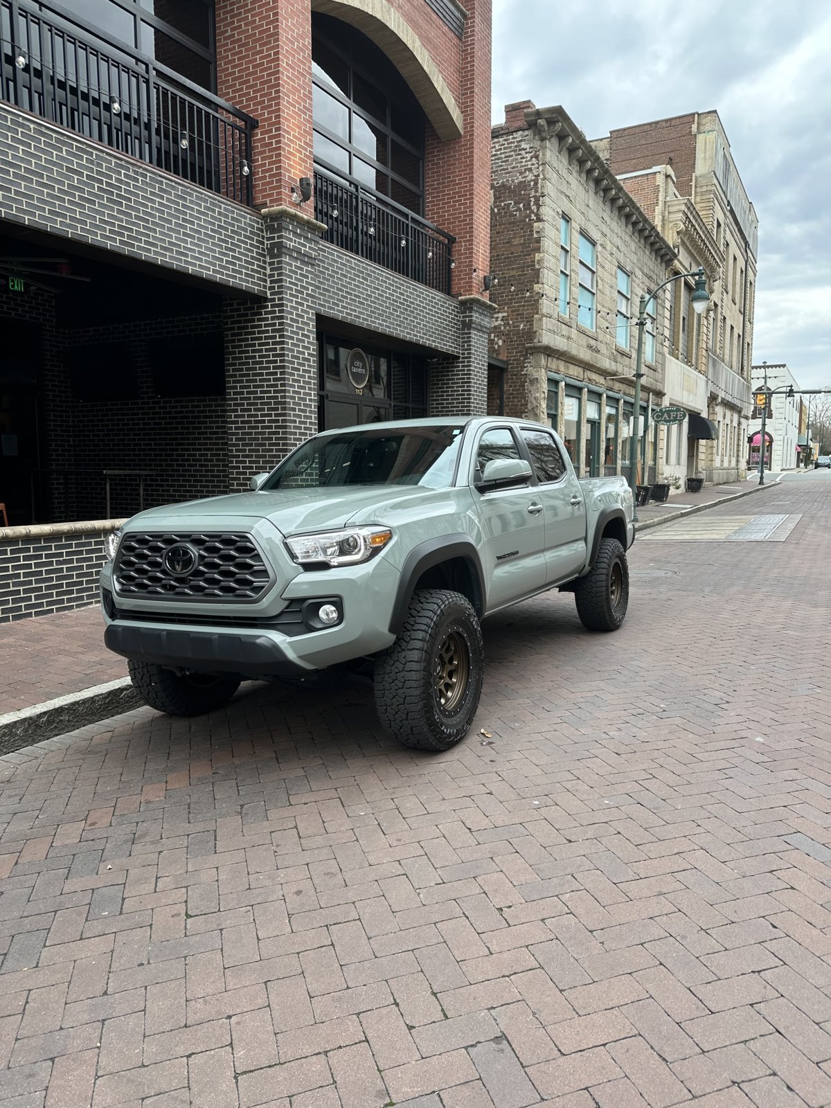

    Falken wildpeaks 275/70r17
    Suspension, front: Dobinsons IMS
    Rear: Dobinsons MRR adjustable, icon AAL

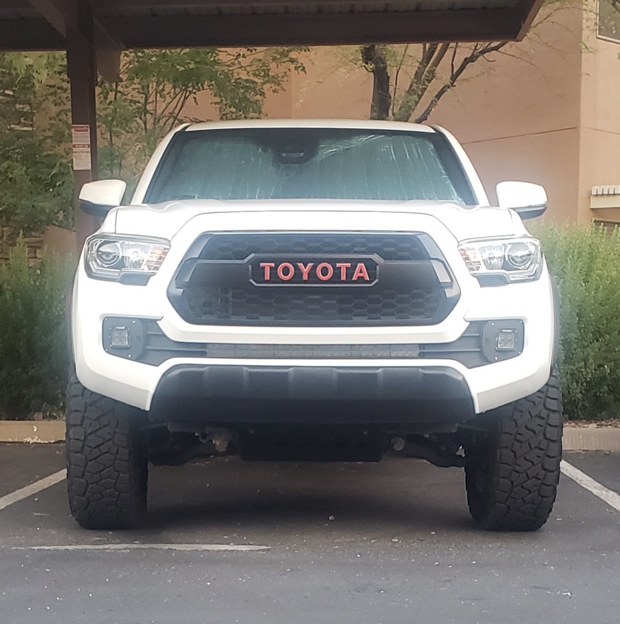

    Just put 275/75R17 on my completely stock TRD OR. I think it looks killer. Wheels are 17-8.5 -12 offset.

    Rig looks awesome, what size lift do you have on the front and rear? Any rubbing? what size offset?

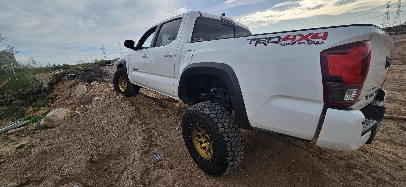

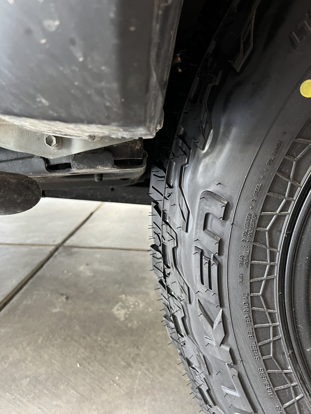

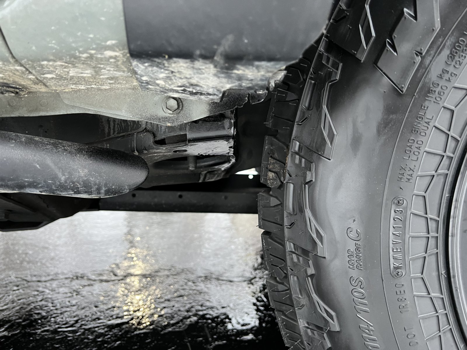

    Finally took the time to find a spot not on a trail to flex it out and find the rub point. The lower fender flare where it wraps under the truck just barely catches the tire looks like an easy small dremel cut maybe some heat gun work will solve it

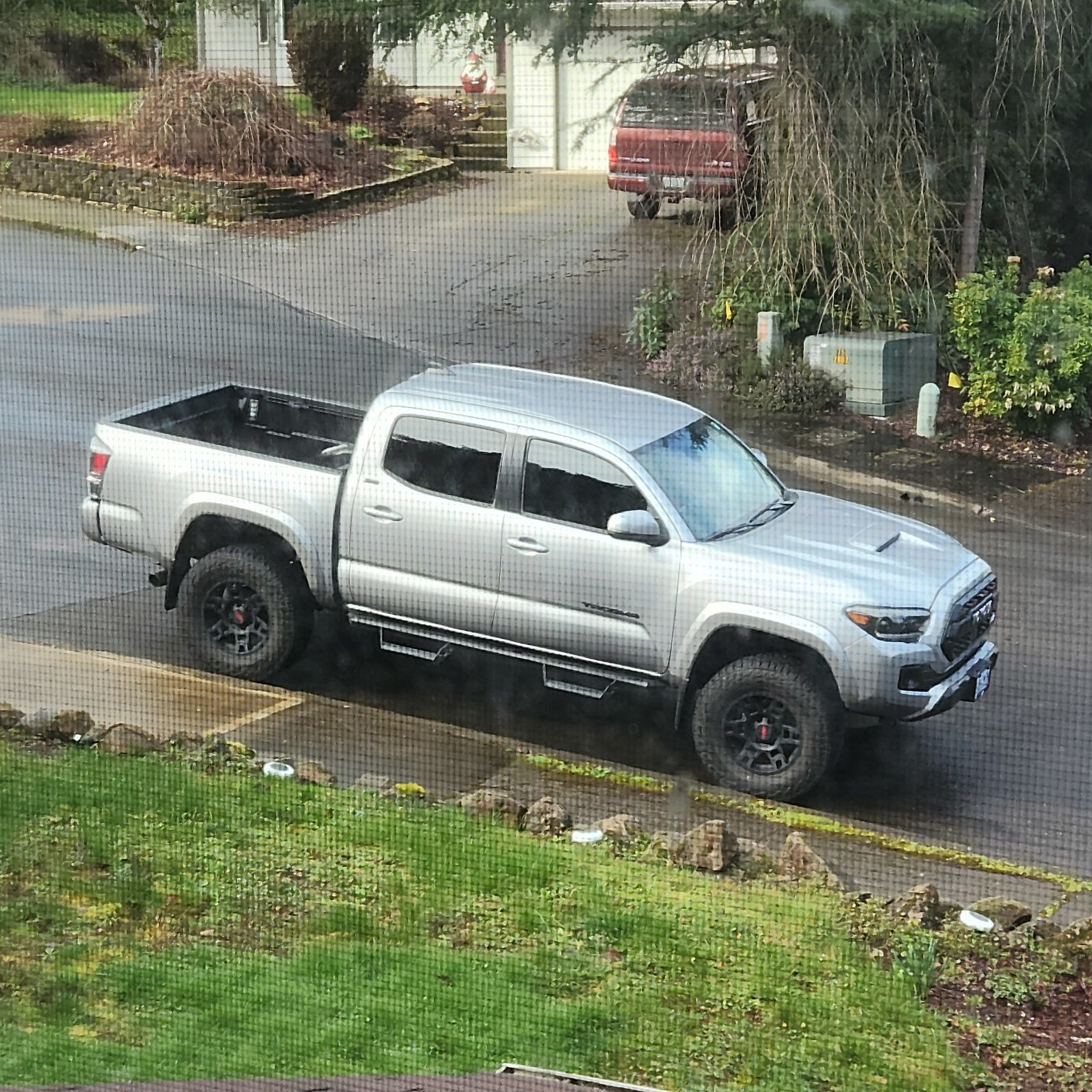

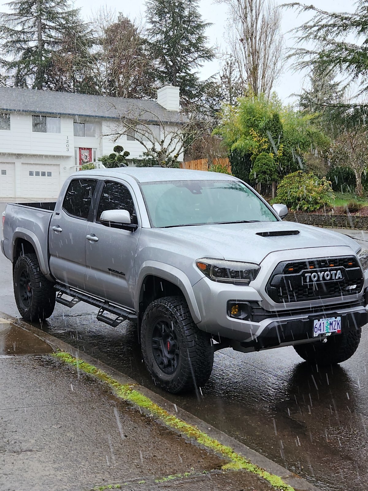

    "SR5 Pro" 275/70/17 Falken wp at3w

    What wheels are you running?

    Thanks, front is about 2 inches and the rear is around 1.5 inches I kept the factory uca, wheels are -10 offset and no rubbing so far but will test it out off-road later this spring

    Wheels are stealth custom series ray 10 in dark bronze 17x8.5 -10 offset

    Looks great! Love to hear it works for you. I have same configuration waiting to install with F5's.

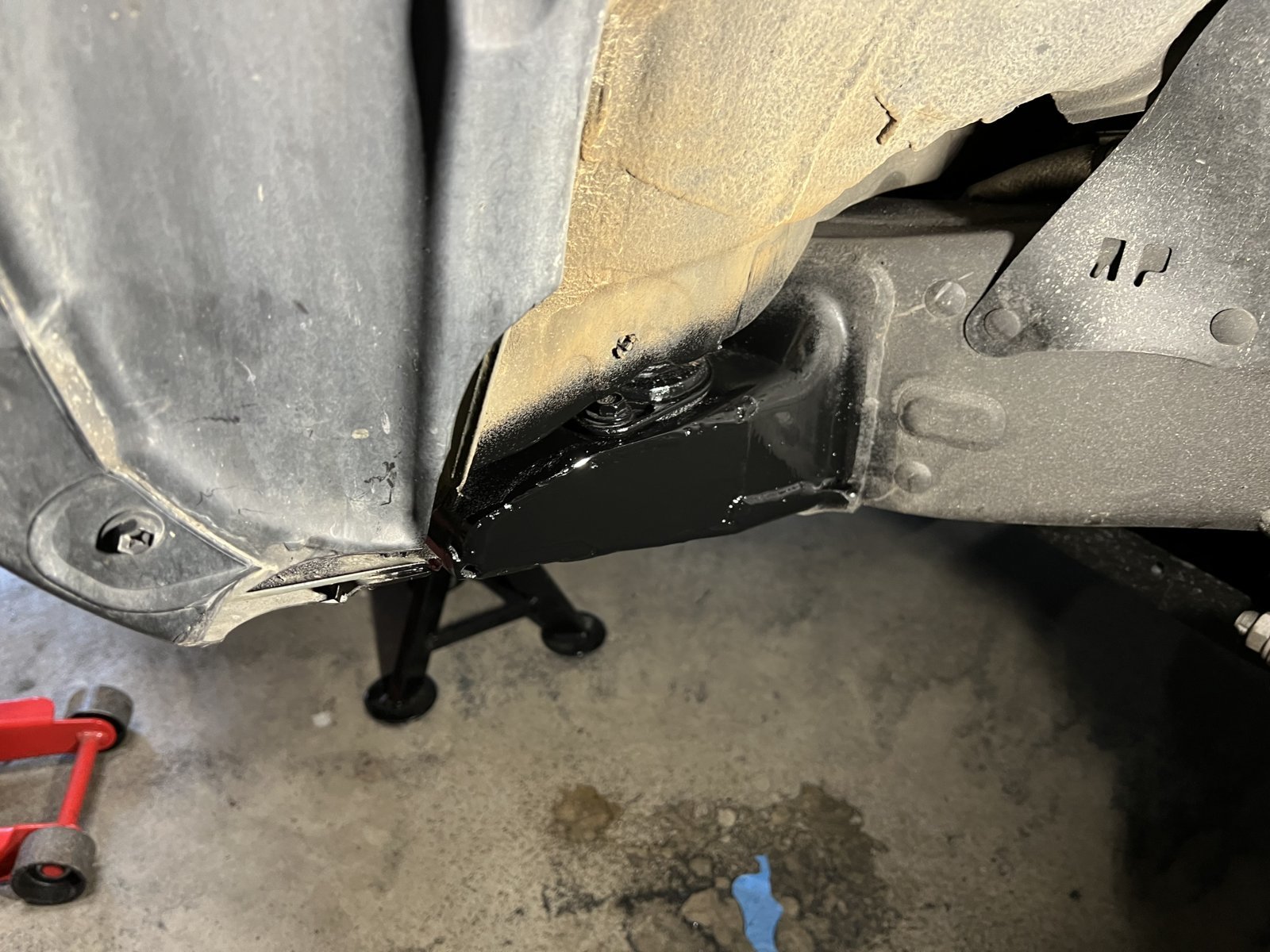

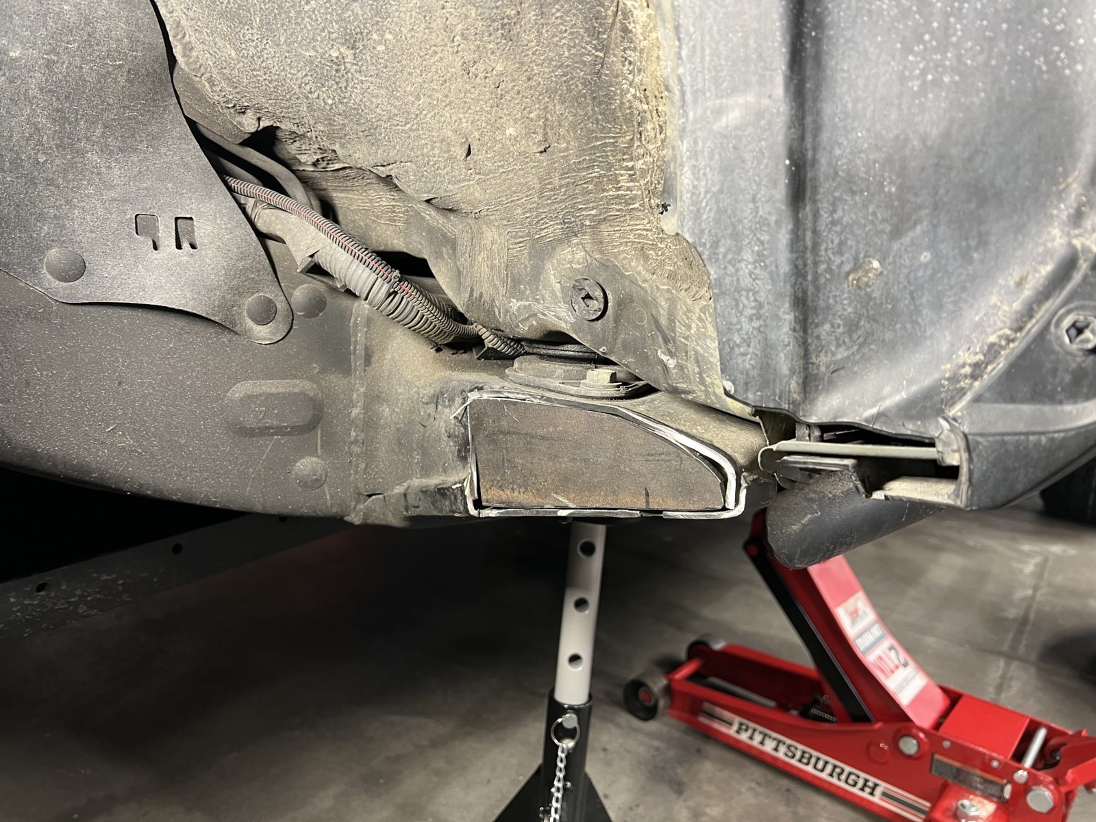

    Yep, that should take care of it. I wasn’t as lucky, ended up doing a CMC, but the guy nailed it. Did my pinch weld as well. The way he did things was CLEAN. I have alllll the room now.

    Trimmed it out with just a razor blade yesterday. I think that should do it but I'll check next time I'm out on a trail

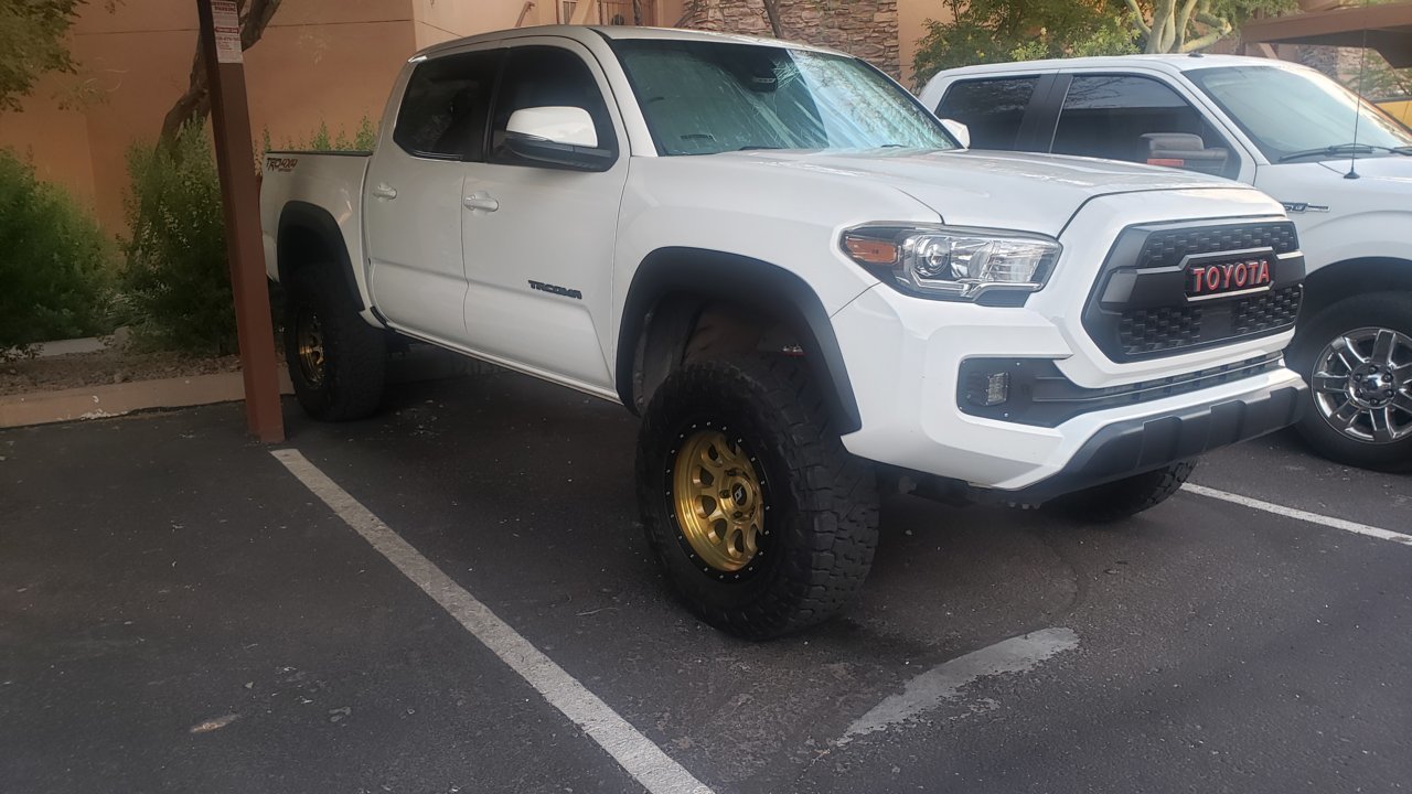

    Beautiful setup. I'm on the same boat as you, but leaning towards the 275's. Yes, 285's will be nice but even when I hit dirt, that extra 1" (well, technically 0.5" height difference) probably won't be needed anyways.
    What is your wheel setup? Any rub?

    Thank you SCS Ray 10 17x8.5 -10mm offset
    and RE rub see posts right above this. Didn't really notice until sway bar was removed but I also was running harder trails after removal of the sway bar. Results may vary every tire is different and so is alignment specs
