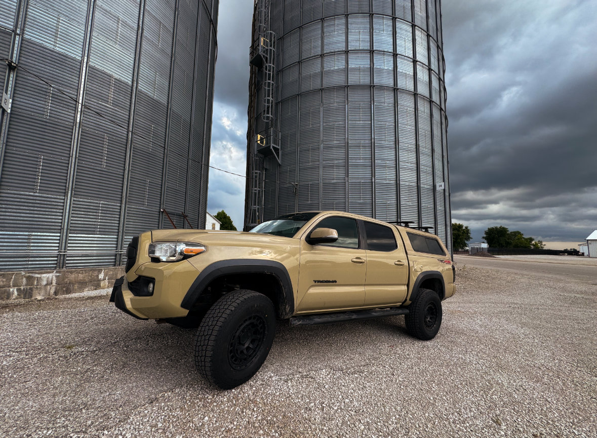

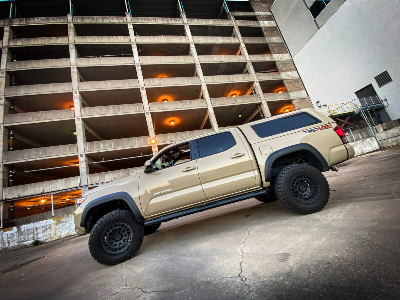

    My rig is 3000 miles from 300k. Currently in the body shop after smoking an Owl at 70mph. I’ve been rolling on 255/80/17 Cooper Discoverer ST - rotate every oil change and at the rate I drive that is about every month. Got 90k on those tires and they’re done. Got my money’s worth for sure. Suspension set up is 6112’s up front 6/5 setting. SPC UCA’s, rear is 5160 Remotes on a Icon AAL level 2. 17x8.5 - Zero Offset Black Rhino Chambers. Will a 275/70/17 fit - no rub? Or will I still need to do a CMC?
    MCCM, banditcamp, baboltin and 2 others like this.
  8. Jul 28, 2024 at 4:23 PM
    #1868
    Built4TheHunt
    Built4TheHunt Bass Fishing and Bowhunting...
    Feb 8, 2019
    #282321
    49
    Gavin
    Downstate Illinois
    16 QS DCSB TRD OFFROAD
    Quick update…LT255/80/17’s are history. Absolutely zero fitment issues w LT275/70/17’s - crazy how a new set of meats makes your ride feel new again. Time to log some miles and crest the 300k mileage mark!

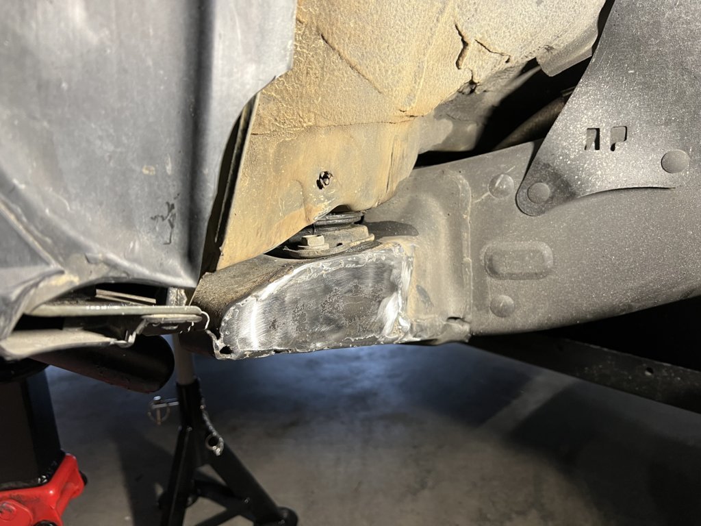

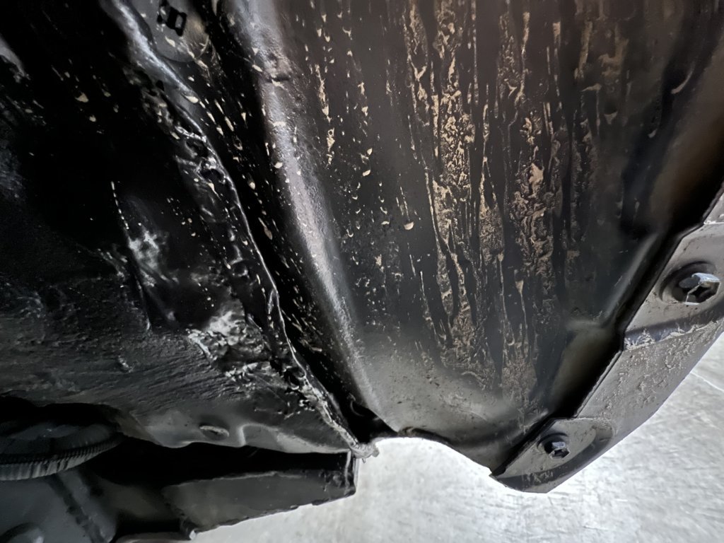

    Same reason I want 285s now that I have 275s LOL. I get it man, just trying to save you some headache if at all possible. I went the 275 route thinking I'd be safe, well let's just say I wasn't exactly "safe". I'm running RRW RS7s 17x8.5 +0 wheels
    First just CMC and some fender liner trimmings:
    Then after new UCAs that pushed them back towards the firewall, some plastics and some pinch weld work:
    I agree they look killer, but some people it's not worth all the work for, and I totally get that.
