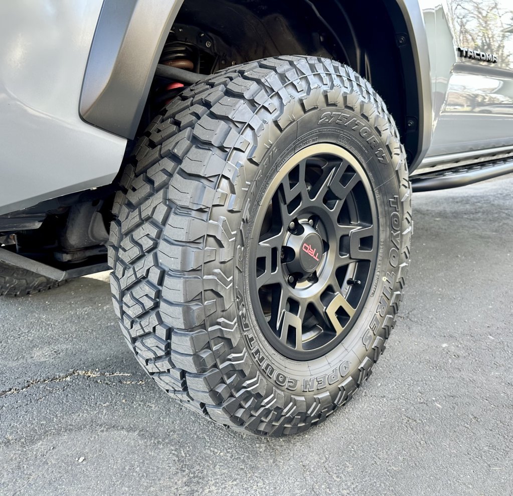

    2017 TRD Sport 4x4 DCLB Black, Trail Limo. RIP- 2009, 2000, 91,89,87 trucks
    Rigid pod fogs, SpartanX stealth grill and hood LED's, 17" SEMA's on 275/70/17 Falken Wildpeak AT3W's, Fox 2.0 on all corners , TRD CAI, LEER 100XQ Blacked out, w/ Thule racks, and Cargo slider Flow master American Thunder "dual" exhaust, remote start, tint, TRD Pro grill and TRD shadow graphics, Alcan custom 8 leaf Spring Pack
    NO VIBES. I have E load and they ride really nice for a big tire

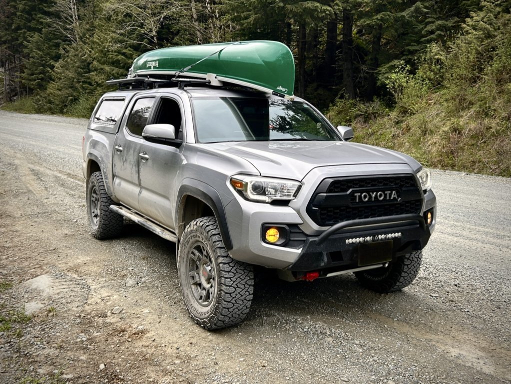

    Van_island
    Van_island Well-Known Member
    Sep 5, 2023
    #432887
    96
    Isaac
    2019 taco
    Been a few days with them so far they are definitely heavy i have noticed it on my morning commute took a bit of a fuel hit aswell. On the plus side i dont speed anymore. I am also tuned on OTT

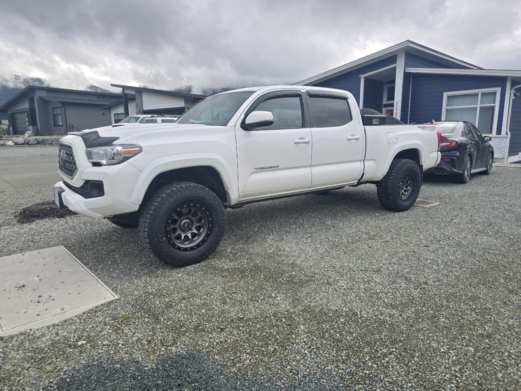

    VicsTaco23
    VicsTaco23 Member
    Mar 19, 2025
    #468041
    24
    Vic
    Los Angeles
    23 Tacoma TRD Off Road Black
    Eibach Pro Truck S2, JBA UCAs, Icon AAL

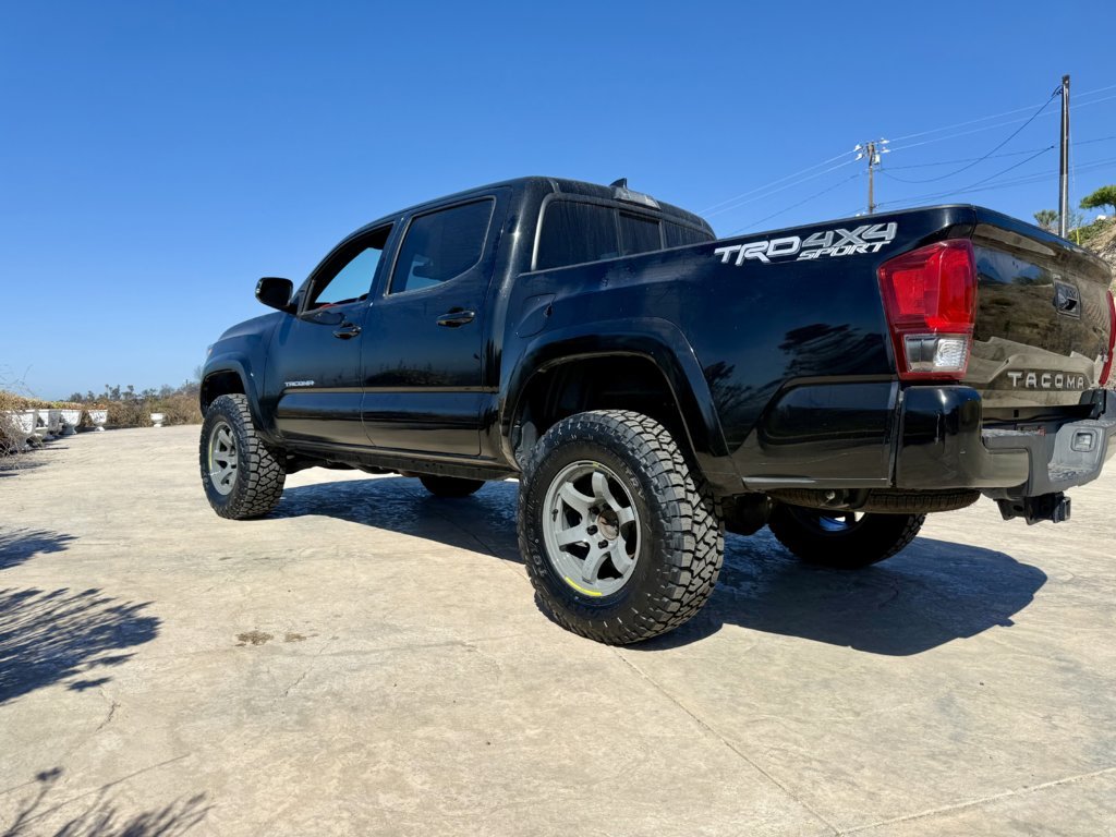

    Joined the club today
    RH7s 17x8.5 -12 on AT4Ws

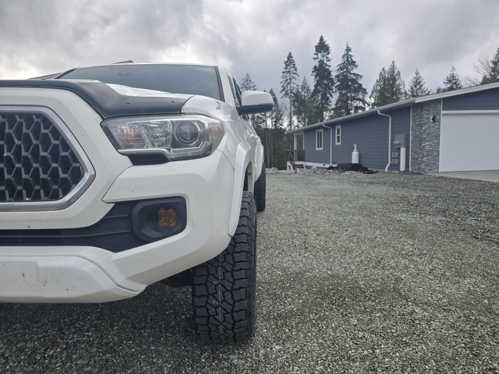

    AJR95
    AJR95 New Member
    Jul 22, 2024
    #453752
    Andrew
    2020 SR5
    Falken Wildpeak AT4 275/70/17, 2" level and 17x8.5 0 offset Methods with no rubbing

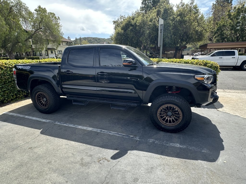

    Backdoc
    Backdoc Well-Known Member
    Jul 16, 2021
    #371405
    885
    Harford County, MD
    2021 SR5 DCLB
    Bilstein 6112/Eaton Truetrac/RCI sliders Some other stuff
    Stock UCA's?

    #1929
    Backdoc
    Jul 16, 2021
    #371405
    885
    Harford County, MD
    2021 SR5 DCLB
    I have a question for you guys running 275/70/17's. I have Bilstein 6112's in the front at 10/8 with stock UC's. Im 2" higher in the rear than stock. I am currently running STMaxx's pizza cutters 235/85/16's. I found a great deal on marketplace for a set of RC 17x9 -12 offset with Falken Rubitreks 285/70/17's. I bought them and put them on and while they looked really, really good, they rubbed a little at the cab mount and just barely on the front flare at full turn. I sold them this afternoon for more than I paid for them as I don't want to do any serious cutting on the truck just yet. With my current set up can I run 17x8 -12 with 275/70/17's? I messed with the tire size calculator but I am still not sure.
