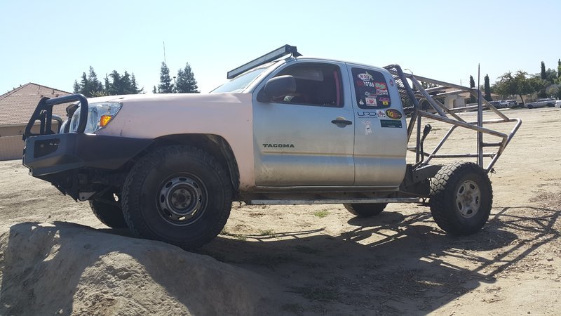

    Custom front bumper and rock sliders, glasspack muffler, shorten exhuast, abs killswitch, roof light bar, rear e locker.
    Believe it or not, it's only a 5 lugger still and will always be.

    I saw that truck on Mad Max Fury Road!

    Lol that's the main reaction I get. Yes, the movie did help some inspiration.

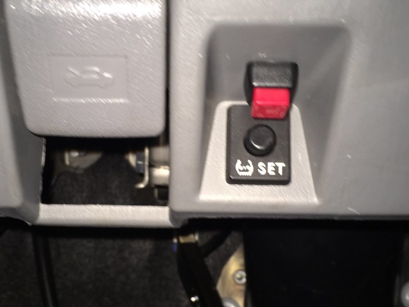

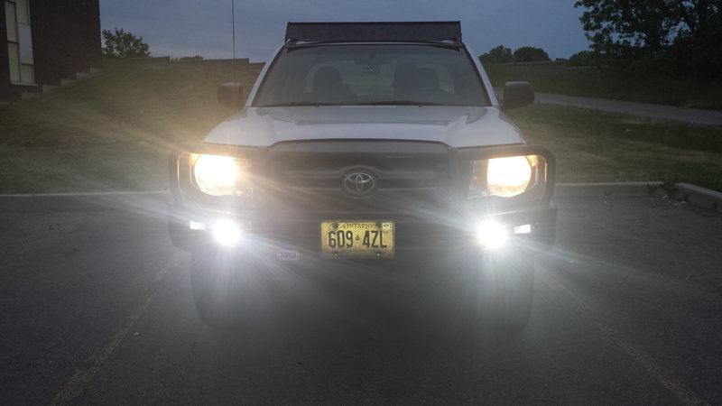

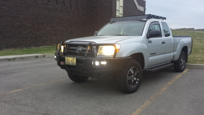

    Gone over the Top for a 5-lug..
    Labrak inserts now fully functional with wired in driving lights up to the firewall. Just have to go into the dash, to complete.

    What is this mod . Meant to do.

    Thought it was an ignition kill switch....always thought those were cool.

    Its turns abs, vsc, and trac control on and off with the press of a button definately a must for taking it offroad or in snow and ice conditions

    Lol pretty sure I only have abs

    Because the driver can out modulate the computer?

    Haha the only reason for this mod was for abs it can fuck you

    Brake modulation under low traction conditions.
    You think the driver can modulate the brakes faster and more accurately, w/o breaking tire grip, than the ABS computer can?

    This is not for on-road use. Only offroad.

    Ok. Doesn't change the question........
    Let me ask a different one since I'm missing something. How does ABS create a problem offroad? Why would you want to be able lock up the brakes?
    I've driven 10's of thousands of hard offroad miles on vehicles w/no ABS.
    Not understanding how it would create a problem?

    Well for me since i live next to the sand dunes, having abs off builds up sand in front of tires for times when abs would make the sand like marbles and i have all 4 tires locking up. I do no sort of offroad crawling or anything like that so i cannot speak upon this but having and racing prerunners its always been a must to have this.
    For me its extremely dangerous on sand especially when going off the edges of faces of bowls from not stopping in time.

    Need to charge your phone sir >__< I'll stick with abs on lol
