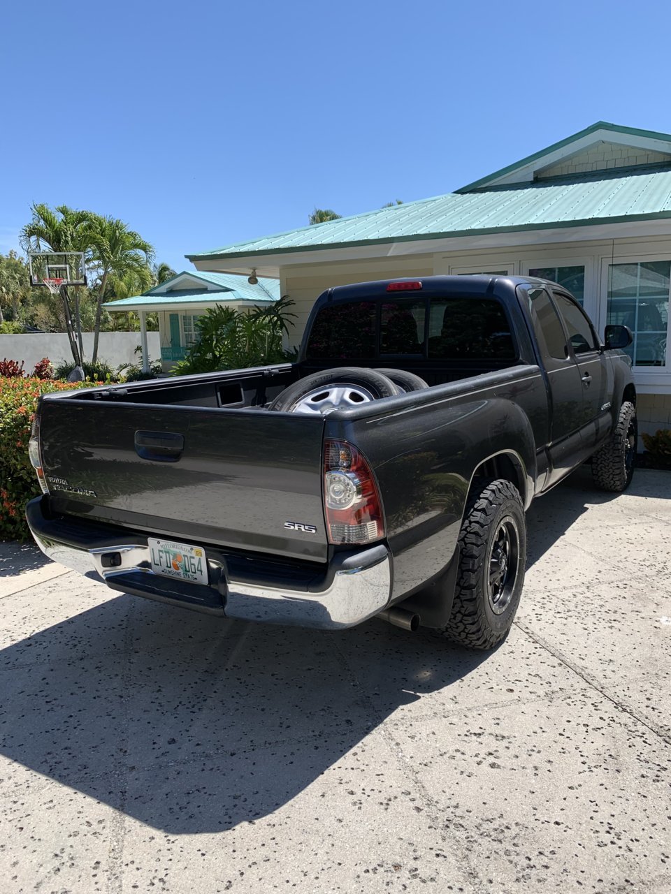

    Gray 2012 tacoma 5 lug
    Fuel aluminum 16inch wheels Fat Bob Leveling kit Toyo At3 (265 75 16) ARE Fiberglass Camper top Bilstein rear shocks
    The day i lifted my 5 lugger

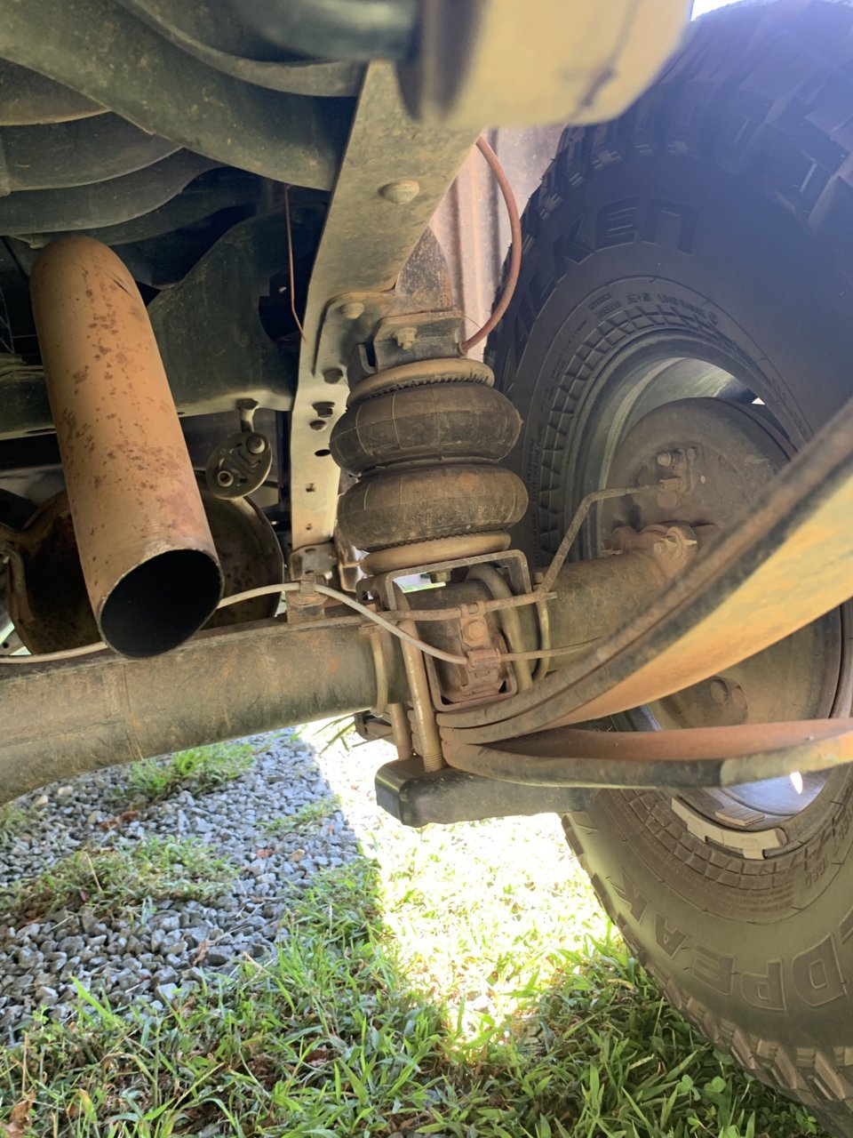

    Does the air rite actually lift the rear up ? I’m looking at buying it because my rear end sags big time.

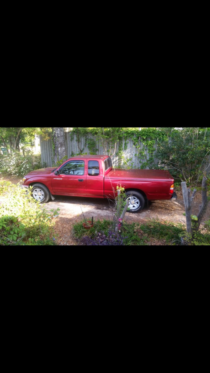

    This '04 is all stock with 255,000 miles and still runs good. It's a spare vechicle and good to have around for misc purposes Screenshot_2019-08-07-17-14-20.jpg

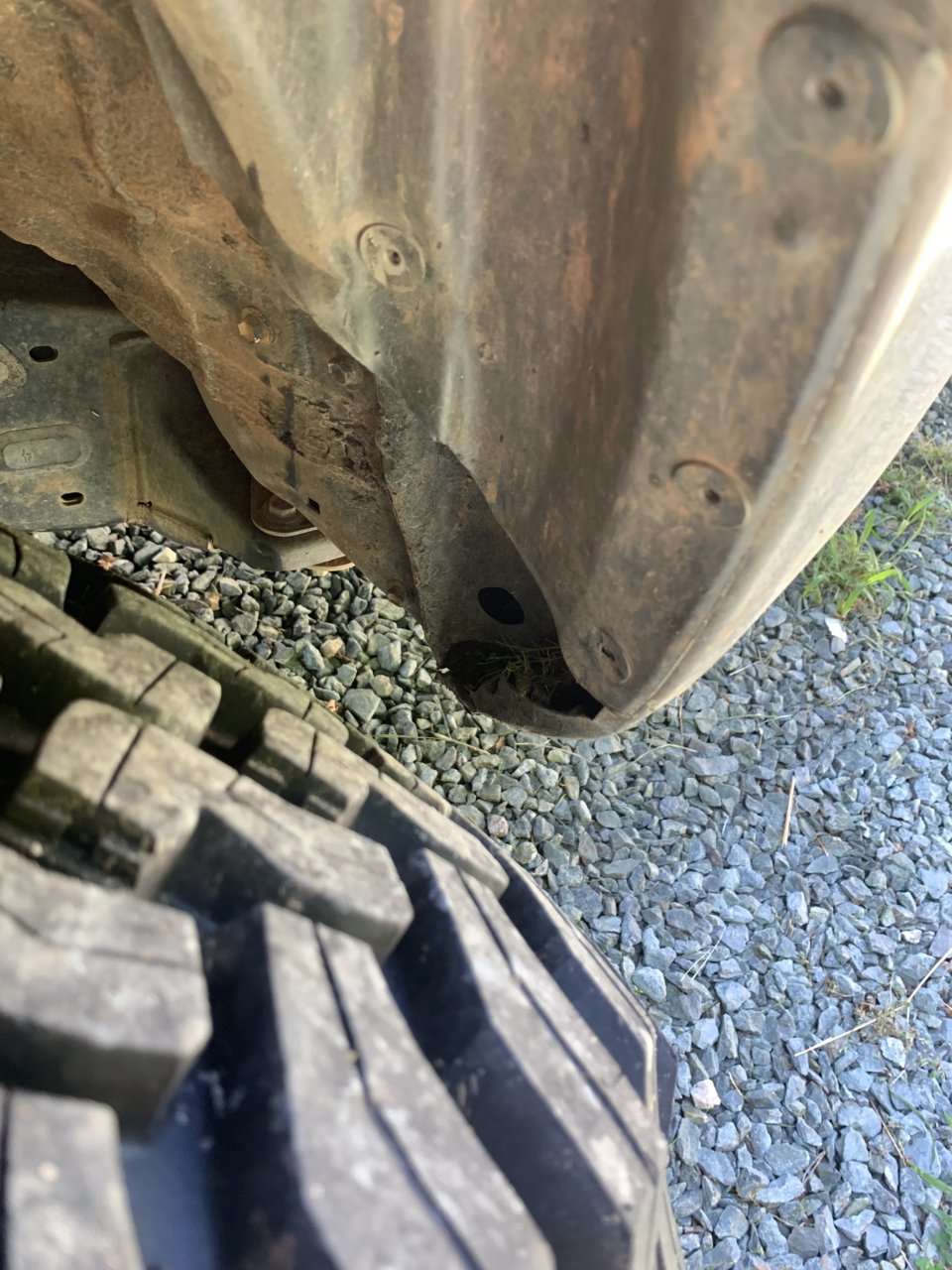

    Well I started off trimming plastic and it rubbed then I beat the pinch weld flat ish and it rubbed so I said to hell with it and I took a sawzall to it and it doesn’t rub unless I’m wheeling hard

    Yeah, the rear airbags are nice, they can lift it up like 3 maybe 4 inches if you really inflate it. I would only recommend the Firestone ones cause I’ve hears horror stories about knockoff ones that may be a little cheaper. Right now I’m on stock leafs and shocks but I’m getting some bilstiens from a buddy who just lifted his TRD off road soon

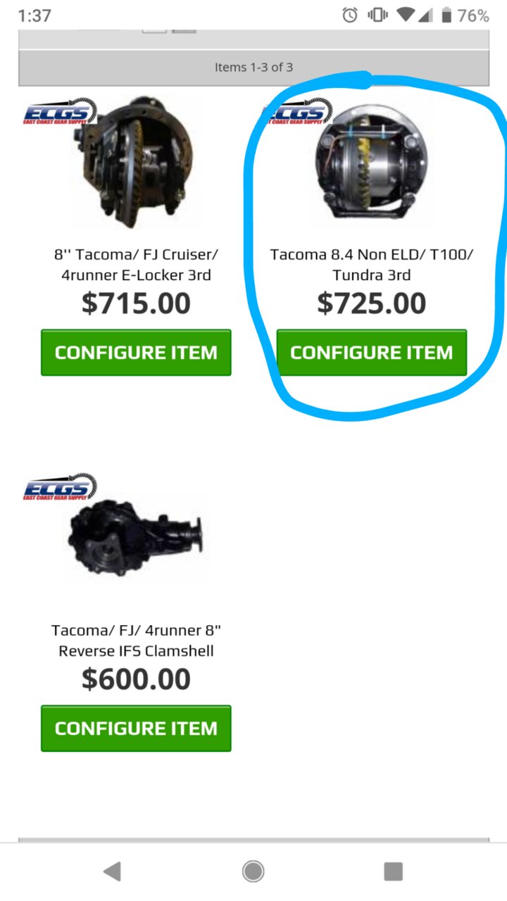

    I’m on stock gears still and it sucks but I’m tryin to swap my 3rd member with an elocker with 4.56 gears from easy coast gear supply

    Just a heads up the Toyota elocker diff is a different size from our stock one. Not sure if that's the path you were thinking but figured I should give you a heads up. It's why I'm 6 lug in the rear and 5 lug up front. Had to do the full axle swap

    So the trd off-road come with elockers and that diff is 8". Technically all the other 2nd gen Tacoma's are called 8.4" I got a whole elocker axle and attempted to swap the shafts/drums around but the 5 lugs were short by .5" hence becoming 6 lug rear. Now if you want a locker for the 8.4" you can get an arb, a Detroit locker and I think there's a few others.
    We have this one
