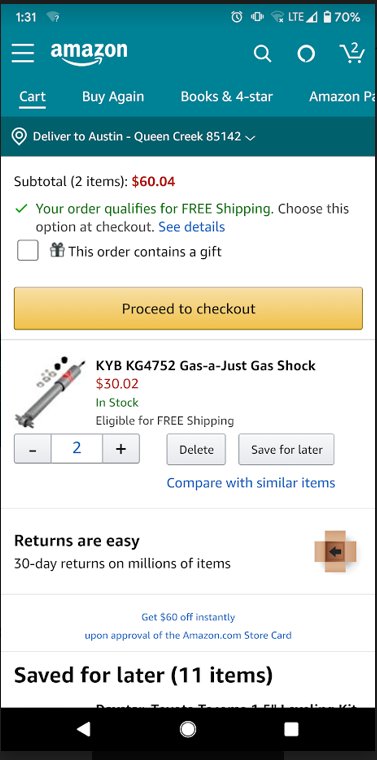

    get paid tomorrow and about to pull the trigger on these as I'm starting to work on suspension and lift. Heard good things about KYB, anyone have experience? I'm pretty sure my PO never changed the original shocks and I'm at 114k miles on the truck. Has a lot of body roll and bobbing on freeway speeds and want to tighten things up.

    Should be a decent set. I've got KYB on my 4Runner. Not soft but not as stiff as Bilstein.

    Just the answer I needed, thank you i appreciate your help!
    This thing still rides super squishy like a car and I'm hoping the shocks will be the first step in the right direction. I plan to do v6 coils with the spacer up front to get started on the truck after these. I do go camping/outdooring and bog the bed down often so the stiff front end is what I want. (Drove a late 90's v8 Ram with a coil spacers in the front prior so that's the ride quality i enjoy for reference lols)

    I just ordered KYB Excel-G's. I'm also bouncing about and feeling all the cracks in the road.

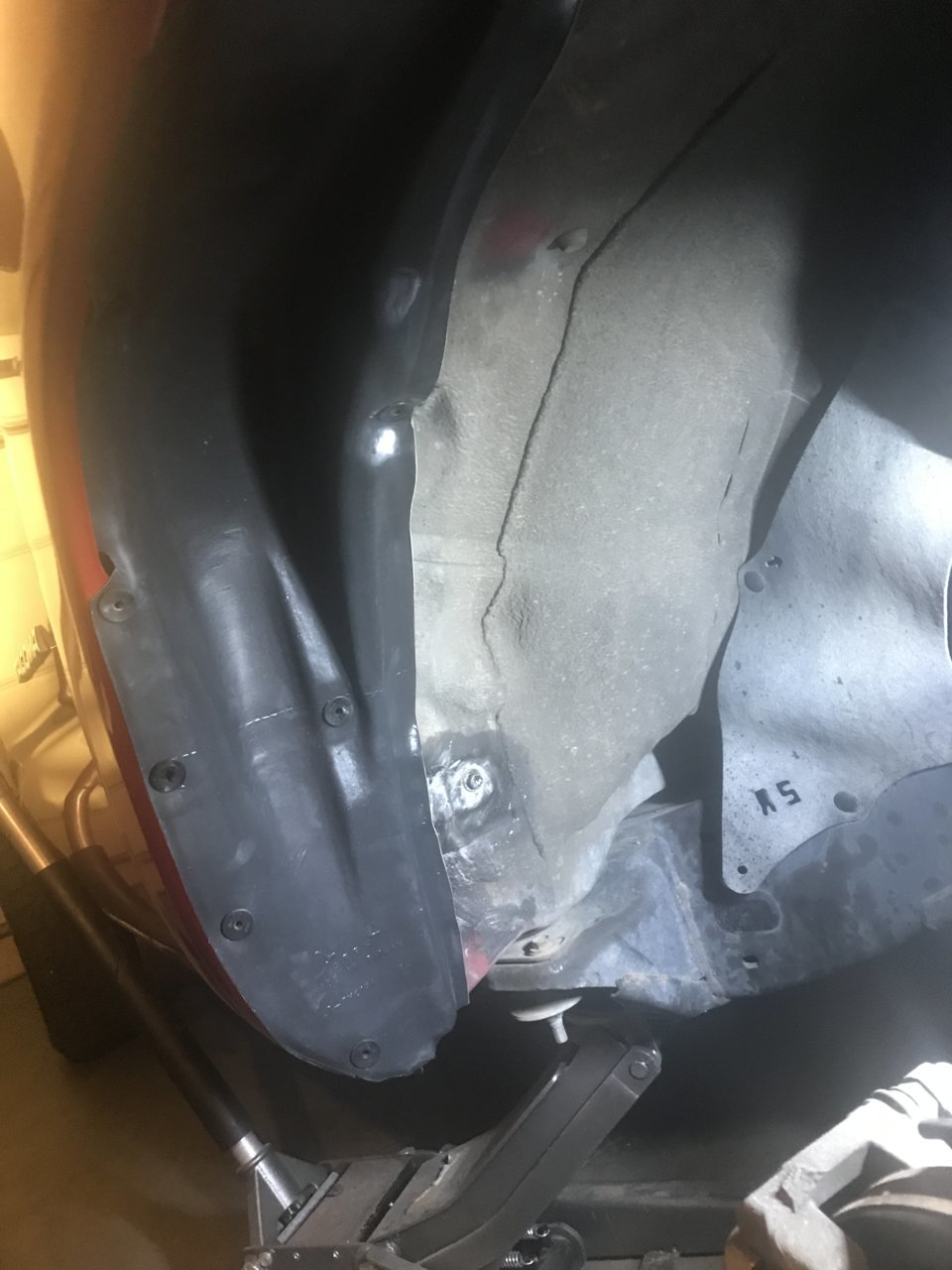

    Just an update on the 4x4 Tacoma front fender liners. I got it installed today and it fit perfectly. Gives you that factory look when you remove the black boxes. I bought mine on eBay for $17 a side. (Aftermarket brand)

    Do you have a link? I couldn't find it on ebay for $17 a side.

    Here is the passenger side https://www.ebay.com/itm/Splash-Shield-For-2005-2011-Toyota-Tacoma-Front-Passenger-Side/371496028556
    Driver side
    https://www.ebay.com/itm/New-Front-...fits=Model:Tacoma|Make:Toyota&epid=9005189735
    pair in the same listing to make it easy
    https://www.ebay.com/itm/Fender-Lin...fits=Model:Tacoma|Make:Toyota&epid=1278910761
    you will also want to buy 20 or so Toyota fender liner push pins. I was only successful getting a handful out without destroying them. I wasn’t very patient, I suppose if your really careful and take your time, you count potentially save most of them. I ordered them from my Toyota dealer.

    Thanks man. My front ones are bowed at the fender clips. Will be ordering these

    my rears were shot and fronts weren't far from it and I did KYB all around. Much better ride, but still not 'soft' like a car. You may need an angle grinders or dremel tool to get the front shocks removed at the top. The bolt sheared off on both sides so I just had to cut them out.

    Glad to hear the KYB seem to be a good choice and they helped your ride quality. Happy to hear it's not soft either, looking to go the opposite and stiffen my ride a bit. Granted will be adding a spacer and v6 coils this Christmas so a lot will play into factor with my case. Thanks for the information

    I didn't have a problem with the tops. The lower bolts on the driver side was a PITA. Both bolts sheared off and I had to weld on nuts to get them off. Besides that it was an easy install and the ride was a vast improvement. I actually still had a Toyota Tokico shock still on the passenger side.

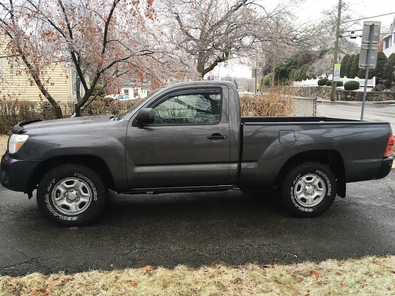

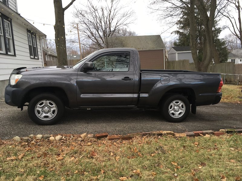

    I’m new to the forum and I would like to thank everyone who gave advice about switching from the stock tires to 235/75/15s.
    Before:
    After:
    Some power loss, but not too bad I don't think. I have not tried driving on the highway with the AC running. That might be the true test. But it's December so it'll have to wait. Thanks again.

    Terc Nice pickup. Looks sharp.

    I think the oem tires are way too small for a truck, it looks foolish. 235/75/15 is a “normal” looking tire imo
