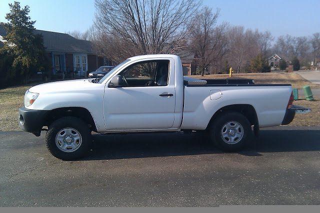

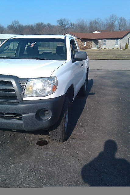

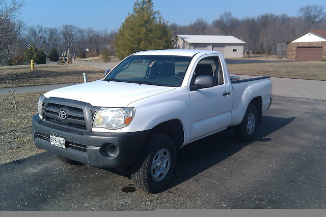

    Great idea for this thread.
    Mine is just stock for now, but this will give me some ideas. I will probably end up going with the ReadyLift/Fat Bobs lift for mine and try to get some 16" wheels and some 245/75 all terrains or something. I'm trying to get mine paid down some more before I can justify heavily modding it...

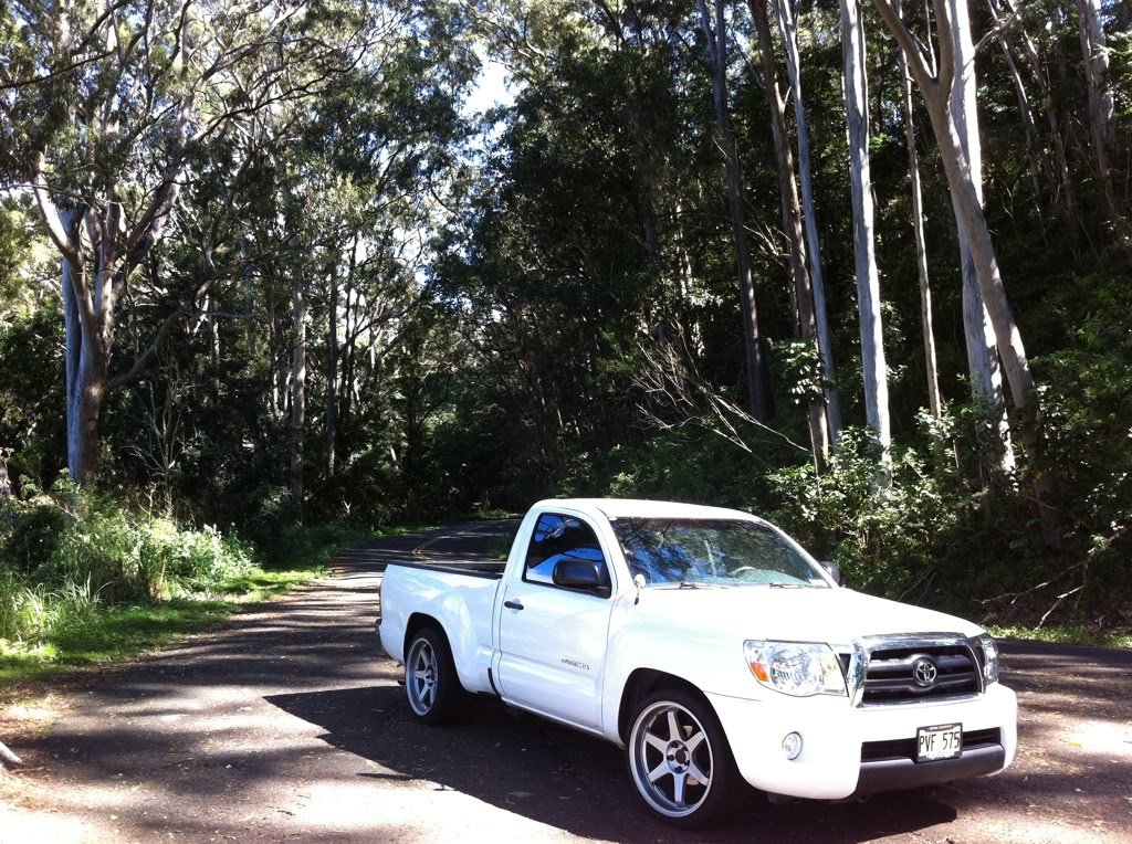

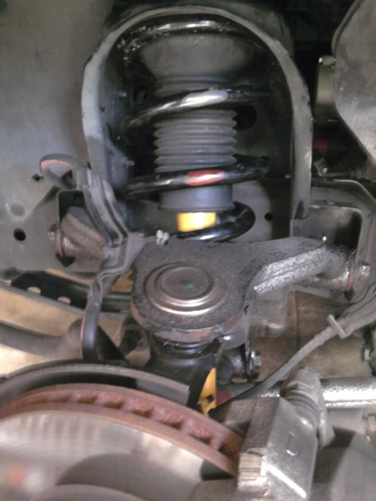

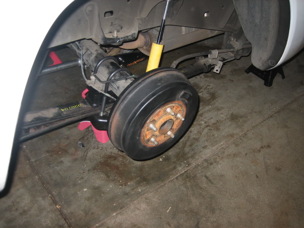

    My Setup: (3"/3.75" Drop)
    Front:
    DJM Upper and Lower Control Arms (3" drop)
    OEM XRunner Springs and OEM XRunner Bilstien Struts (.25"-.5" Drop)
    Rear:
    OEM 6 Lug (4x4/PreRunner) Leafs (1.5"-1.75" Drop)
    OEM XRunner Bilstien Shocks
    Streetacos 2" Tapered Steel Blocks w/ upgraded U-Bolts
    Energy Suspension Low Profile Button-Style Bumpstops
    DJM UCA and XR Strut & Spring Combo
    2" Tapered Beef Blocks w/ 6 Lug Leaf pack & XR Bilstien Shocks

    kelson your's is my favorite lowered tacoma by far.
