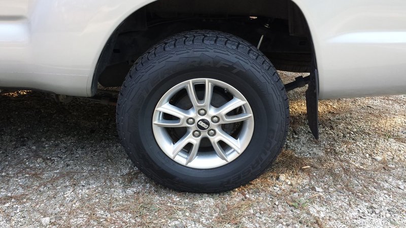

    These rims were on my truck when I bought it. I wasn't able to get new ones when I did my lift and tires, and am probably not going to until I can get some other mods done first. They have an unknown positive offset, and I have some rub at full lock. (The black boxes are gone). Can anyone give me some suggestions on what spacers to use for these?

    5x114.3 bolt pattern is one of the most common patterns used, so any tire shop should be able to set you up with straight-forward .25" spacers, or whatever you need to make that clearance up.

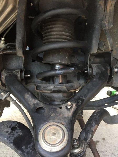

    I'm installing mine right now. Is it normal for the uca to touch the strut? Both driver and passenger sides are touching a little.

    Is everything back together in the pic?

    Yes but it's on jack stands. And when I was maneuvering in my driveway there's little clunking sounds sometimes.

    No - mine are roughly centered. There is something definitely odd/off about the above photo. I did not install my own, so unfortunately i can't offer further advice.
    Would changing the LCA bolt-cam position to bring the strut away from the UCA, work at all? I think that's where a full front end alignment might come into play..

    I know it was close up on the jack but I don't think it was touching. Maybe it was. There's clearance when it's on the ground, but I don't know what would be clunking.

    The nuts are missing from the uca bolts are missing plus the right one is not all the way in. Was the pic before you finished up?

    Yes the pic was before I finished. I'll take the wheel off and look at it again.

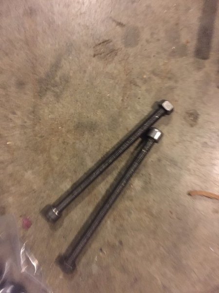

    Also my kit came with four very long bolts. The fat bobs website only shows two short bolts. It still fits but I would have to cut them down.
