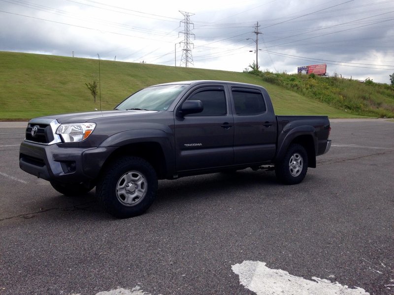

    Hello is to much lift 2.75 front 1.25 rear with 235 75 15 tire? It looks good?

    Hello and welcome! That's not too much for those size tires (you can definitely get bigger tires with that lift). I am running 235-75-15 tires with my lift and I have no complaints!

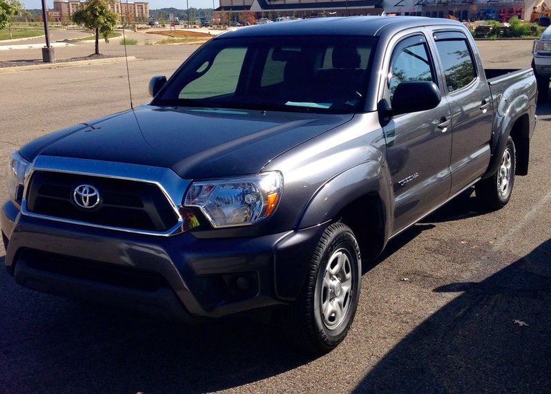

    Hey I am new here. Just put a Fat Bobs standard AAL lift with shocks on my 2014 double cab 5 Lug. Also put 235/75r15 General Grabber AT2's. It looks much better. Only thing that is bothering me is the back is sitting lower than the front. Any suggestions on how to make it level from front to back? Before:
    Thanks for any help!
