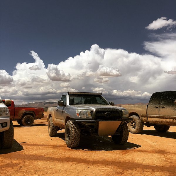

    2014 Base Tacoma access cab. 1994 Toyota pickup long travel
    My total chaos uppers with sway away 6" reservoir coilovers
