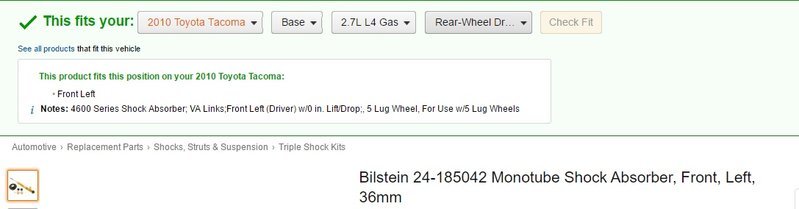

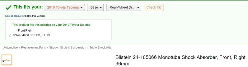

    The Fatbob's shocks are likely Pro-Comp shocks. Pro-Comp shocks/struts are white.
    I have the Readylift SST lift/level kit, part no. 69-5510, specific to our 5-lugs. I paired up Bilstein 4600's p/n's 24-185066 and 24-185042 to the front end, 1 each.
    The Pro-Comp and the Bilstein shocks should be interchangable - only close to OEM strut length is going to fit - the Bilstein 4600's are direct replacements, lifted or unlifted. The height increase comes from the spacer itself. The Bilstein 5100's fit on the rear, only. Part No. 24-186728.

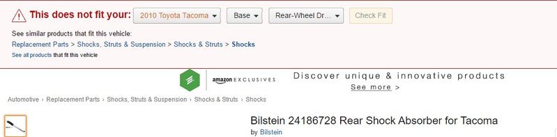

    The part no. is what is important. My struts up front are yellow, i'm not sure what color the rears are - I didn't do the install, or for that matter do the unpackaging. The part no's are straight copy and paste from my project record.
    The 4wheelparts database is going to throw up a "won't fit your vehicle" with our 5-lugs .. without the AAL in the suspension, technically 5100's aren't supposed to fit on the rear-end.

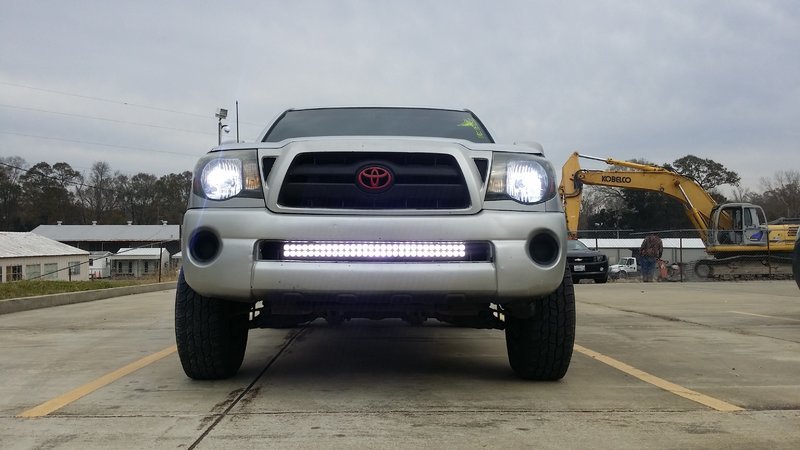

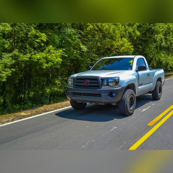

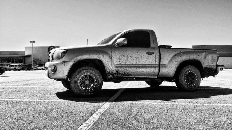

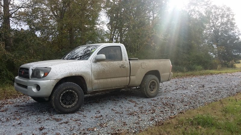

    Just the spacers up front. Nothing in the back. Sitting on 30x9.5x15 cooper at3. Running 15x9 pro comp 7031 rims.

    Looks amazing

    Thanks man. Sometimes I wish I had bigger tires for it, but I don't feel like putting anymore money into it. Better off to just let the next owner deal with that. Your's looks real clean as well. :headbang:
