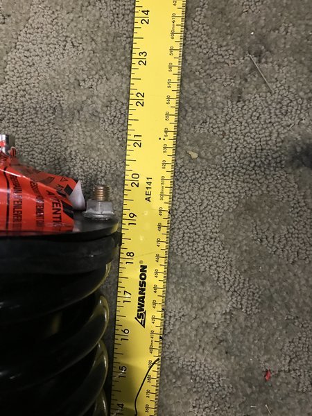

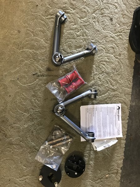

    1 day . They had 1 pair left after I bought mine. That might be a day to late. How ever they would be easy to make. Just need to find the ball joint with the snap ring housing . The housing looks like cut pipe but has a groove cut for snaprings. and could weld the pipe to that . Everything else is just straight pipe no bends. Thought about making them but didn't know the actual size. So I was forced to buy. So if anybody wants measures let me know. I can get them.

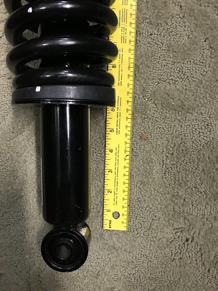

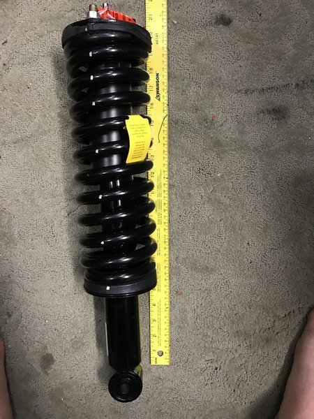

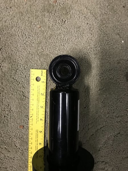

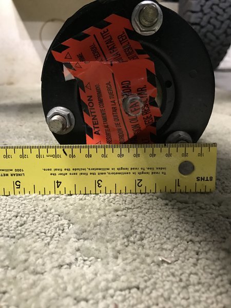

    Well the strut came today. Good news and bad. So I'll tell you the bad . The strut is the same length as are strut with spacer. But the spring it hangs down two inches lower then are strut. So the uca is the deal breaker. It's going to rub. Those fucking control arms. I didn't test it just took measurements. But are strut has less spring length to clear Uca . So the spring sits higher. If you can get that . . Good news if you have the aftermarket control arms this could be a cheap fix to having to buy those overpriced coilovers. So next step is finding coils for the bilstiens 5100's 1st gen strut and giving that a try. If you want pics or measurements just ask.

    pics of .. no side by side or install . haven't had any time (work) .. should get a free day this week. all there is is a strut in the box right now.

    i don't really have time . have to work to pay the bills. And these over priced control arms i just bought. if you (other , 5lugers) didn't live so far you could just build them with my tools. and your supplies . id share. and the welding if that was an issue id show you how to do it. Even if you made your own there still like 400 for the parts. . if you wanted to pursue this on your own. go to Kartex.com and go to the fabrication section everything you need is there. and other cool stuff as well . for building stuff.

    I know we've been hounding you with questions but could you post the measurements for the ucas for if/when anyone decided to do it. Also someone in the future my be looking for that kind of information.

    Thats all I got right now. Haven't had time to mess with it. The tape is center with the bolt hole. So if you measure just center tape on bolt center.
