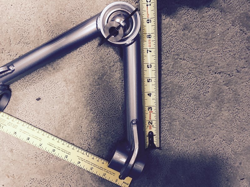

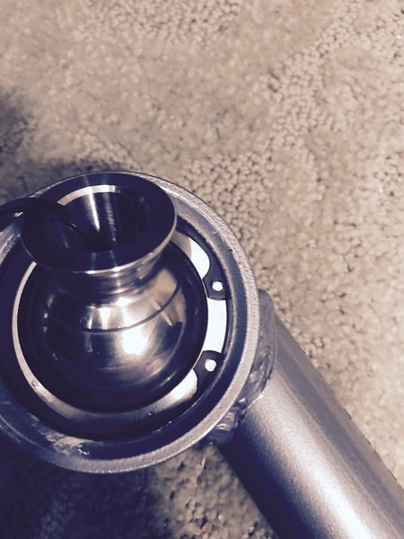

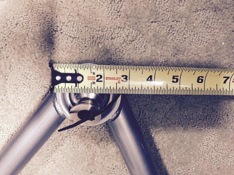

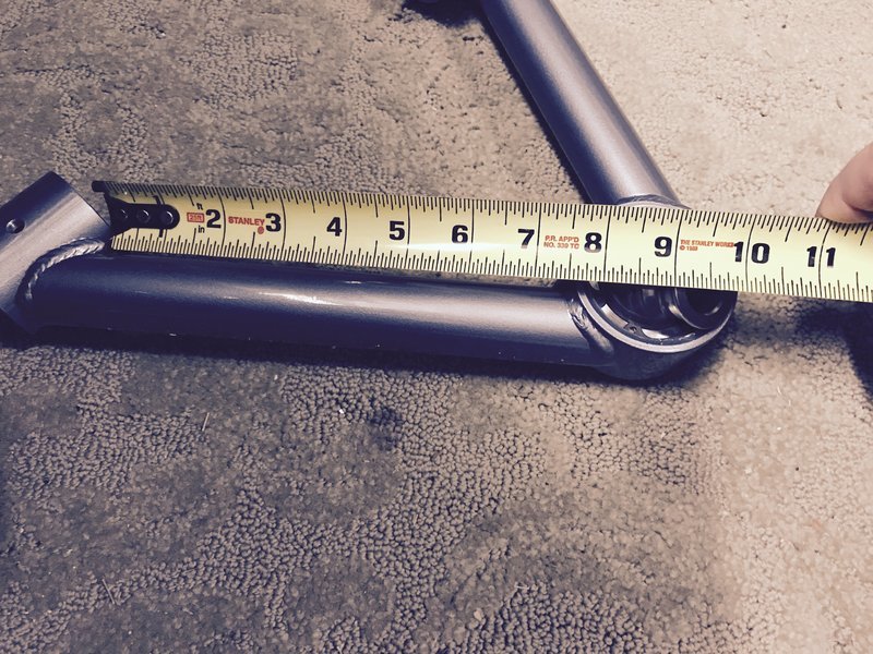

    sorry been busy. just ask for a specific if this don't cut it.

    Thanks for the pictures. So are these just longer than oem ones or is there a different bend to it as well. What if you just cut and add an extension to a junkyard set? I was thinking the same for a spindle too.

    I had to buy a OTC Front end service kit to take the ball joint out without damaging it. And a new torque wrench . Cause I broke the one I had using it as a breaker bar. It now jumps gears so not very accurate. So I'm waiting on that to come in mail before I can do any work. So it will maybe happen this weekend. Then I'll give you some pics of stock over aftermarket and you can get a visual. But I would say ya your guessing right longer.

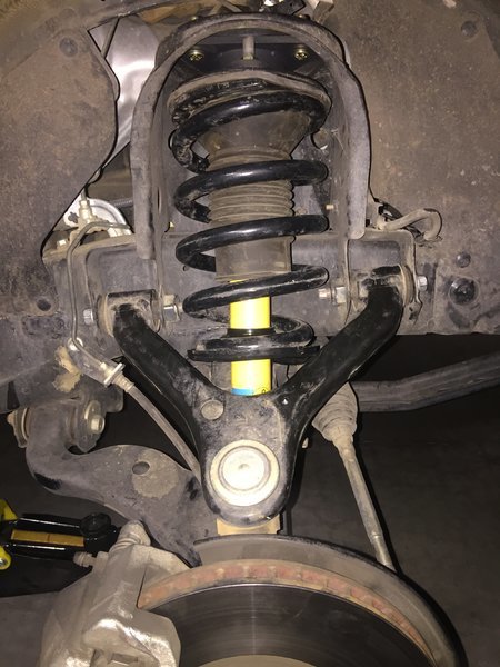

    Swapped my stock fronts for Bilstein 4600s
    Switch my Readylift 2.75 to a 3in spacer
    I didn't take a pic of the measurements, but after the stronger strut and spacer. I gained about 3/4in.

    does the taller spacer have a name. measure from center of hub (cap) to fender . and tell us the length . Please.

    Just an eBay brand called Lift Option.
    21 1/2in from Center Hub to fender. Second pic looks off, but just the angle of the picture.
    35 1/2in from ground to fender.

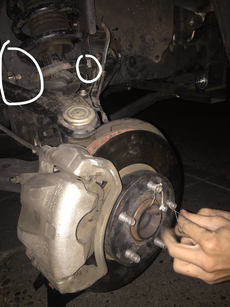

    NEED HELP
    I guess I didn't tighten one of my UCA bolts enough awhile back and it fell off today when I hit a speed bump. Left part of my Passenger side UCA came off causing my truck to veer left. Nothing broke though. Was able to Mcgyver some parts together to get my truck home.
    Found the bolt, but what is the square nut called so I can get a replacement?

    sounds just like it looks . square nut . part #90173-A0003 there like a $1.50. next time use locktite red. thats what the service manual says to do. at least you weren't on the highway going fast.
