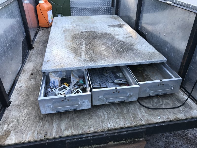

    I'm adding a aluminum draw system. And I know I will fill it with shit.(add more weight) So I'll probably be needing a 3rd aal. I have the long and short now. thought about buying another long and cutting to be a middle. Or that archive shackle thing to get my height. Back. Or maybe just buy those shock and axle leaf pieces and go axle over. But I'm afraid it will throw out the drive shaft and open that can of worms. Any body do that yet. Axle flip. If so can you post some pics at the leaf area. Here's the draw system got it from my grandfather for free it came out his tundra. So it fits great.
