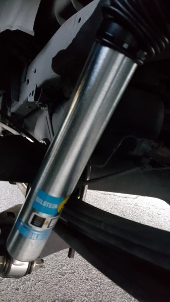

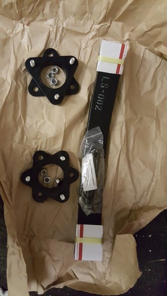

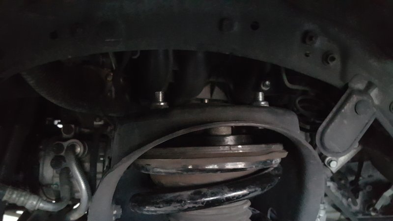

    •K&N Intake P/N: 77-9026KP •Black Badges •Toy Yoda Decal •TacomaWorld.com Decal •Four Banger Decal •BF Goodrich All-Terrain KO2 30x9.5xr15 •KMC XD Enduros 15x7 •2" Ebay Spacer Lift •1.5"-2" Ebay AAL •Longer U-Bolts from Fat Bob's Garage P/N: 5L-UB •Bilstein HD 4600 Strut (5 Lug): Left P/N: 24-185042, Right P/N: 24-185066 •Bilstein 5100 Rear Shocks (6-Lug): P/N: 24-186728 •UWS Toolbox P/N: TBS-63-A-LP-BLK •Lots of Patches •Uniden Pro505XL CB Radio
    20170306_054838.jpg 20170306_060041.jpg 20170306_055910.jpg 20170306_055929.jpg 20170306_055934.jpg 20170225_204607.jpg 20170303_152040.jpg
    2" Spacer from ebay seller xpowermotor
    1.5" - 2" Add-A-Leaf from ebay seller xpowermotor
    BF Goodrich All-Terrain K02 30x9.5x15
    KMC XD Enduro 15x7
    Thank you ANTHONYK0928 and MountainDrew for the help :D

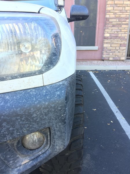

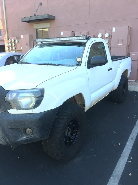

    No rubbing full turn either way. I know it'll rub when I flex though.
