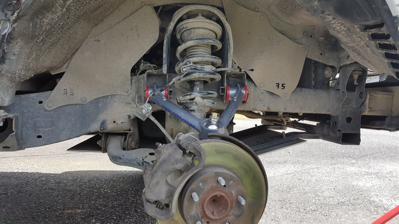

    Finally tossin the stock uca's

    Wrong side... Unless TC is doing some sort of specialized positive (+) caster set up for some reason.
    I might also be too used to working on trophy truck suspension at the same time.

    :spy:...
    So thats why i had to swap sides this morning, hah if I only read this last night. My first time touching ucas lol

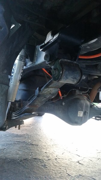

    I've finally joined the shackle squad after a couple of days on Jack stands.

    Looks like good is never good enough. I want to add the shackle flip and get that little bit more lift to make the rear an inch higher to even it out. I will not be off road. Is it important to add longer brake lines?
    Is the ATO shackle the same for 6lug and 5lug Tacomas?
    Thanks for any feed back.

    Yeah extended brakes will come eventually and yeah the shackle flips are the same for both 5 and 6 lugs. I like having the extra 3/4 for my fox shocks.
    If your going to do this yourself I suggest a torch or having a shop do it. If I did it again I'd go shop all the way lol.
    Also I'll add a photo to my progress thread after the leafs settle a bit

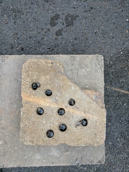

    8 rivets, its just 8 rivets to get to the shackle flip. Shackle rivets.jpg Rivet Heads. It took 8 dremel blades, angle grinder air chisel two hardened steel drill bits small sledge with 3 pry bars two drills and a few other things. Once I got the heads off I tried to punch them through(like they do in all those youtube vids so easy) Those things don't budge sooooo the 1/2" drill bit came out with some oil to lube the bit. those drill bits spray some sharp shrap metal. Wear the goggles. Whole thing took about 6 or 7 hours.Shacle Flip3.jpg Shacle Flip1.jpg Shackle Flip.jpg
    It lifted my rear at least an inch but, I think it is more like 2. Definitely worth it.
