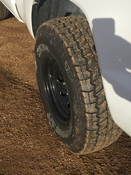

    Nice upgrades! I think I slashed a tire off-roading, or someone slashed it. So had to get new tires, got all terrains now. I could hear my engine struggling now kinda sucks, I liked hearing my howling mts, couldn't even hear the engine lol. Didn't notice it was that bad. I'm gonna need a regear sooner than I thought. I was thinking we should make our own shock towers instead!

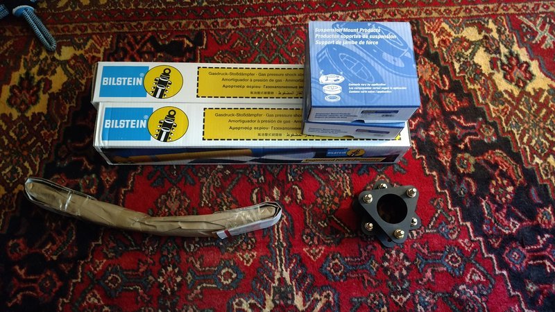

    Hoping to install my Chinese/eBay lift kit this weekend. I don't feel like I have to justify my decision to go cheap, but FYI this is a clapped out old beater. (250k). If I had a nicer truck I would have gotten something nicer. Also, those 13 year old Chinese kids are getting really good at welding. Also also, it's such a simple design it's hard to fuck up.
    My other vehicle (RSX-S) is in the body shop, so I need to have it back together by Monday. In true shade tree fashion I will be wrenching in the backyard, laying in the dirt, cinder blocks as Jack stands, smoking cigarettes and cussing.IMG_20170502_184535949.jpg
    I got new 4600's, and Moog strut mounts and bushings for the front. For the rear I got some used (27k) TRD Bilsteins. Not sure if I should replace any bushings out back. Input is appreciated.

    So I off-roaders on my all terrains and they didn't even chirp, when I had the MTS they would Chirp a ton going up steep hills:)

    The thread depth is same as my MTS when they were new:)
