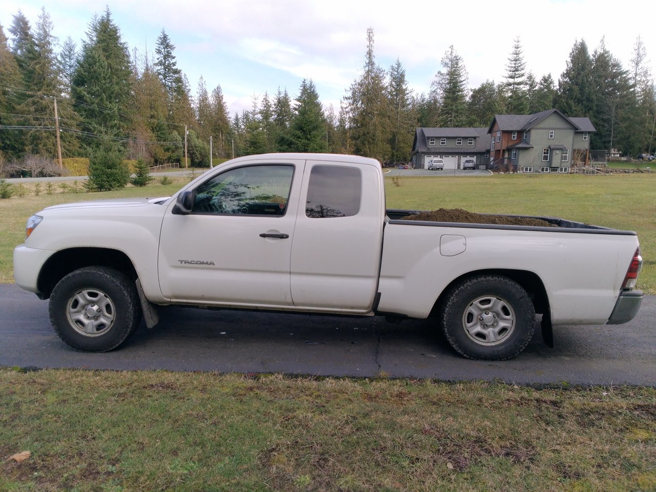

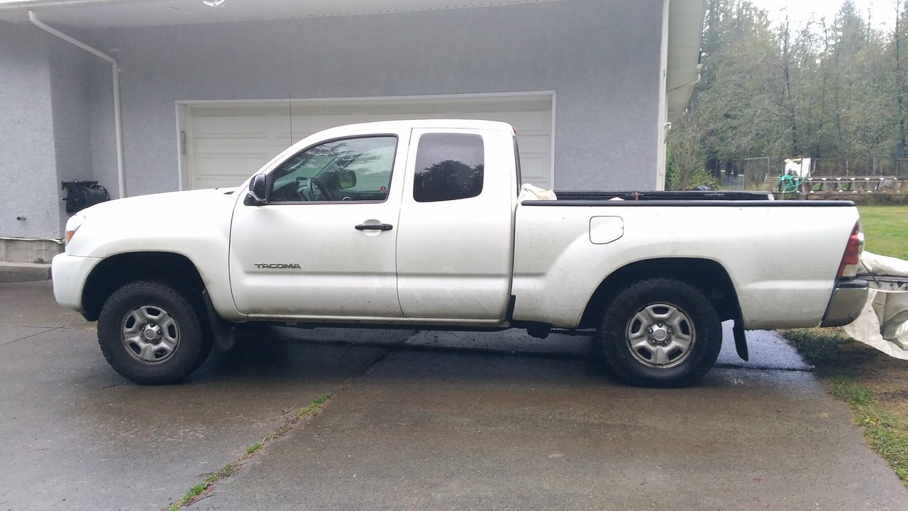

    AlbergSteve
    AlbergSteve Member
    Nov 2, 2017
    #234874
    7
    Vancouver Island
    2011 Access Cab 2wd
    ReadyLift w/AAL AT2 LT235/75/15 Bilstien 4600's EBC brakes and rotors Timbren bump stops at the back
    I have 4x4 5100's on mine with the Readylift kit with the AAL and they work fine except under heavy loads. A month or so ago with a LOAD of firewood, there was a lot of clunking in the back which I assumed was the longer shocks bottoming out. Solved that problem last week by installing Timbren "bump stops". The first pic is about 1700 pounds of road base in the back without the Timbrens, the second pic is the same load with the Timbrens.

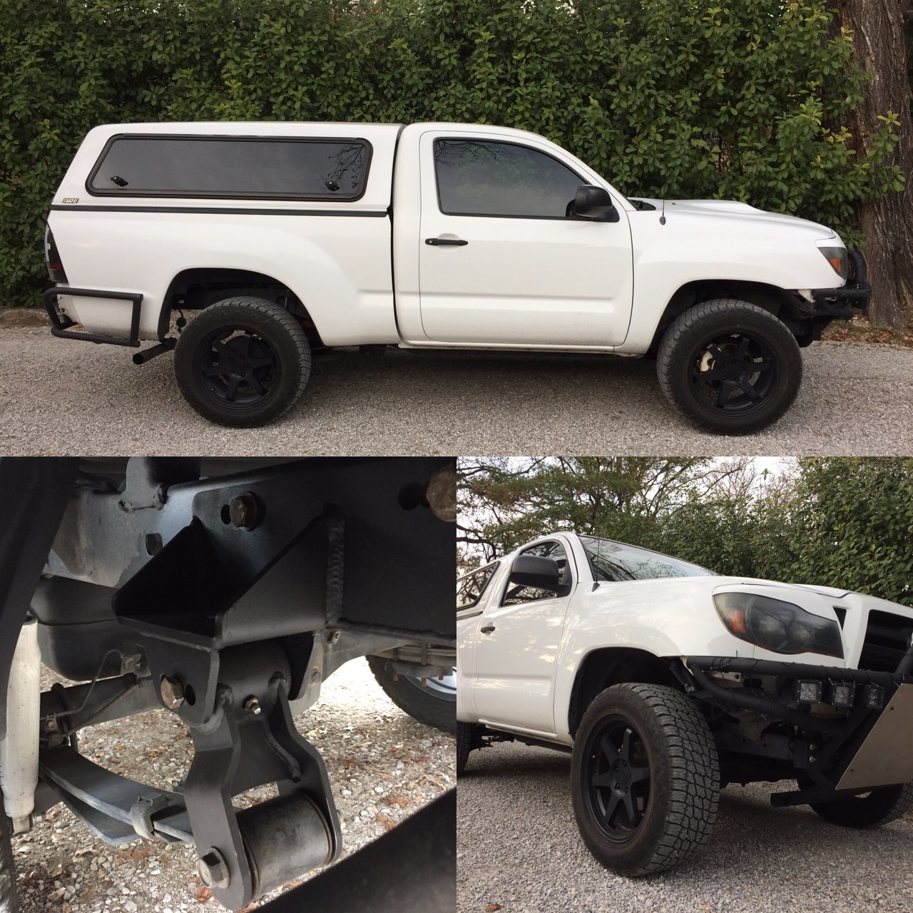

    Kavik
    Kavik Kavik
    Jan 30, 2012
    #71810
    3,360
    Texas, DFW
    Not your everday 5 lug
    Lowered: 3 inch drop blocks (Beefed Taco),Satoshi Grill, Morimoto bi-xenon H1 Retrofitted headlights, Flowmaster exhaust, Blue LED interior and exterior, blue LED dome light, Anzo black LED taillights, Hifonics Brutus 1100w Mono Block, Bazooka 300w Amp, LED license plate lights. Lifited: Fat Bob's rear shocks, Fat Bob's 3" spacer and rear AAL, Nitto Terragrapplers, weldertaco wrap around rear tube bumper, TrailWorx Fab tube front bumper
    Pics after the ATO shackle flip and aftermarket extended shackle install.
    Follow @5_lug_stud on instagram for more!

    #779
    Kavik
    Kavik Kavik
    Jan 30, 2012
    #71810
    3,360
    Texas, DFW
    Now I need bigger tires. :goingcrazy:
