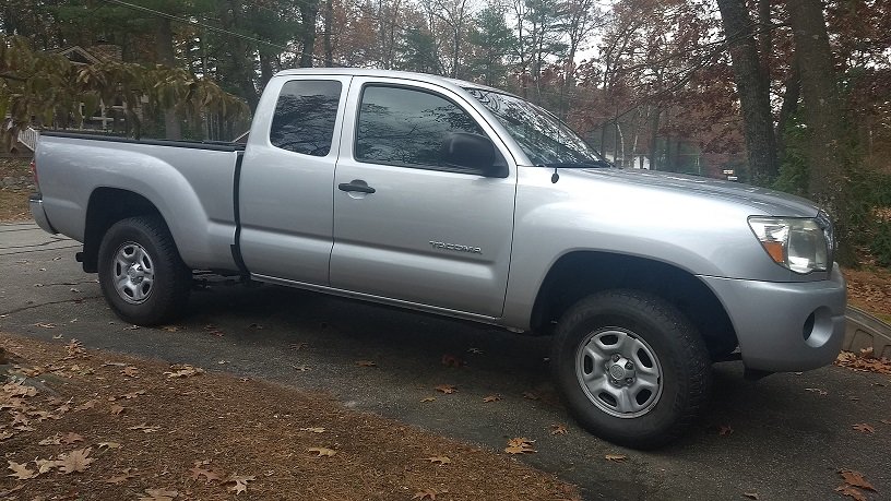

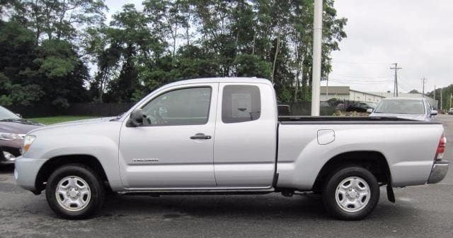

    Finally got my ebay lift, new Bilsteins, and 235/75R15 snow tires installed over the holiday weekend. It definitely makes if look and feel more like a real truck now. (Before and After below)
    One thing worth mentioning is that I bought a U-bolt kit from Fat Bob's that said it was typically used for lifts on 05+ 5lugs, but it did not fit. The U-bolts have 3 1/2" diameter, but it looks like my axle is only 3". Luckily, the original U-bolts barely still fit with the AAL. I am trying to see if Fat Bob's will let me return them.

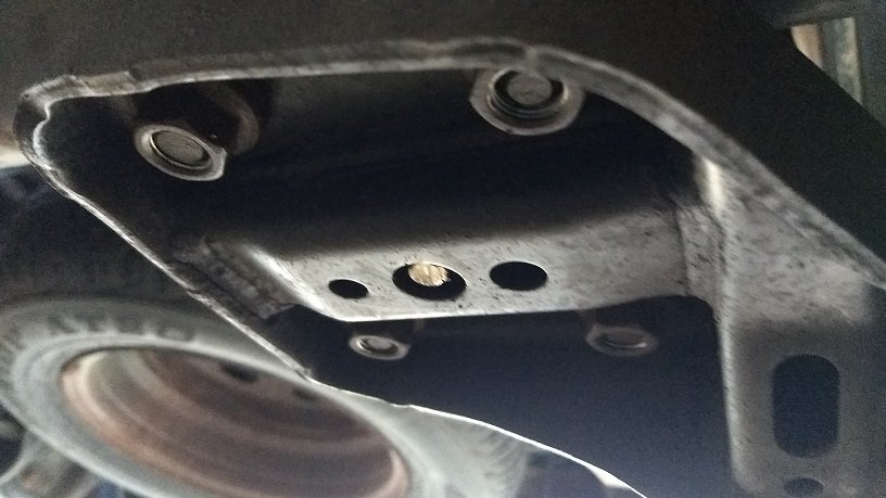

    I don't have a pic of the one's I sent back, but they would have been very loose on the axle and besides didn't fit into the holes on the bottom plate. They looked like they were about 1/2" too wide. Maybe its because I have a 7.5" differential? Below is a picture of my bottom plate now, and yes, I realized after taking this that I need to find longer replacements and swap them out ASAP.

    Lowered: 3 inch drop blocks (Beefed Taco),Satoshi Grill, Morimoto bi-xenon H1 Retrofitted headlights, Flowmaster exhaust, Blue LED interior and exterior, blue LED dome light, Anzo black LED taillights, Hifonics Brutus 1100w Mono Block, Bazooka 300w Amp, LED license plate lights. Lifited: Fat Bob's rear shocks, Fat Bob's 3" spacer and rear AAL, Nitto Terragrapplers, weldertaco wrap around rear tube bumper, TrailWorx Fab tube front bumper
    Yep, that is not good. In aviation it is mandatory to have 2-3 threads showing.

    In that case, I will try to keep my truck from going airborne. Seriously though, I am having trouble finding a u-bolts the right size. I measured the stock ones on the truck and it looks like they have about an 3-1/4" inside diameter. Does that sound right?

    I would measure the distance between the pass through holes in the rear shock mount plates. U-bolts can flex to different diameters but the distance between the holes will be the same. I had to bend my Fat Bob U-bolts in a bit to make the U-bolt pass through the plate.
    Did you torque those U-bolts nuts down to spec at least?

    Yes, I torqued them to spec.

    Funny thing is, I had an alignment done this morning. Dropped the truck off and went to breakfast. I kept expecting a call to tell me that my u-bolts were unsafe, but they didn't say boo about it. I had tried to find some locally yesterday, but struck out. I guess I will order them from Fat Bob's again once I get a chance to crawl under and triple check the size.
