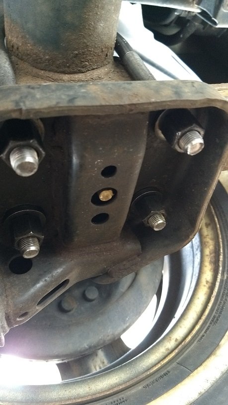

    Ok, I finally switched out the U-bolts. Looks a little better now, huh? BTW, it turns out the correct size is 3 1/4" W x 6 3/4" L .
    I'm a little confused about the torque settings now, though. The specs that came with my lift kit said 37 ft-lbs. However, I see some chatter on line that this was a Toyota typo and it should have been 73 ft-lbs. I am wondering if this is relative to 6-luggers and if they have thicker u-bolts. I stuck with the 1/2 inch bolts, so 73 seems a little high to me. I think over torquing them could cause them to snap under strain. For the time being, I decided to compromise and set them to 50.

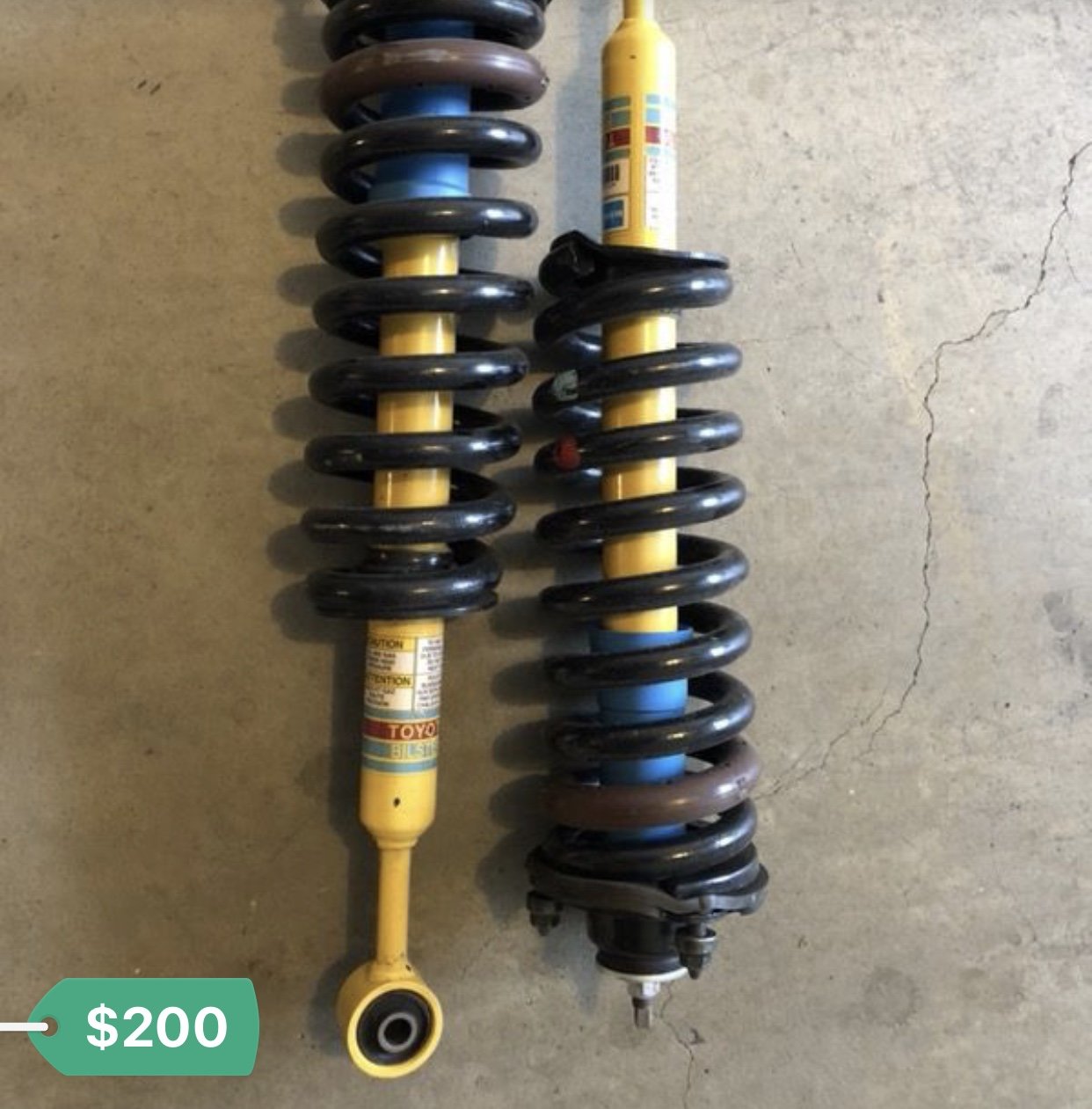

    3” ebay spacer 31x10.50x15R BFGK02’s
    These are off a 2016 tacoma.. does anyone know if they will fit 4 banger 07
