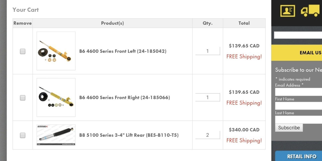

  16. Feb 19, 2021 at 10:16 PM
    #916
    96couv
    96couv Member
    Mar 13, 2020
    #322079
    22
    I would like to make these upgrades to the taco. My 5 lug is not lifted. Will these work?
