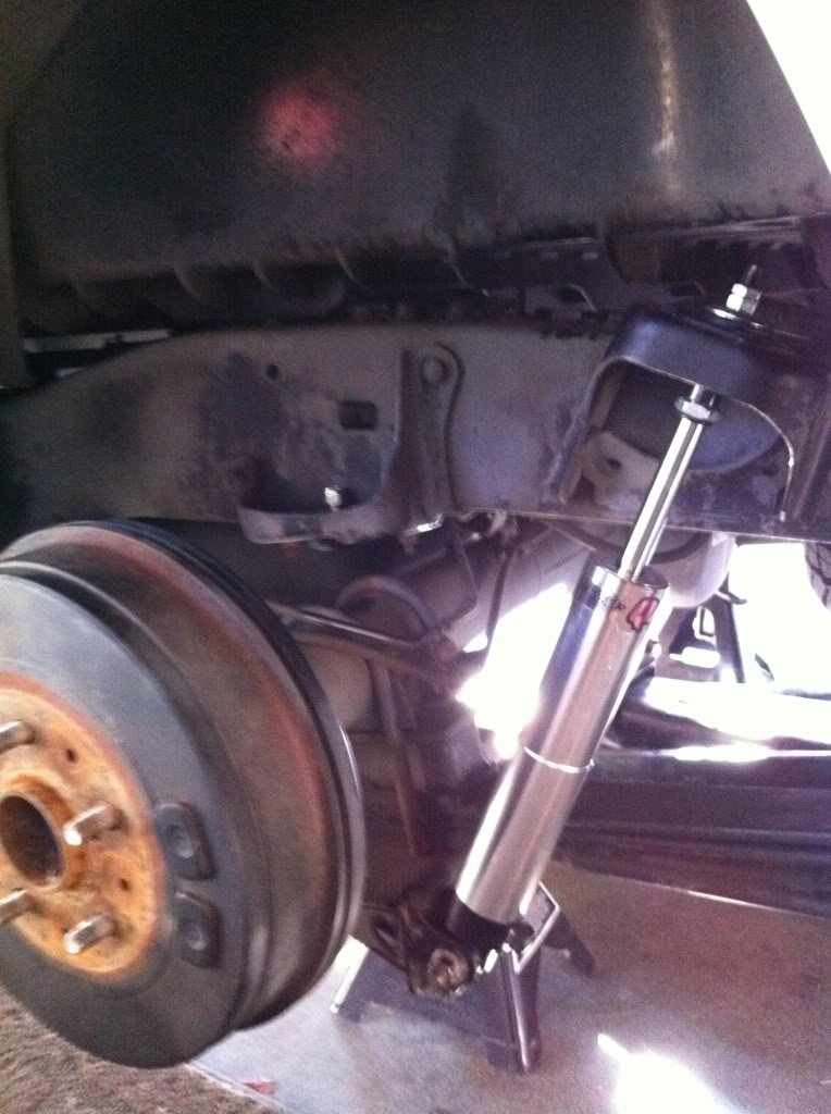

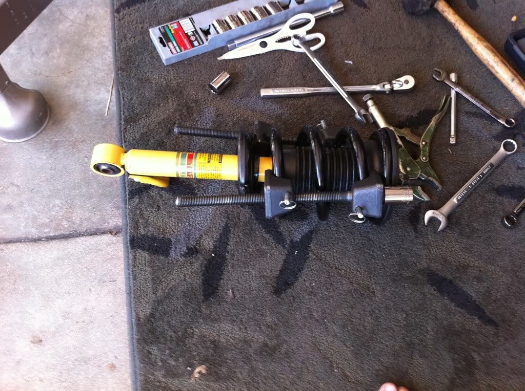

    new goodies on the truck :D
    Front:
    DJM Upper and Lower 3" Drop Control Arms
    Sittin Sic Stock Height 950 ppi Springs
    Bilstien XR Front Struts
    Rear:
    4x4 Leaf Pack
    StreetTacos.com Tapered 2" Blocks with Grade 5 U-Bolts
    QA1 TS703 Rear Adjustable Shocks
    Energy Suspension Super Low Profile Bumpstops
    SS Springs and Spring Compressor of Death!
    QA1's

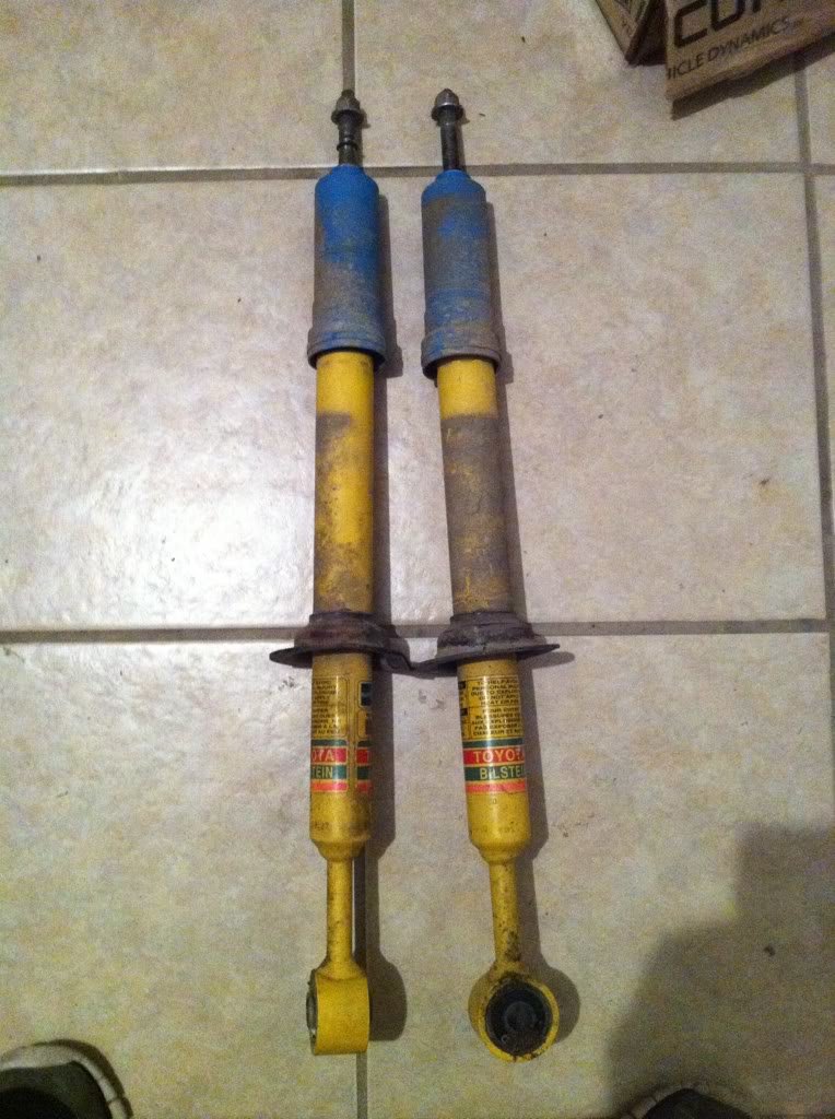

    My brother put on his new billies today and still has his front stock 2nd gen billies for sale I think I read some where that they fit 5 lugs.
