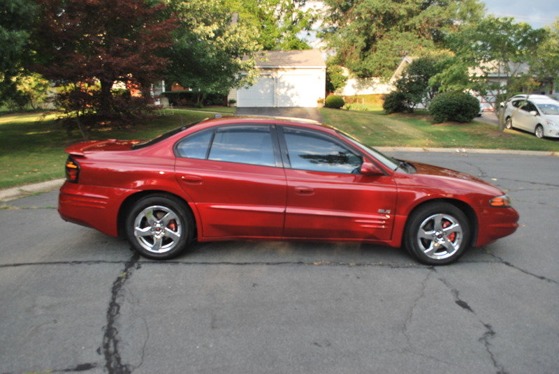

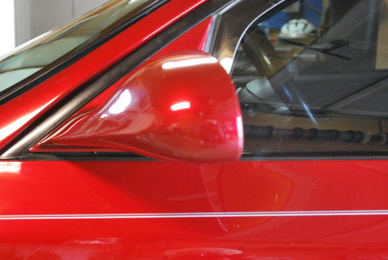

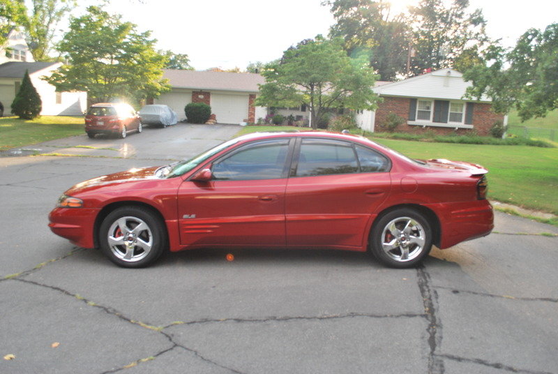

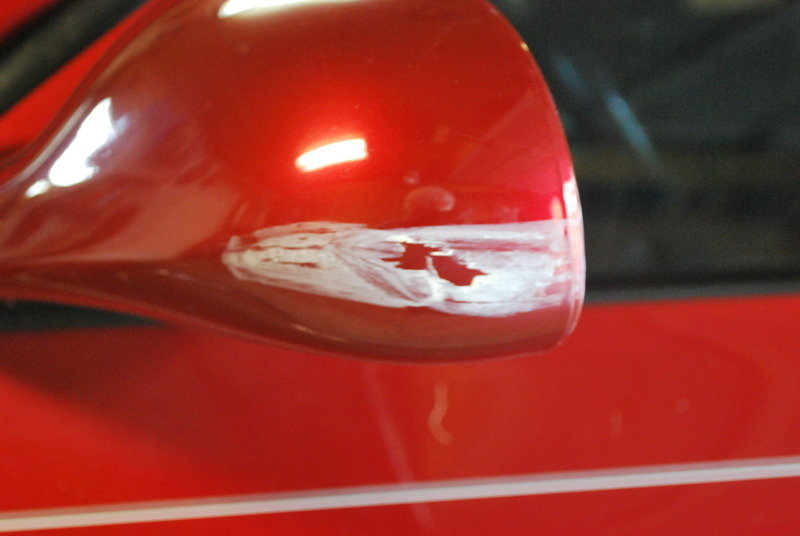

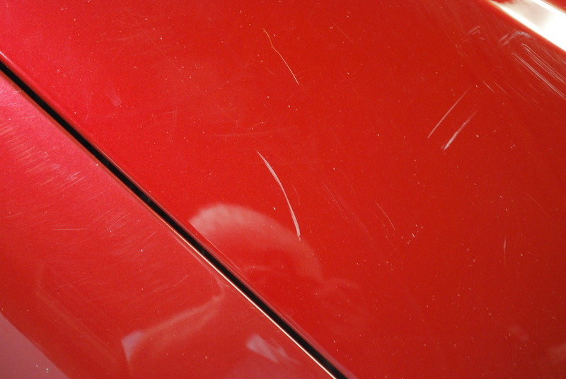

    I would like to recommend HD Speed if you are looking for a quick AIO product for your daily driver.
    Today I finally blocked off time to clean the exterior of our Bonneville. This is my first detail with an All In One, AIO, product. I was very impressed with the ease of use and the correction performed with one pass on a car body panel. I have a couple of before and after pics, passenger side front hood and drivers side mirror, as well as some finished pics. The wheels were a challenge as well. They were a mess. For the body I used a Rupes polisher with a blue microfiber pad. The speed was set on 5. The wheels and tires I used DuPont chrome cleaner followed up with DP Wheel glaze, the tires I used Zaino Z-16. Total time invested was just under 5 hours if you count the wash time. Tomorrow I will do the interior. We are off to Michigan later next week and I wanted the Bonneville to look its best. Not bad for an 11 year old car with 140 thousand miles on it.

    95SLE are you a hobbyist detailer? How do you like the rupes if you are not a pro...is it worth the money? Is it hard to learn to do paint correction with the rupes? I heard it's a bit forgiving...so thinking of getting it or something comparable.

    Detailing is a hobby for me but I do occasionally detail cars for friends. The Rupes is hands down the best machine I own and I have 4 buffers. I am really liking the microfiber pads.
