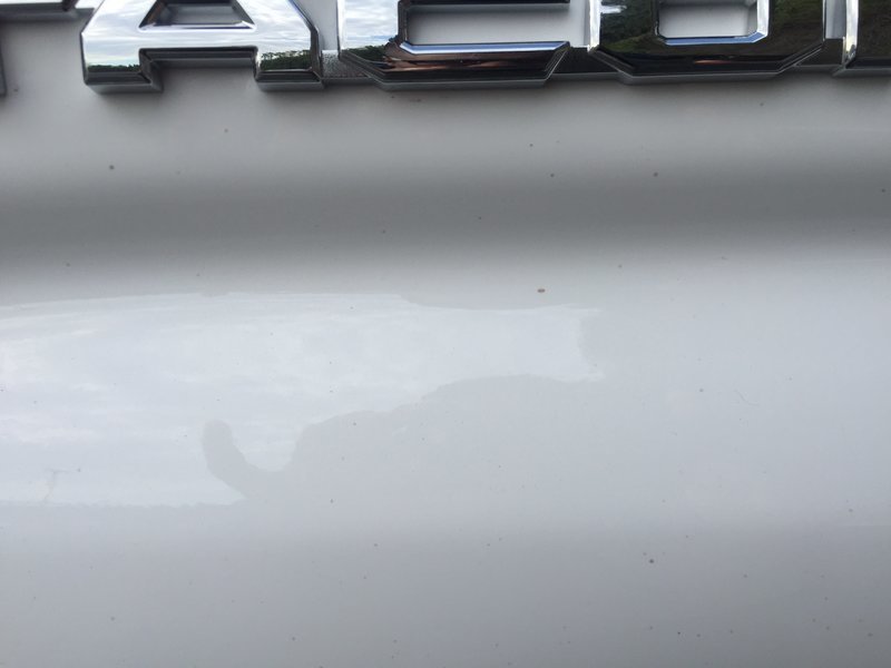

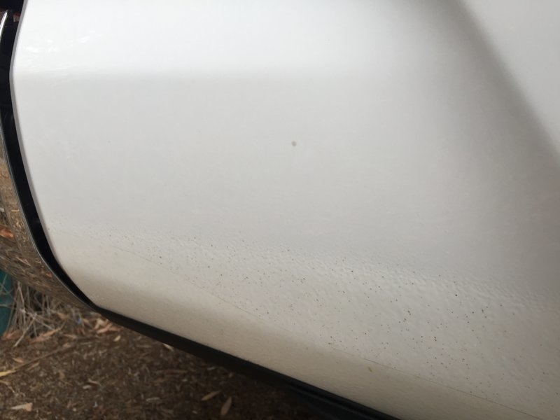

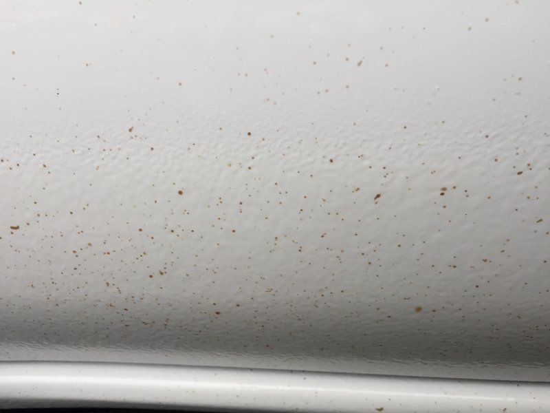

    Just finished trying a rubbing compound in one small spot and a clay bar with lubricant from the kit in another. Neither made a dent. Here are pics. It's as if the stains are residue from what I initially wiped away. It's strange to me the it would eat through the clear coat so fast. What the heck is in that stuff. I'm going to call armor all tomorrow and see if they have a solution. I can't be the only person this has happened to. I'm starting to think the post I read about the anti mold agents In the tires and the dressing mixing together, splattering and damaging white paint are exactly what happened here. I'm just really hoping I'm wrong.

    If you are Super White then the clear is mixed with the white when applied. That should polish out. Almost looks like rust specks in the pics. Where are you located? Maybe a fellow TWer can help out.

    stbear
    stbear Well-Known Member
    Dec 2, 2014
    #143541
    2,214
    SE PA
    2015 DCSB TRD Sport MGM
    Rust specs are what I was thinking too when I saw this.

    I think they look like rust specs as well. I've read two more outside forums mentioning both "rail rust" and also tire mold agents. I think it might be something I might have to take up with the dealer. I'm located in Irvine CA.

    it's at the bottom where Toyota spray extra heavy to put up with dirt and debris kicking up so it's hard to clean there...I got wheel splash from something that hasn't been remove after months.... but I don't clean at the bottom too well. I actually use a finger nail and slowly remove it away. Your brown rust / goo spots. Be careful if you machine polish that textured spot...you may burn through the high spots versus the valleys. have you tried to scratch it off with a finger nail to see what it is? Is it etched on or caked on?

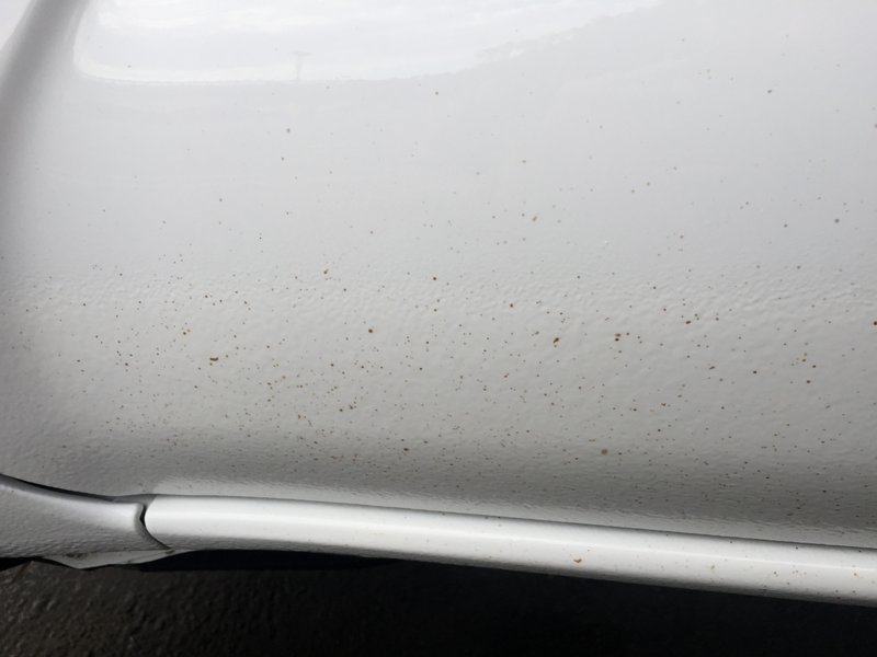

    @imom i think you're at least partially right. The majority of it is down in those textured spots on both sides of the truck. However it did make its way almost all the way up the driver door and up the side panel of the bed. Thinking back I noticed a few of these same spots from about a month ago when I washed the truck for the first time. I didn't think much of it. Just thought it was caked in dirt. It is completely smooth to the touch. Can't did at it or scratch it at all.

    If it was rail dust, it seems the pattern would be different. Your pattern is such that it seems most likely that the marks are from something that came off the tires?
