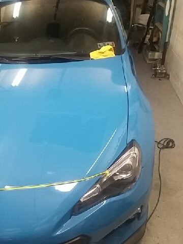

  6. Nov 2, 2016 at 6:27 PM
    #2646
    sy272004
    sy272004 Well-Known Member
    Sep 15, 2015
    #164344
    609
    West Chester
    15 TRD V6 4x4 DC
    3" lift. 33" tires. Headlight Retro, intake, exhaust
    +1 on cquartz, specialy uk version, can be applied in lower temps and easier, just finished coating my friends brz with it IMG_20161102_212650_01.jpg
    imom and ace96 like this.
