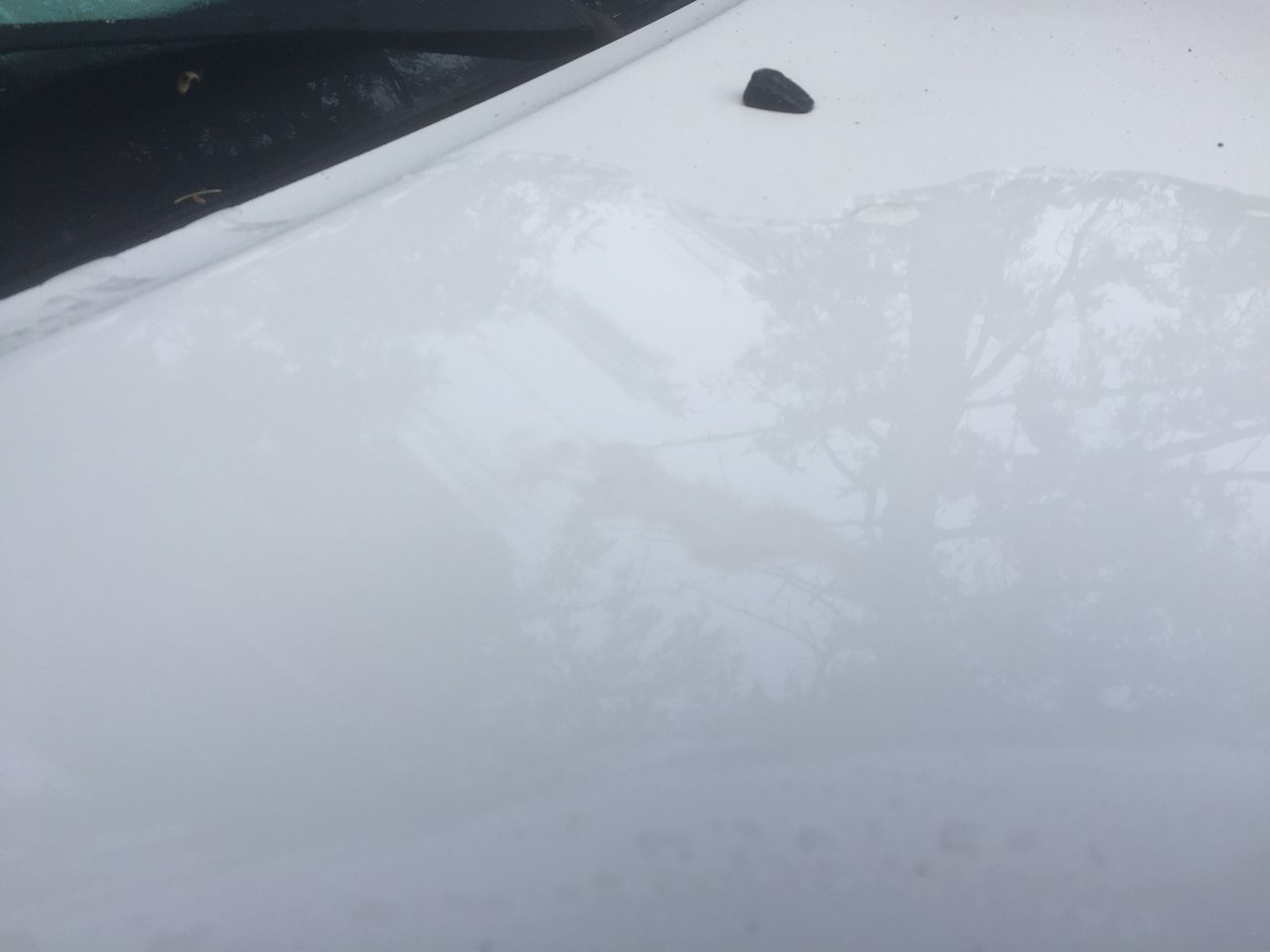

    So yesterday I washed and waxed my truck and I came home to see what appeared some tree sap on the hood. I attempted to wash it off and then use the NANOSKIN auto scrub fine grain mit to remove the sap and noticed what appeared to be the clear coat missing. I'm not sure what to do at this point and could use some suggestions. I have attached a picture to attempt to show the damage. Forgive the morning dew around the suspect area.

    The nanoskin probably marred the paint. One drawback to that particular product. Should be able to polish that out.
    Also, Toyota's white is a single stage where the white and clear are mixed together.

    So does that damage look like marring and wouldn't the damage (marring) be larger for the width of my hand going back and forth?

    Can you circle or point out the "damaged area". White is harder than heck to see any damage too, hence why it's the greatest color of all time.
    If its the spot I think it is, I would clay bar that spot with a medium/heavy clay. Use a clay luber and take your time. You might just have residual sap still hanging on the paint, I doubt heavy marring would occur in such an isolated spot when your hand would go over a muchlarger area. But it could it the contaminants in that area were causing the marring.
    Use clay. I don't trust that nano skin stuff.
    PS Dont park your truck under trees. Get a garage, truck cover, or a chain saw if you have to.

    It ended up being residue that my nanoskin couldn't remove. I was planning on getting a new clay bar anyways for tough to remove sections. Thanks for the suggestion.

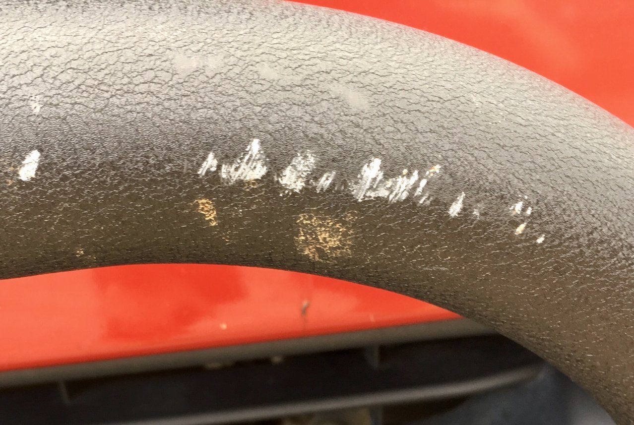

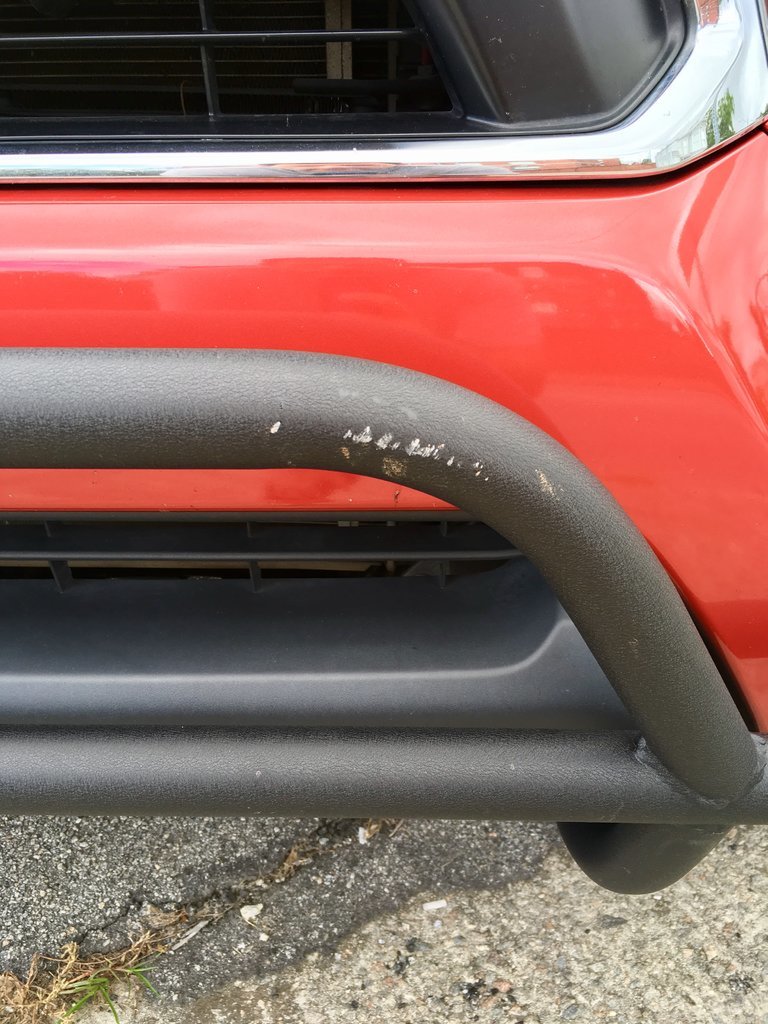

    First off, I'm sorry if this has been covered before, but a few searches and poking around didn't turn up any usable info. I need some help removing some paint transfer and light scuffing to my powder coated front bumper guard. It's a mat black textured finish; which I'm guessing is relatively standard. Any help would be greatly appreciated. FullSizeRender.jpg FullSizeRender-1.jpg

    do not let the dealer touch it, it will come out worse than before you took it in

    I'd hit it with a clay bar and see how far that gets you. Are you familiar with claying?
