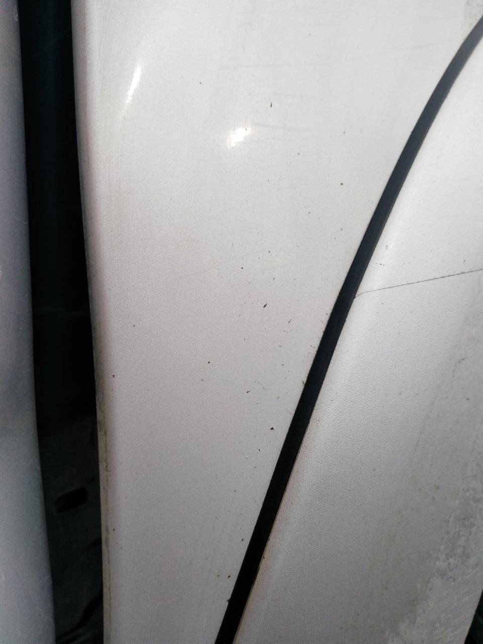

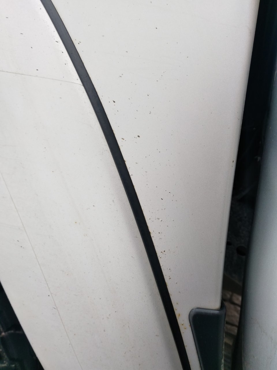

    What would you guys do for rust speckling on the rear fenders? This winter was pretty rough on the truck.

    Have you clay barred the truck?

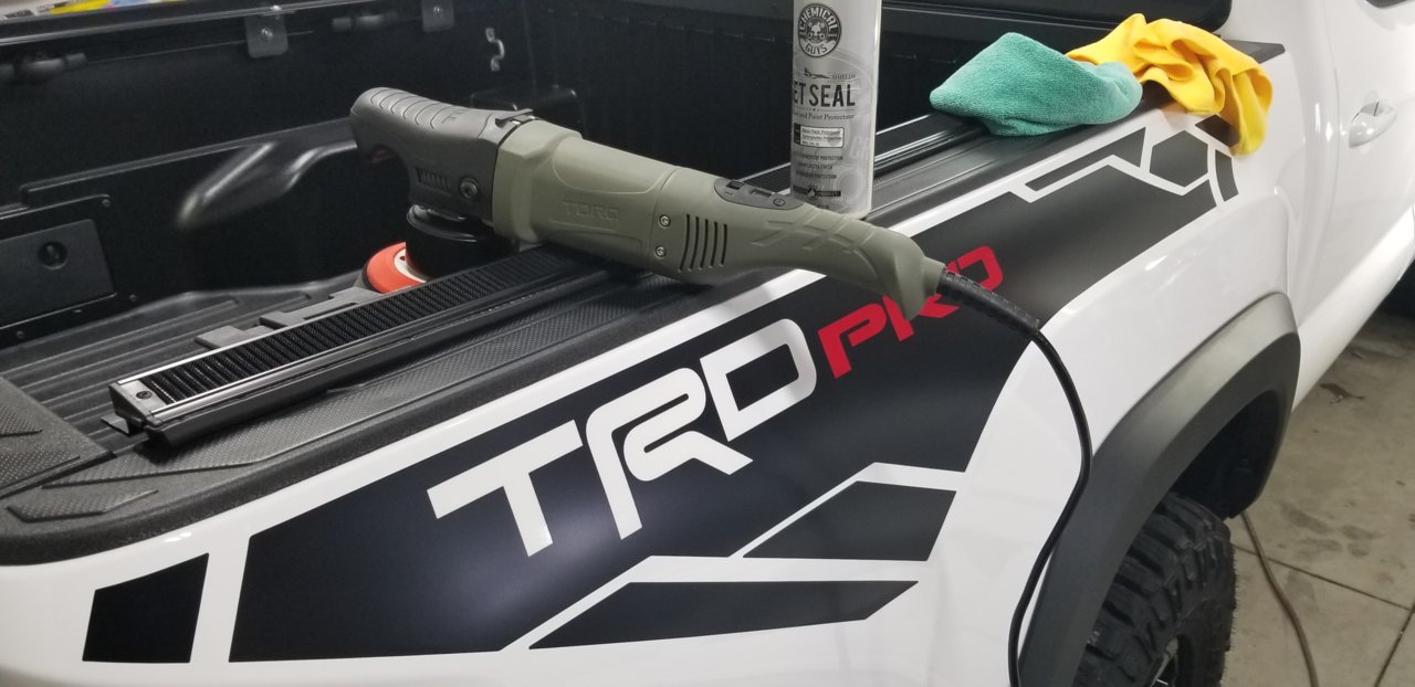

    Hey, I've also got a pro, clay barred and currently applying JetSeal. I'm so close to removing the decals, as others have suggested to make life easier. Haha. I've wasted a lot of time researching and think I may get some matte JetSeal.
    What did you come up with on yours? I avoided them and went by hand to get as close as possible. My ocd says all the painted areas need wax :annoyed:.

    What you have there is a combination of surface defects that can be remedied through detailing and a few that will require re-painting. The surface staining / contaminates can be pretty easily removed with clay. The remaining staining can be polished away and you will end up with a smooth surface ready for wax, sealant or a coating. These steps will make the area look significantly better.
    The more troubling issue I can see in your pictures is stone chips that have penetrated the paint and primer causing the metal underneath to start to rust / corrode. Unfortunately, the only real fix there is fresh paint. Sorry to be the bearer of sad news there.

    Don’t lay any products on the decals that isn’t intended for decals.
    I honestly would remove them and all the badges. It makes life easier.
    Plus do you actually like them? Lol

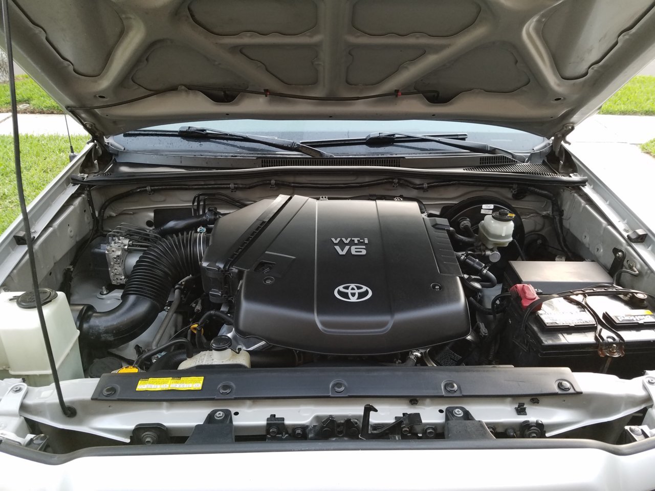

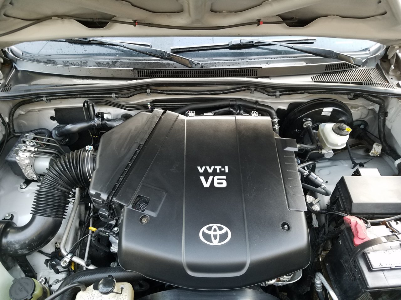

    I use a degreaser on the engine when it's cool. Brush stubborn spots with a bristle brush then rinse , i use 303 protectant on the hoses and plastic parts after degreasing.
