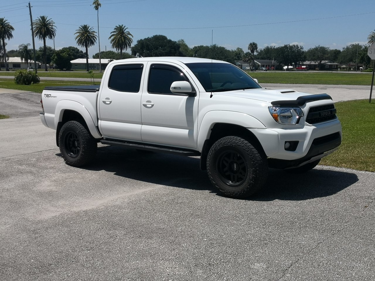

    i used KLASSE AIO and also ZAINO's version of AIO on my white truck it does help clean up the white and give it a little more pop, it works very well on black plastic,glass pieces that get faded by the weather/sun and brings them back to almost new looking.

    Klasse AIO

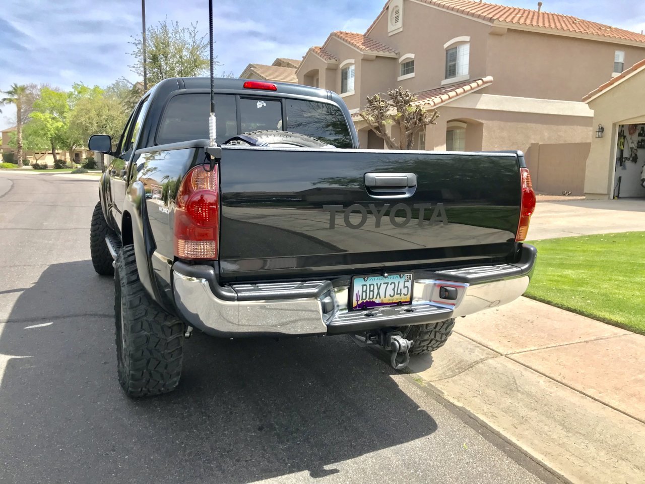

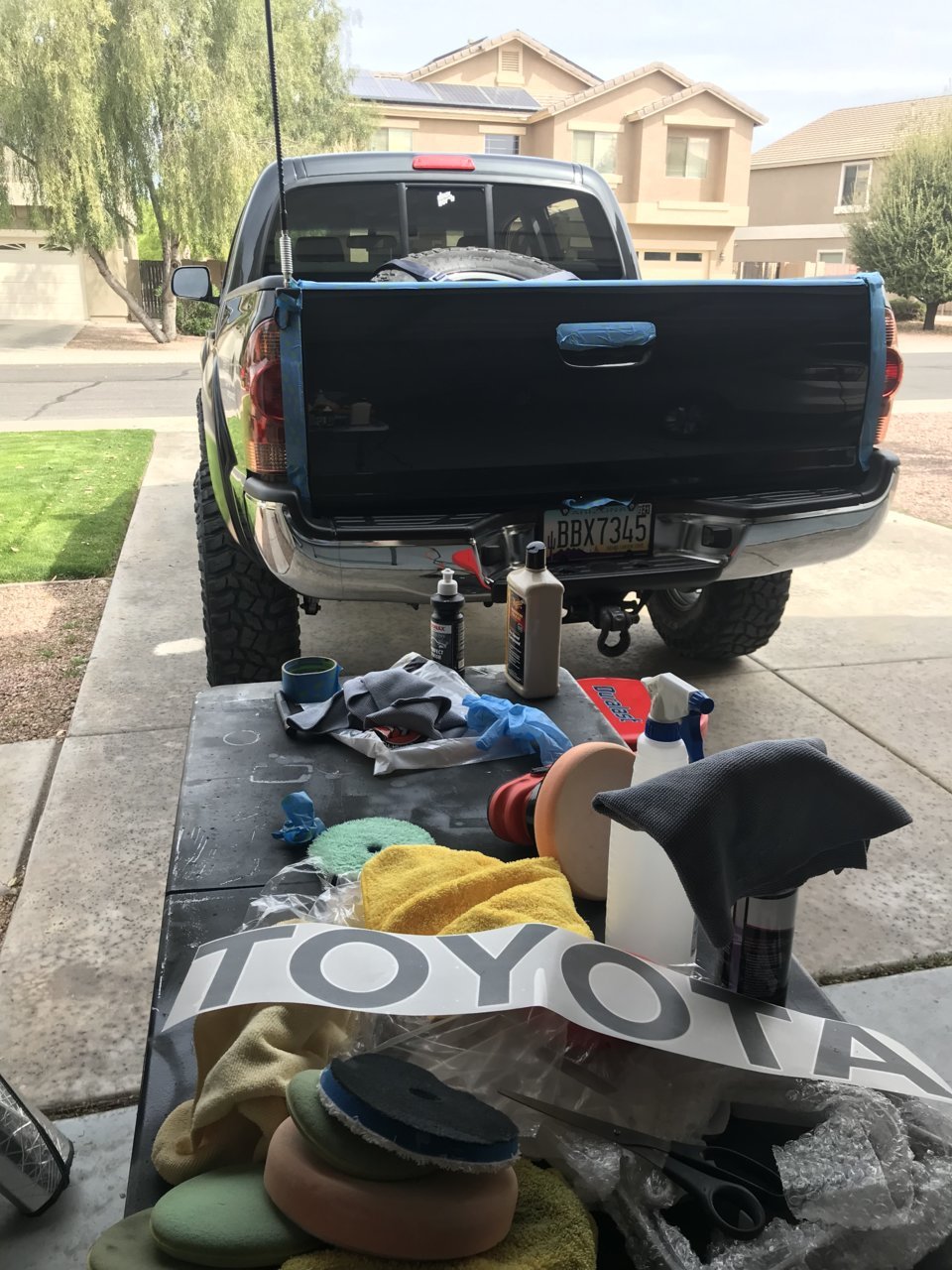

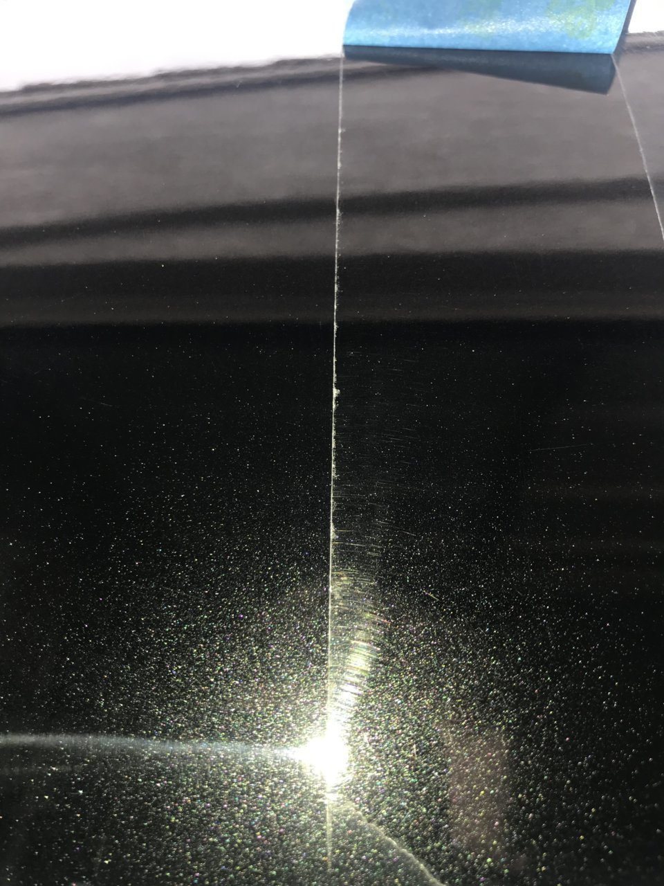

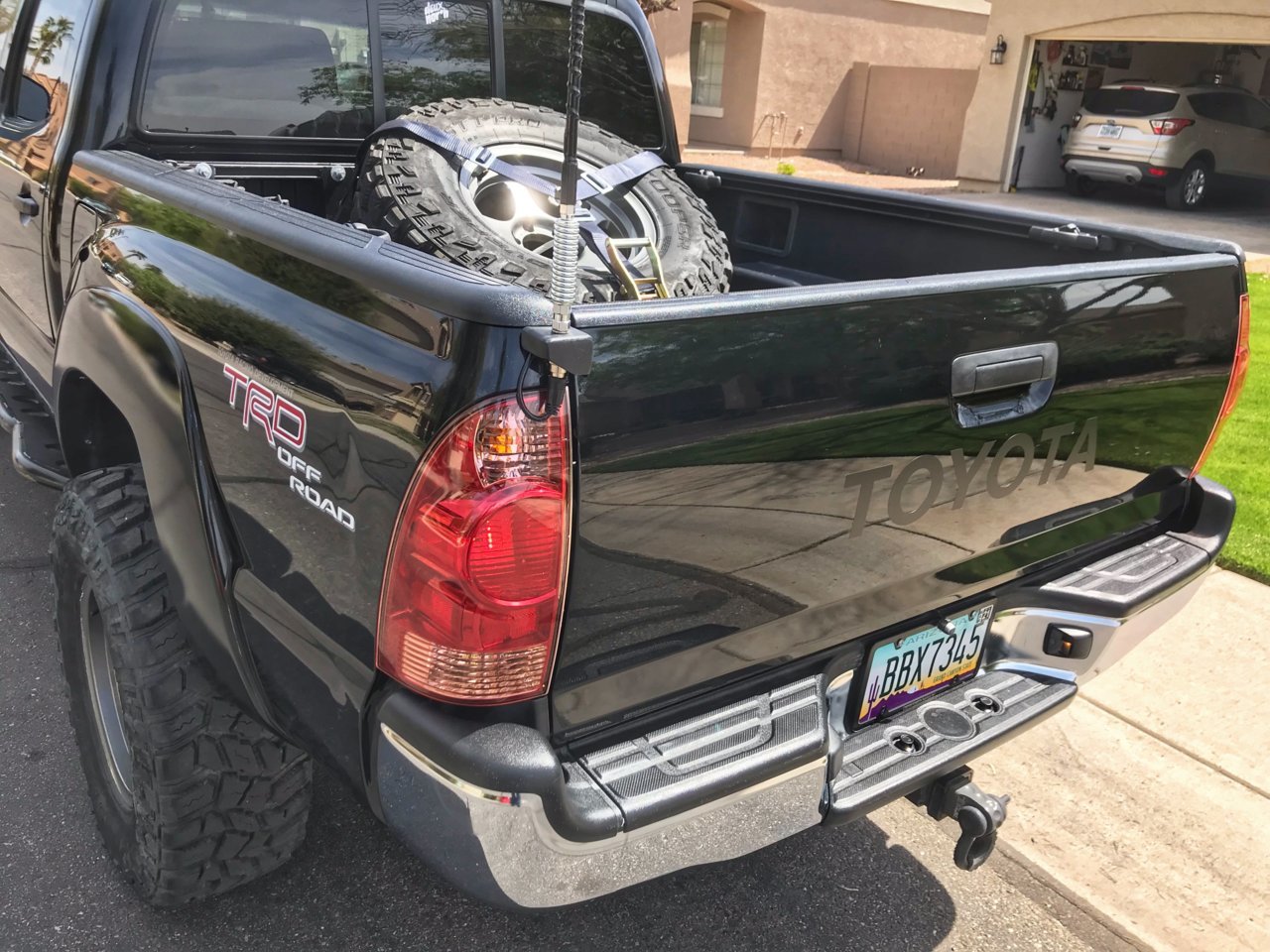

    Not here to ask questions, just want to show off my only corrected painted surface on the truck ( my tailgate ). The rest is covered in trail AZ pinstripes *sigh*. I did this after debadging the 11yr old chrome badges and prior to applying a black T O Y O T A decal. 2 compound passes with MF cutting pad and two passes with a yellow foam polishing pad. Came out great.

    You did this by hand or with a machine?

    How did you know which foam pads to use?
    Tailgate looks nice!

    Machine. Harbor Freight polisher orange pad. Picture doesn't do it justice.

    I just used a finishing foam pad on my griots DA polisher with some Jescar perfect finish. It worked great

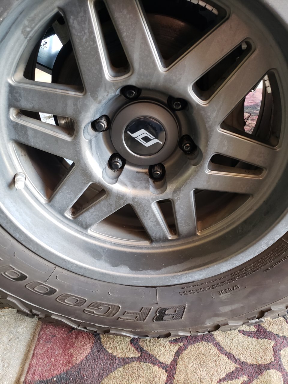

    I tried cleaning my wheels and tires with mothers tire and wheel cleaner. This was the outcome. Any suggestion on how to fix this?20190505_130036.jpg

    Looks like the chemical dried on the wheel. I would wash again with regular car soap.

    Soap and water. Leaf blower to dry.
