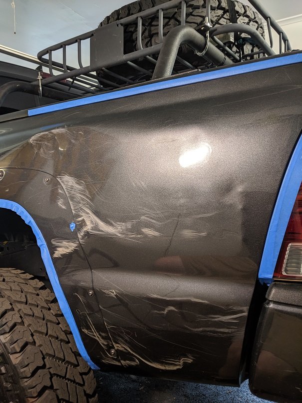

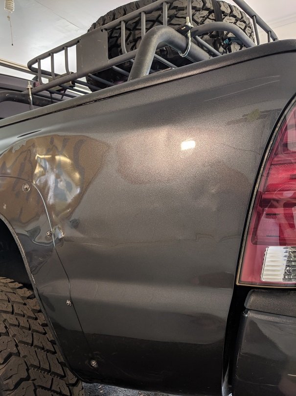

    Here is an ask... with a pic for attention.
    Going to be looking at ceramic coatings soon after I do my full detail on the truck. Any recommendations that would be good for Texas summers?
    This was what I finished up yesterday on my truck correcting an incident I had with a tree a while ago... hand wash, clay bar, then meguiar's 105 cut compound and 205 polish on the torqx DA polisher with hex pads, followed up by hand applied wax and a hand buff.
