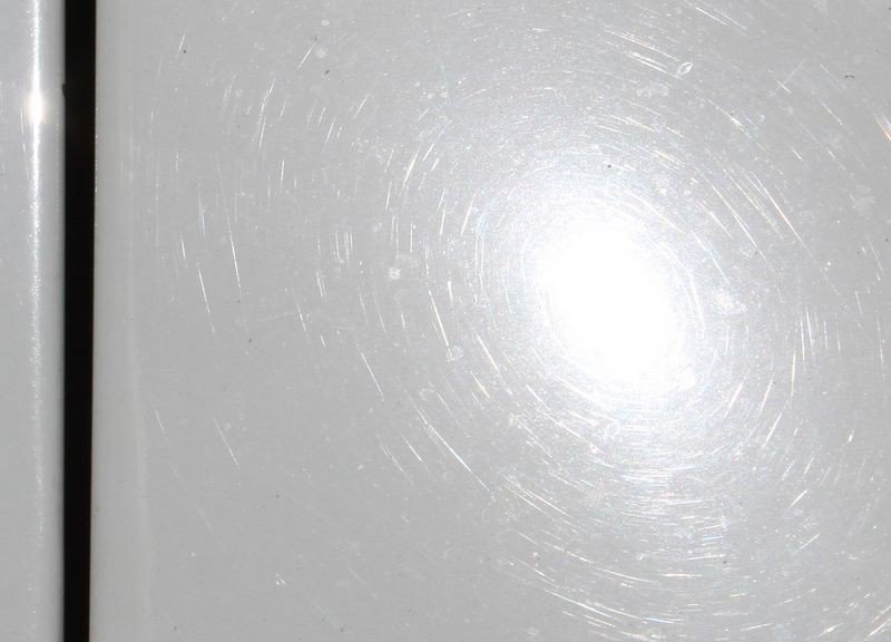

    Best swirl remover please and thank you.
  14. Jan 1, 2020 at 8:25 PM
    #4014
    pudge151
    pudge151 Well-Known Member
    Apr 4, 2010
    #34558
    4,066
    Sean
    Connecticut
    2015 Tundra Platinum
    By hand or machine? How bad are the swirls? What color truck? Some details would be helpful. Swirls mean different things to different people
  15. Jan 2, 2020 at 2:29 AM
    #4015
    bigfoote13
    bigfoote13 Well-Known Member
    Aug 5, 2015
    #161099
    5,380
    Joe
    South Florida
    15 TRD SPORT
    2016 Sport suspension 1/2 spacer up front and aal in rear SCS Stealth 6 17 inch wheels Wildpeak AT3 265 70 17
  16. Jan 2, 2020 at 6:30 AM
    #4016
    pudge151
    Apr 4, 2010
    #34558
    4,066
    Sean
    Connecticut
    I would try carpro essence or griots BOSS perfecting creme with a lake country black pad first. If that doesnt do it then an orange pad using those same products.
    If you need more correcting power then try carpro clear cut or griots BOSS correcting creme on a orange pad and if more correcting is needed go with a more aggressive pad like a microfiber cutting pad or a yellow foam pad from lake country.
    The idea is to use the least aggressive pad and polish as possible that will get the job done.
    Be aware that if you already have pads and they are a different brand then the colors vs correcting power may be different feel lake country so check your pad manufacturer.
    Also you will need 5 to 10+ pads to do the whole truck.
    You need to wash and decontaminate before you polish. After a good wash, make sure you use some kind of iron remover spray and then do a full clay treatment. The clay can be real or synthetic clay mitt or towel.
    What kind of polisher, pads, and compound or polish do you have?
    ace96 likes this.
