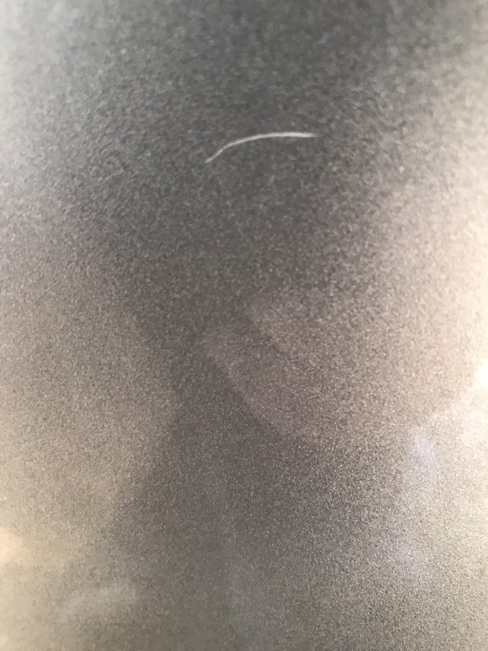

    Best way to fix? Or will it cause further problems unfixed? Got a little close to a branch. I can barely feel it with fingernail, hard to tell in pic but it’s white.

    The white is likely the scaring of the clear coat so not uncommon. To get rid of the scratch you're essentially leveling the area around it which is why you should never go too far in trying to get rid of scratches that are deep. Minimal polishing will likely get rid of the white and will make the scratch blend in so that most people won't notice it or you'll have to catch the light at just the right angle to be able to see it. You'll likely not have any issues since it doesn't sound like it's that deep. If you're not inclined to grab a polisher and do the whole truck eventually then something like Meguair's ScratchX on a foam applicator or microfiber rag should do the trick.
