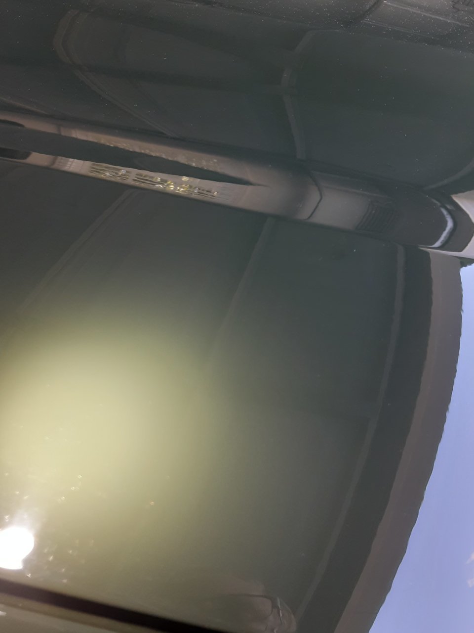

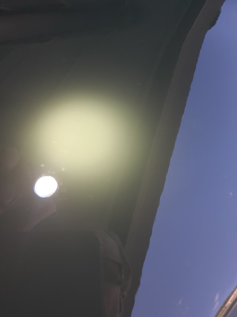

    Need some advice or help here. I have a 2020 Army Green Tacoma about 2 months old. There seems to be some paint contamination I'm unfamiliar with. I just came out of my 2nd Gen (Silver) wich I had for 8 years. The truck looked as good as the day I bought it. Thanks to a foam cannon, 2 bucket method of washing and Meguiars Synthetic X-press Spray Wax. My 2020 seems to have something like small particles embedded in the paint. And when I wash the the truck as mentioned above. Then dry it with microfiber towels the contamination seems to pull very fine lint off the towels that stick to the truck.
    I'm unsure if this is rail dust or something else. Or what to do about it. Should I clay bar, use an iron remover? Or get a da polisher and polish out the truck?. Or is there another solution ? Attached are a couple of pics. It hard to see but if you look closely you can see the particles. As a side note. 90% of people would probably never see this but I do. And it's driving me nuts. Thanks for any help.

    The giveaway that you need to clay is when the truck is clean and you slip a sandwich bag over your hand and glide it across the paint. If you feel bumps everywhere then you should probably clay the truck. Regarding iron, even a brand new truck could have iron contamination depending on the environment it's been in. If it's on the interstate enough it'll eventually pickup enough to warrant using an iron remover. Both steps would be a wise move before polishing as it's better your polishing pad not pick up these contaminants and thrash them all over your paint. Besides the clay step WILL mar the clear coat up enough to warrant polishing afterwards.
    Post polishing would be a good time to lay down a coating or a sealant at the vert least. If you're not up for a full on coating at least look into Carpro Cquartz Lite or Gyeon Can Coat.

    ^^^^ Absolutely true! Many folks - when they first discover clay or Nanoskin mitts - think they can simply clay every week because it makes the paint feel so good. Remember, all of those contaminates that you're removing from the paint surface get rolled / scuffed around against the paint surface for at least a bit before becoming imbedded in the clay. As the old saying goes, "That's gonna to leave a mark."
    Getting back to the OP's question, I'd start with Iron-X or some other product that dissolves iron surface contaminates first. I'll take "dissolving" over "dragging across a surface" any day of the week. Then, if you still need it - which you probably will - go for the clay.

    Iron removal and clay bar is pretty easy. Just don’t let the iron remover dry on the paint. Some of them are fine to do so, but just watch out on any black trim as sometimes they can stain if they dry on it. Only use the claybar where you absolutely need to.

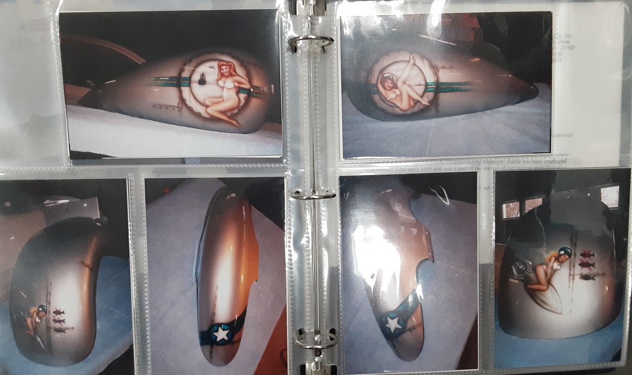

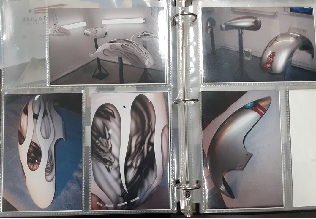

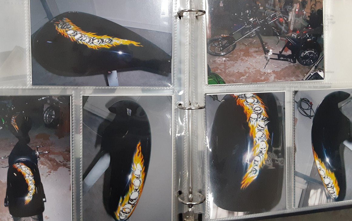

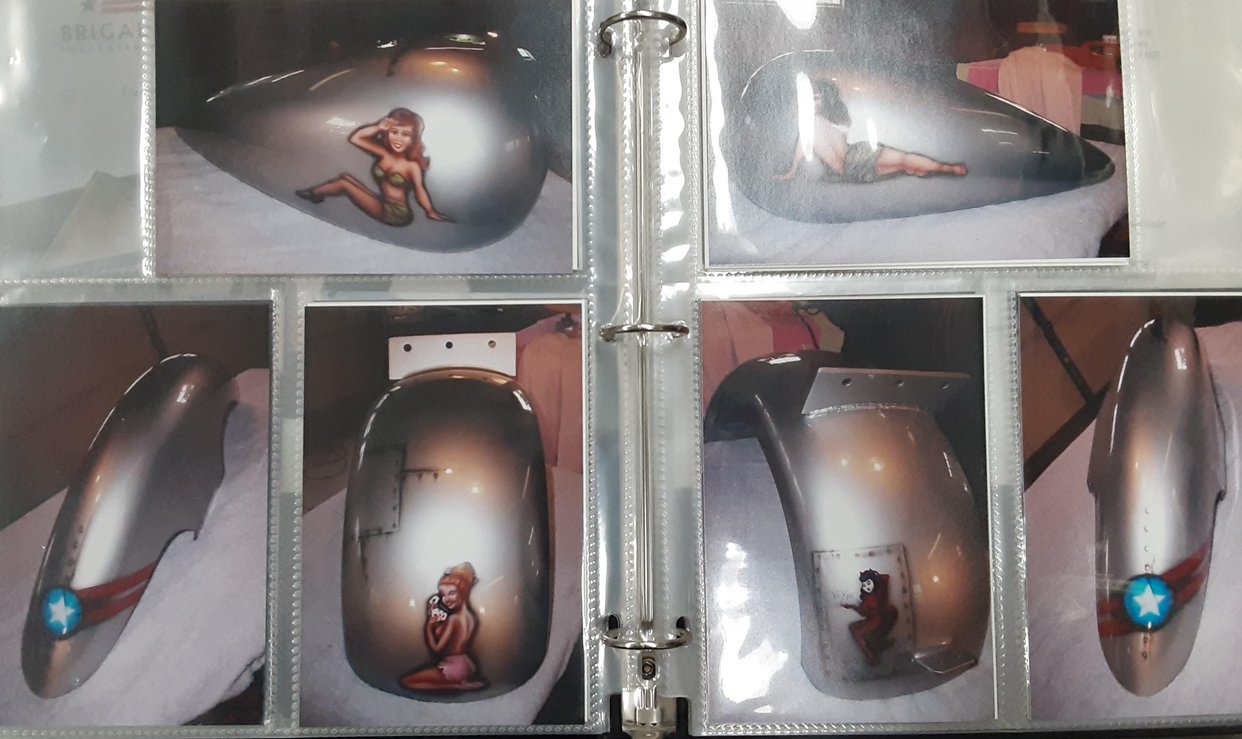

    Thanks. Wet sanding and buffing a un-stationary object can be a little more tricky than say a car or truck. Below are a few pics of some of the tins I painted a few years back. Back in the days before phone cameras. I would pick up the raw tins, grind down and finish the welds. Undercoat and then apply an epoxy primer. Sand and guide coat the primer then base coat the color. A pretty little gal working her way through medical school would then pick them up and do the artwork. She would then drop them back off at my place where I would add about 3 coats of DuPont clear. Then wet sand, buff them out, then deliver them to the custom bike shop. I did this in my garage, self taught just as a hobby for about 2 years.
