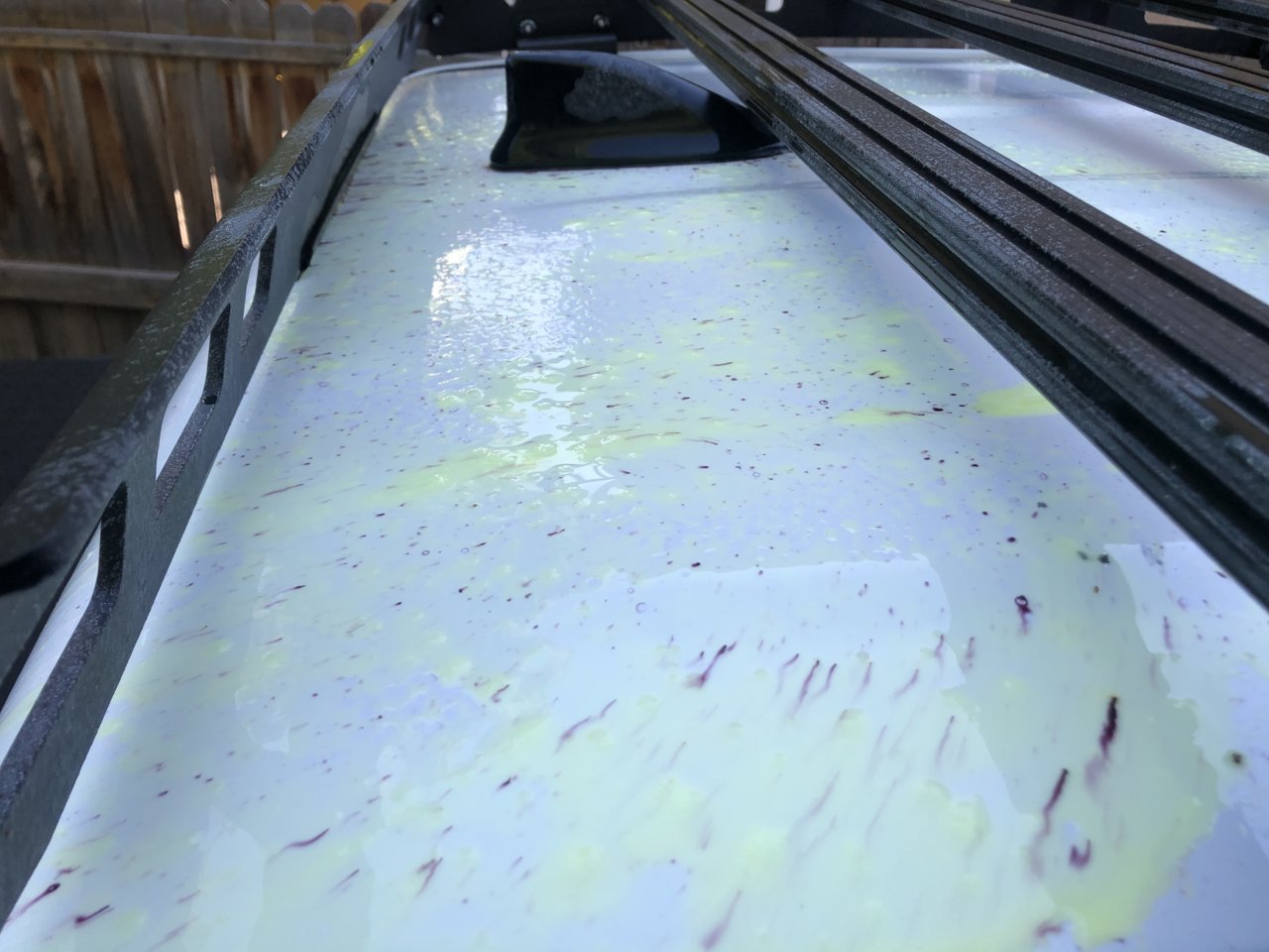

    That Iron FREE stuff did some pretty nice work. I had a few metal particles that were really deep in there that it wasn’t able to get out with just one treatment, but it got rid of the bulk for the most part. I took a clay bar to the rest of the crap and came out with a mirror finish (truck is only 1 year old). I tried out meg’s hybrid ceramic wax just to hold me over until I get a new DA polisher and think it’s pretty good stuff in a pinch!

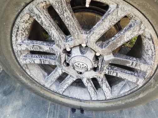

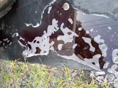

    So after reading about the car pro iron x , tried it on my rims . :eek: Holy shit . Need to do whole truck next . Thanks for advice.
