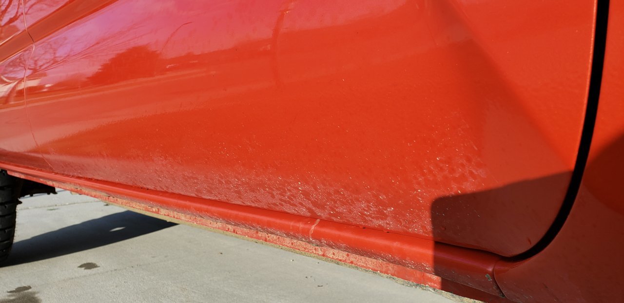

    Here's my problem. This panel is clean, the "dirt" you see is essentially etched clearcoat from dirt/dings. You can wet it and it looks better (until it dries to this).
    The dings/chips aren't my concern. I'd like to restore it so it doesn't look constantly dull/dirty.
    It was professionally detailed and they said there wasn't anything they could do to it (besides maybe taking it to an auto body shop and "wiping" paint on it???). After some chats around the forum, I was told I could try cleaner wax (still might?). Then I was looking into Gtechniq C1 as a possibility to restore some "gloss".
    Any suggestions are greatly appreciated!!

    Wiping paint on it may refer to a technique of getting paint into the rock chips. The brand Dr. Colorchip demonstrates this method for getting the paint into a chip by dropping a dab of paint beside the ding and you smear it into the chip.
    If the detailer did have some experience and they didn't touch it with a polish or compound I doubt a cleaner wax would help much. Cleaner waxes usually have minimal abrasives (comparable to a finer polish) that help clear up minor scratches while working it by machine or hand ultimately laying down a layer of wax or sealant. A newer name for this type of product is an "all in one". If you're going to do a coating such as Gtechniq you'll want to apply that to the cleanest barest paint you can, not paint that's been waxed already as it will make it harder for the coating to bond.
    Now if the detailer was inexperienced and for some reason doesn't have a polisher or doesn't use abrasives then have someone take another look. Are you anywhere near Boise? Look into The Rag Company as they should be able to help with suggestions and if you're dead set on Gtechniq they're a distributor for them. I'm not that familiar with the Gtechniq lineup which is certainly a reputable coating brand, they may have a better suggestion on which of their coatings or maybe a spray to use for your issue.

    I detail vehicles for a living at a Toyota dealership, so I've seen more than a few Tacomas with exactly the issue you have. The worst ones are the ones without mud guards and / or tube steps or running boards because either of those helps minimize kicked up stones from hitting your lower door panels and rockers. You might also notice that the lower 8" or so of that area has a "textured" look to it. That's because the paint there has a chip guard layer to help minimize exactly the condition you have.
    So what's happening is stones get kicked up by the front tires and impact against the paint causing chips. It's important to understand this because whatever you do to "fix" the current problem will be pretty much a waste of time unless you do something to prevent the damage in the future. Like I mentioned above, prevention is the key. I installed OEM running boards on my truck when it was new. This picture was taken when the truck had just over 100,000 miles on it and there's not a single chip in that area.
    As for what you can do, I can tell you for certain - based on personal experience at work - that cleaner wax won't do anything. In fact polishing / buffing will also have almost no effect. The paint in that area is thick due to the chip guard and when you chip it, it's a very deep chip. Basically, without repainting it, you're stuck with an unsightly mess.
    The is some hope though. Many higher quality ceramic coatings - not the spray on crap from Walmart - do have some limited filling ability. Several layers of one of these coatings applied by somebody who knows what they're doing will minimize the chips somewhat. But as I mentioned above, if you don't do something to prevent future damage ...

    It is a lease vehicle with 65k miles on it (that I just purchased 2 weeks ago). Unfortunately, whoever leased it didn't have mudflaps and well.. here I am trying to fix it.
    Mud flaps are on my list (not a huge fan of running boards, but maybe in the future!)
    The major chips aren't my main concern, but returning the finish to a wet look rather than the dull dirty look it currently has. If I could find a "spot" treatment that would be ideal, as I'd like to not have to ceramic coat the whole truck.

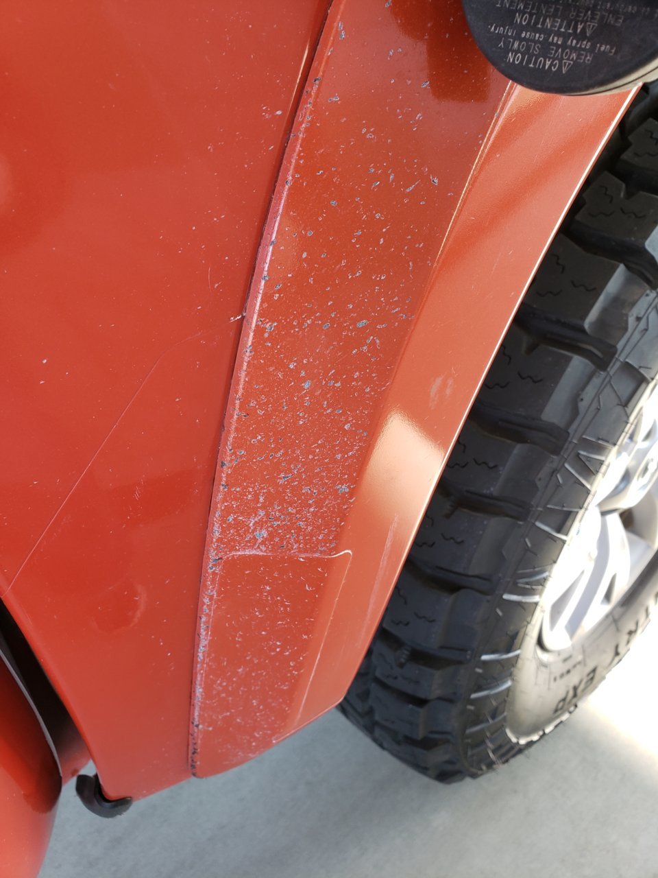

    Here's the rear fender flares :angrygirl: which are on my list of things to either vinyl wrap (temporarily) or replace.

    Wow, that's going to require paint - even if you want to wrap it. That's because the surface is too rough to wrap.

    Yeah I don't have much experience with wrapping so I wasn't sure if that was doable.
    Are the OEM flares pretty easy to remove & reinstall? Maybe I will plasti-dip them for the time being. Anything is better than the hideous rock damage.

    Yikes, I have never seen paint that trashed with chips. I would assume those flares are like 2nd gen and kept on with plastic clips. Given the condition of the rest of the truck minus the lower door portion, I would buy new flares. You could probably find them online already painted to match your truck.

    I actually don't like the color matched flares and am hoping to get black ones. Thankfully that's probably easier than finding paint matched.
    It is super unfortunate how trashed the paint is, it was actually at a dealer 300 miles away and the damage wasn't disclosed to me before making the 5 hour trek to buy it. It is what it is!

    Maybe look into using rattle can bedliner for flares for now since you want it black. Should hide those chips. Search on here . Theres people who bedlined theres .
