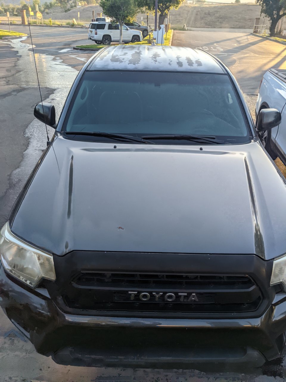

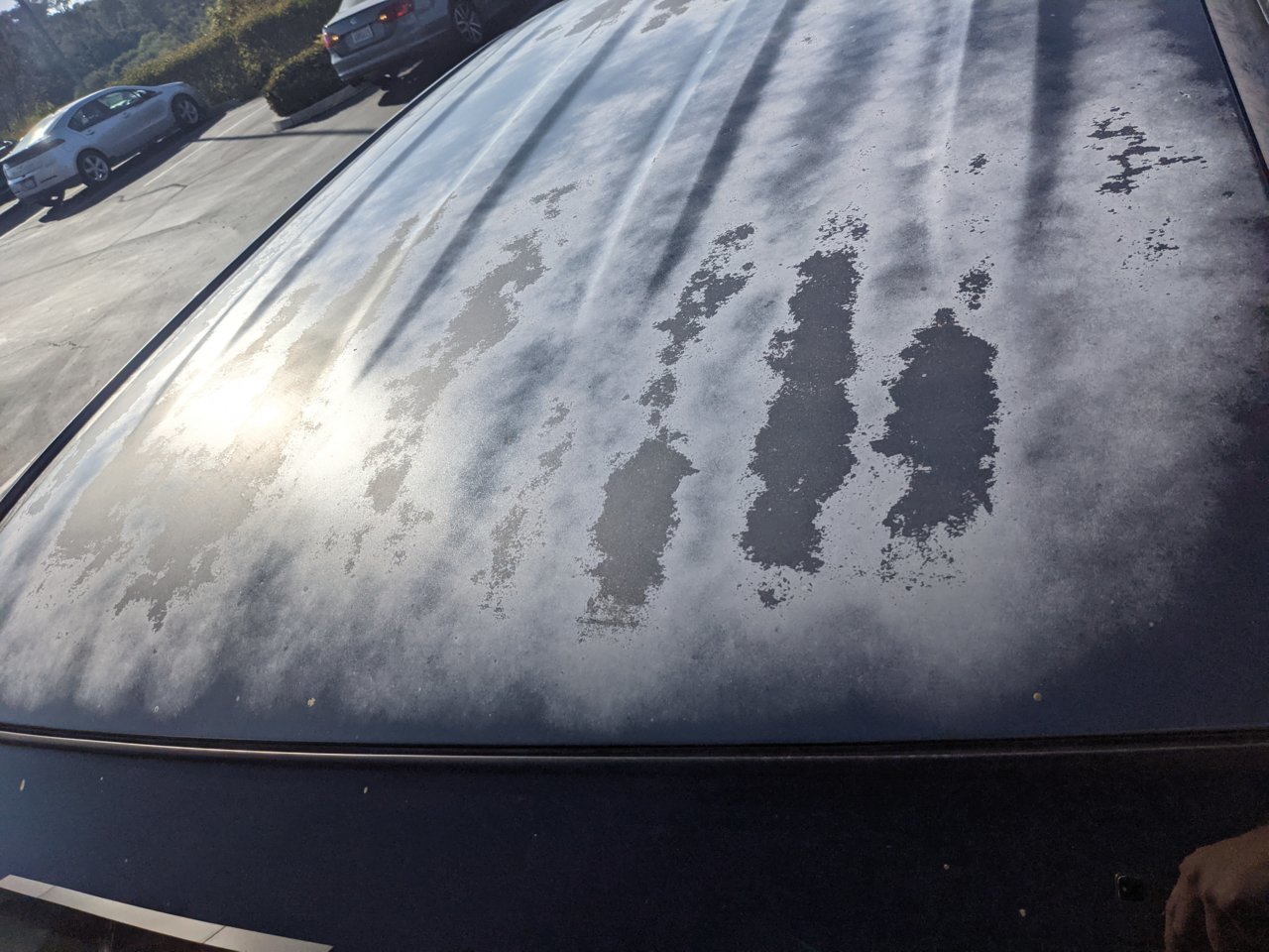

    Hi guys, how far gone is the paint and clear coat on my 2015 DCSB MGM truck? I don't know anything about base coats, clear coats, etc. so that's why I'm asking here! Any advice would help ease my pain.
    Background:
    • Socal
    • Got the truck 2.5 years agowith 30K miles. I have 90K miles on it now, mostly from 120 miles round trip to work.
    • Wash every 2 - 3 weeks with either Meguiars car wash soap, or Optimum No rinse depending on how dirty. Finish off with Meguiar's ultimate quik detailer spray.
    • Wax every 1.5 - 3 months with Meguiar's ultimate liquid wax
    • Really started going down hill right before Covid. During and after Covid looks like below.
    What are my options??
    • Is paint/clear coat too far gone? Needs repaint and no other solutions?
    • Can i just sand down or compound some spots and re-spray with clear coat and be ok?

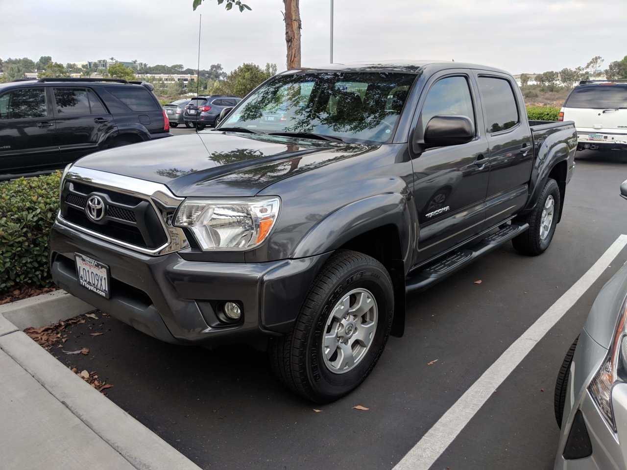

    New (January 2019)

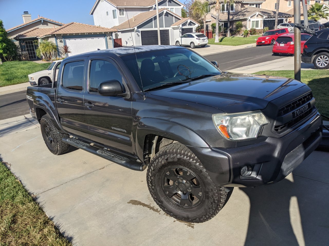

    Last week:

    I hate to be the bearer of bad news, but the roof is toast and will need a re-paint. The clearcoat is totally done for.

    Yep. Thanks.
    Also, it's not just the roof. It's the door sill and a very tiny part of the hood.
    Any idea how to stop the spread on the other panels until I can repaint?

    Grab something like Turtle Wax Seal and Shine. Not my favorite product, but it’s cheap, can take a beating, and will add some UV protection. Apply it every 2-3 months.
    Best thing you can do is protect the paint from UV light. My guess is your wax broke down too much in between applications. No excuse for cheap paint (blaming Toyota), but that’s my suspicion.

    As has already been said, frequent coats of a wax or sealant with decent UV inhibitors will certainly slow it down, but unfortunately you cannot reverse the process. A good car cover will go a long ways towards slowing it down too.
