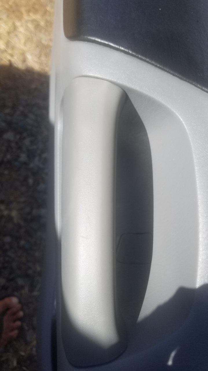

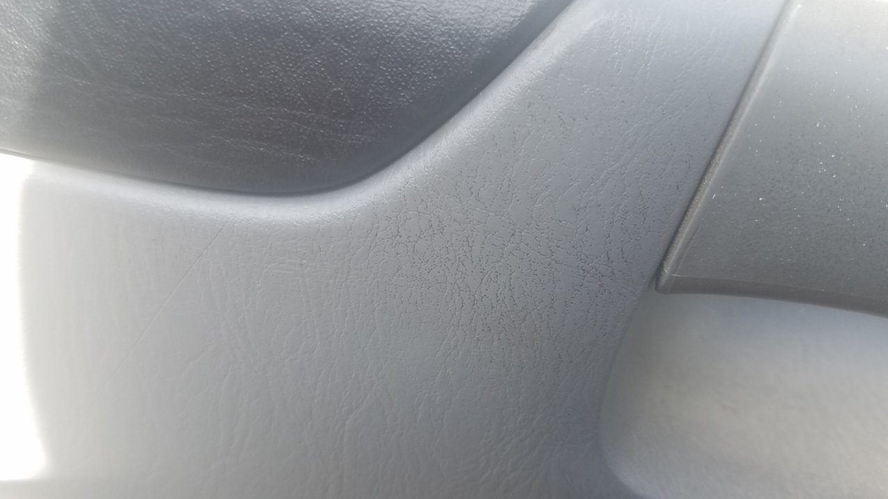

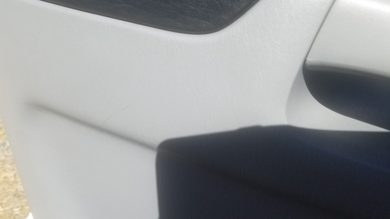

    The interior area of the door on my Tacoma has a somewhat smooth vinyl area and then a roughened area that seems more difficult to clean. Any suggestions?

    I have had luck with tub o towels wipes . Cleans fine " ridges ? " pretty good. Just need to keep rubbing . My grab handles were dirty and only tub o towels worked for me .

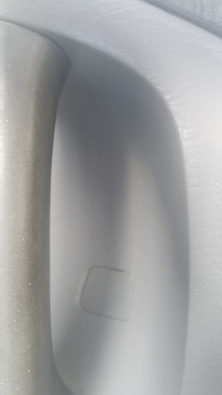

    The small area were dirt in cracks was a bigger area . Thats the spot I missed awhile ago :( . Just cleaned those spots today so can see how the tub o towels work

    Detail brushes are perfect for cleaning those textured areas. Detail factory makes some decent brushes; for door panels/harder plastics, I'd go with their Boar's Hair brush. Spray some diluted APC (5:1 should be plenty) on the spots you want to clean, let it soak for 15-30 seconds, and then use the brush to clean the area (small circular movements work well). Wipe clean with a microfiber towel when done.

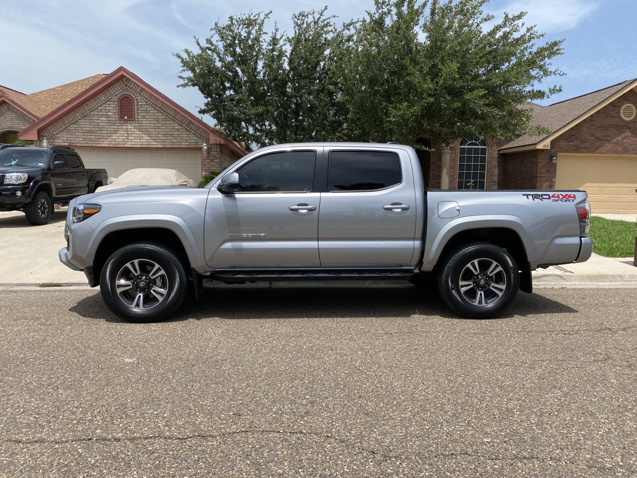

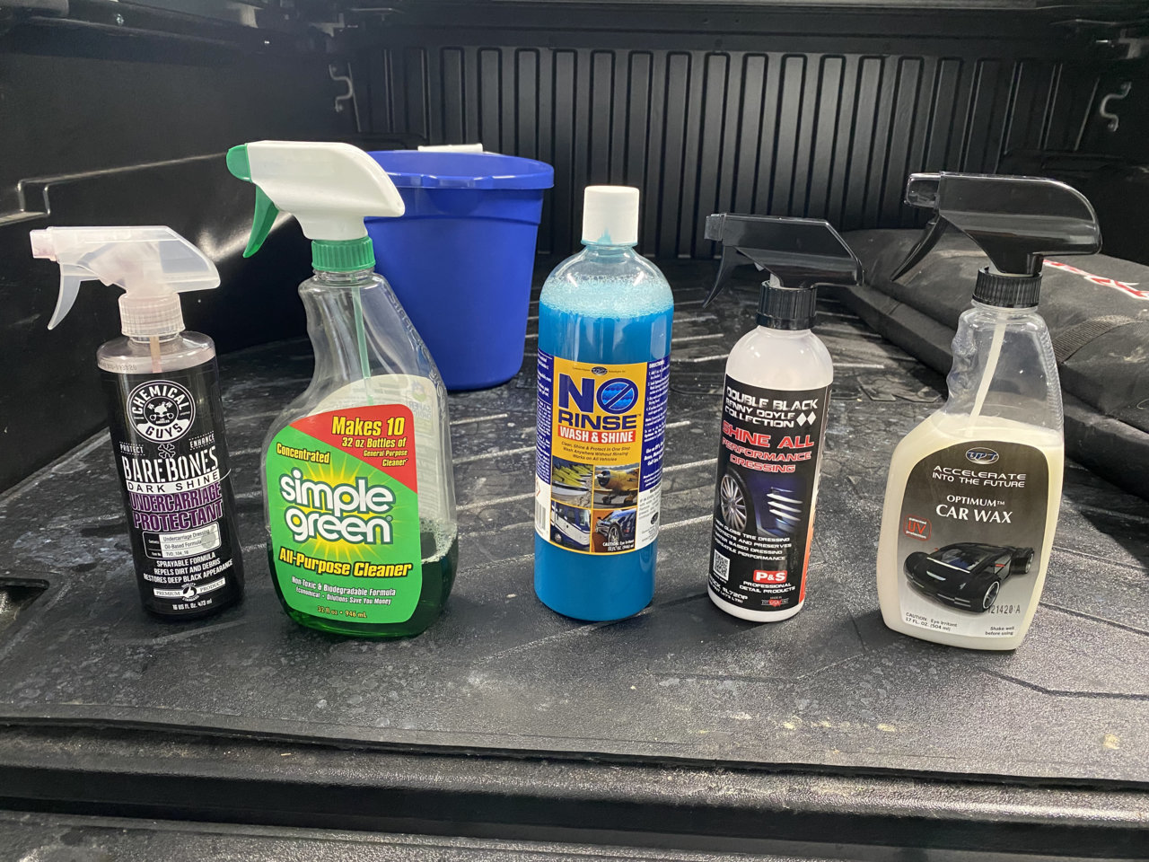

    This lineup here works wonders…
    Simple green- removes grime from tires, fender liners, and removes bugs
    OPT No Rinse- pair with distilled water to clean the entire truck
    P&S Double Black- shine your tires and black plastic
    Chemical Guys Bare Bones- shine your frame and fender liners
    OPT Spray Wax- give your paint a coat of shine and protection
    Finished product:

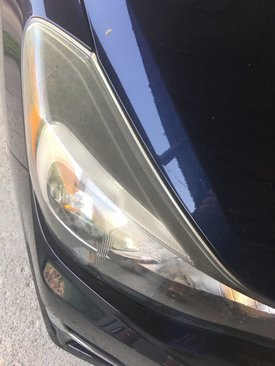

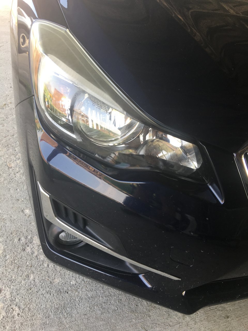

    Probably been answered in this thread already but I’ve got headlights on a 2015 Subaru Impreza that are fogged up on the top side only. Any suggestions on how to make them look new again?

    The clear coat is failing on the top that gets the most sun exposure. They can be worked through various grades of wet sanding, compound and or polish and looking better than new. Not particularly cheap for a one off fix to buy all that kit. There should be a few different kits you can get at auto parts stores which either fit your situation or not and you get a finite amount of sand paper.
