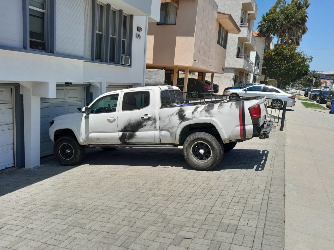

    How would a detailer address this issue. My truck was vandalized with spray paint.

    Start with a wash and clay on the area. Then would move up to a machine polish then compound if needed.
    General rule is start with least aggressive method first.

    It should come off if that’s what you’re wondering. Just don’t wait too long. I had a customer who ran over a bottle of orange spray paint in her white GMC Yukon and she didn’t notice it for ever a week. Took 15 hours to get it all off
    Be careful and try not to burn through the clear coat

    There is no clear coat on "super white":rolleyes:

    bruh I had no idea it was a single stage paint

    Clay bar wont remove that paint. Use the aerosol version of either Goo Gone of Good Off. Spray it on a rag and simple wipe the paint off. Be careful around any decals or plastic/rubber items. The spray will etch those areas. No sense in working your ass of trying to claybar and polish something if it's not gonna work. It looks like there's only a little on that back decal so maybe you could try the clay bar on that. Otherwise you'll have to replace it. Make sure and wash the truck when you are done though. Both products are supposedly safe for bonded paint so it shouldn't be a problem if you don't wash it....but I would. Why take a chance? I did this one cars during the whole 12 years of having a detailing business. Good luckl!!
