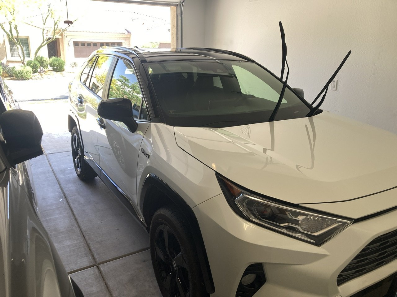

    I used Rupes white pads with Sonax perfect finish for a mild correction last time. I have some Jescar correcting compound too, but haven't used it. Either of those with a combination of Rupes pads should get you good results. Not all vehicles are 100% correctable and some clear defects are better left alone.

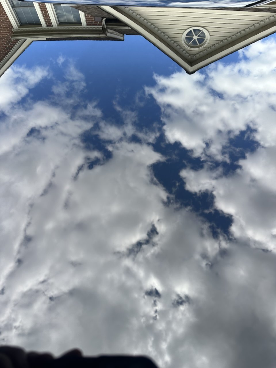

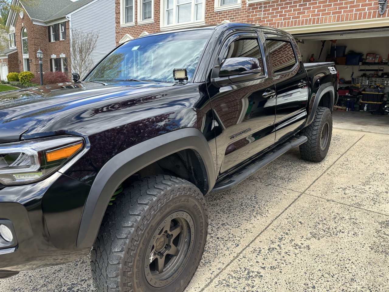

    I ended up staying with the Adams and I think she turned out pretty good as a DIY project. I took my time with a few different pads. Rupes orange for most of the truck. A few I used a different brand heavier cut in some areas then followed up with the rupes again. Not perfect but I took my time and am pretty happy with the results. I had to apply the ceramic in my garage as outside was too sunny getting hot and even the clay spray and polish was trying to flash off while using it.
    I had a tough time with seeing the ceramic flash and bead up. Not sure if I needed to let it sit longer to see it better but I can see that the truck is covered with the UV light, so that was pretty neat. You can also see how it looks streaked with the UV light… shhh
    Pictures were a day after I applied.

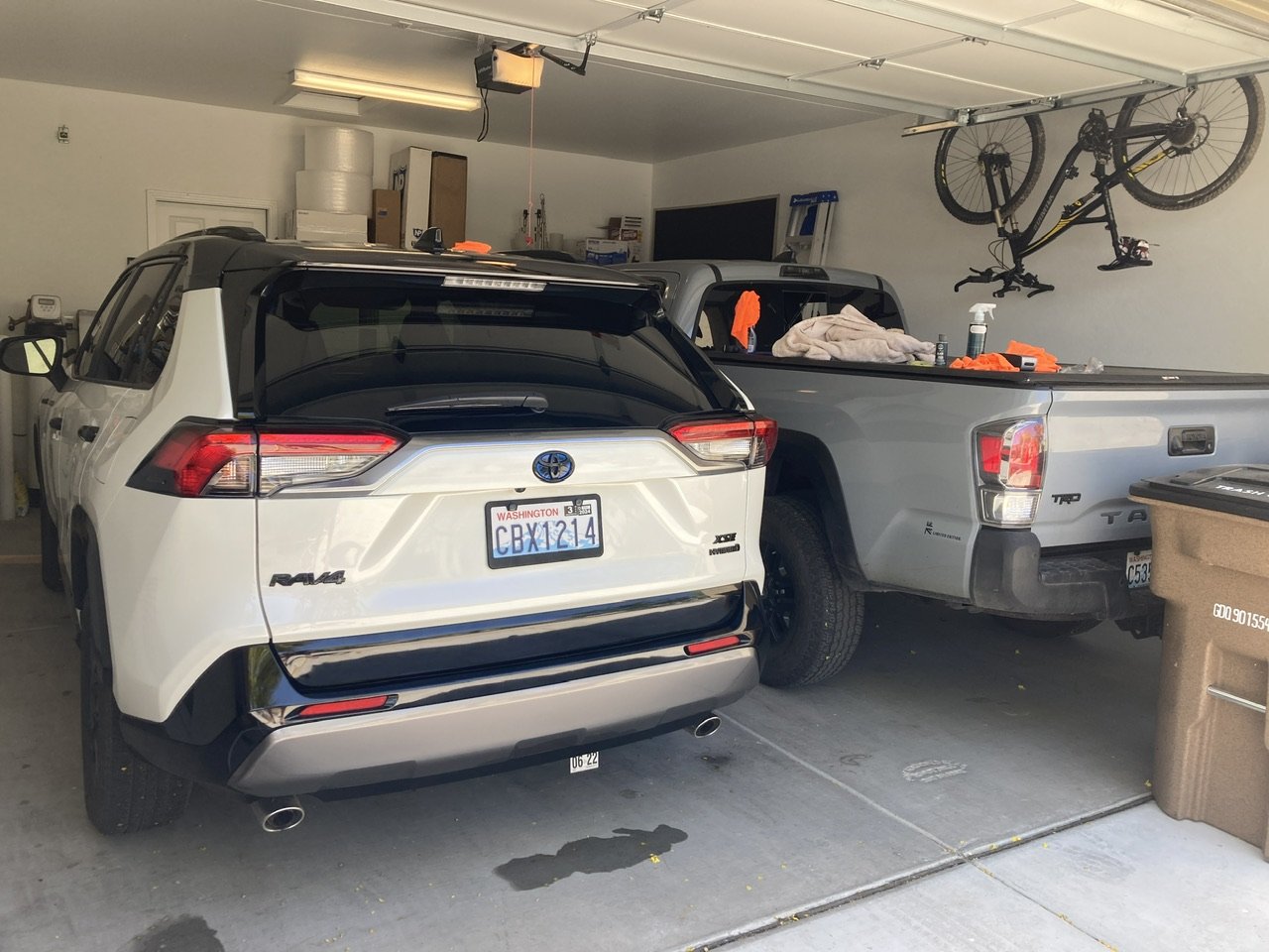

    So… surface cleanse, clay bar, first ceramic coat done on the wife’s car. The paint feels awesome, can’t wait to do my truck tomorrow and will do a second coat of the hybrid ceramic coat and then wax hers.
    Sadly upon close inspection of the car it looks like someone wheel span away from a gravel parking lot and sprayed stones all over the back of the car, lots of very minor stone chips… assholes!
    EDIT: Also got the inside and glass still to do so half way there, waiting on supplies to be delivered.
