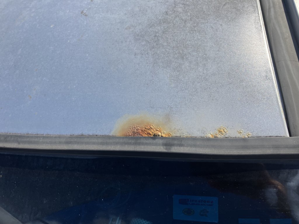

    Any good ideas on easy solutions for this? An ‘06 DCSB w fairly rusty frame but nice interior and strong v6 that’s mostly a beach truck. Hood, roof and flares are all pretty baked. Just looking for ideas on sealing this from water intrusion and rust growth. Doesn’t have to look nice.

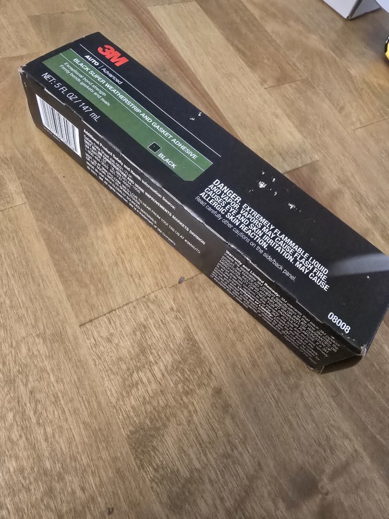

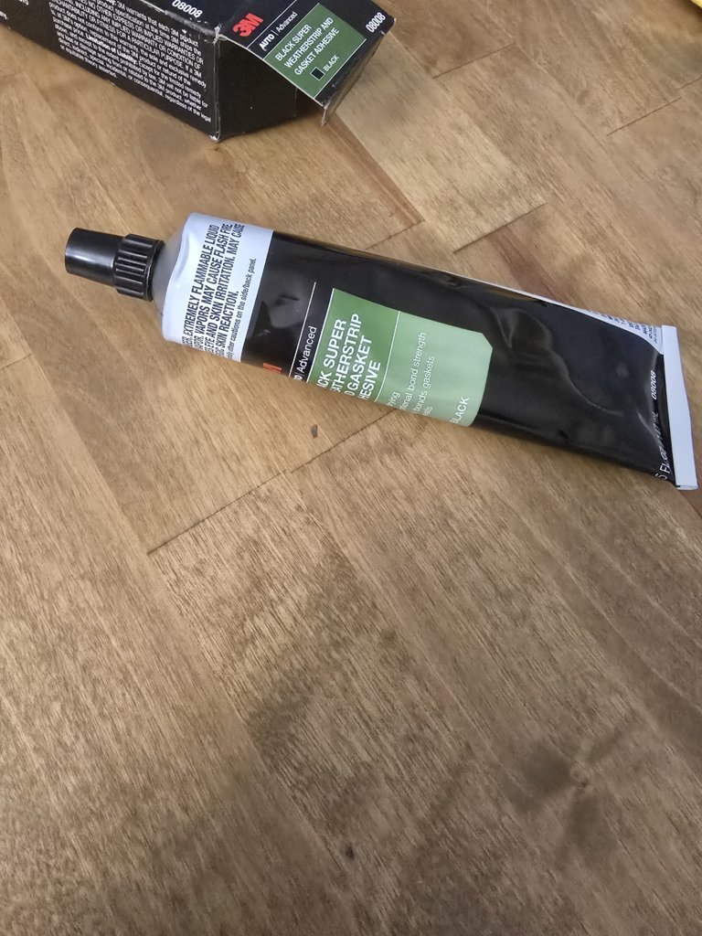

    3m weatherstrip adhesive?

    That's the one. Bead it under the weather stripping and give it time to cure.

    Stuff is hella-strong. Really, it's too strong. Lol.
