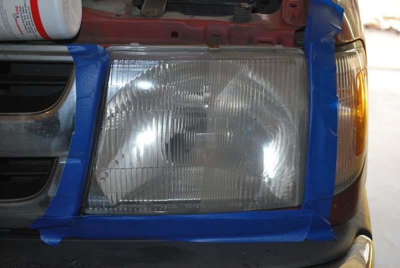

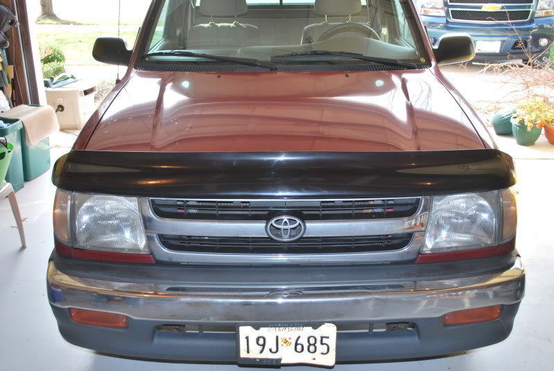

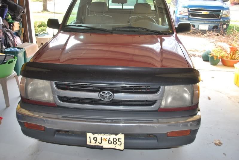

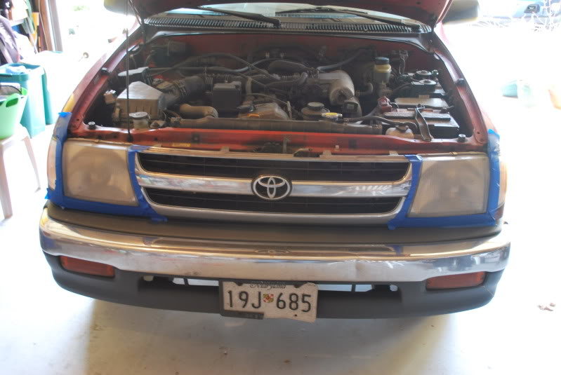

    what about the lights?what can i do 4 the faded yellow stuff on them

    Hit them with a buffer and a mild polishing compound.
    here is some work I did on my Nephews Tacoma.
    Before
    Taped up so not to wreck the paint or chrome.
    Half and half shot
    Finshed results.
    He was pleased with the outcome.

    to 95sle...thanks they look really goood
